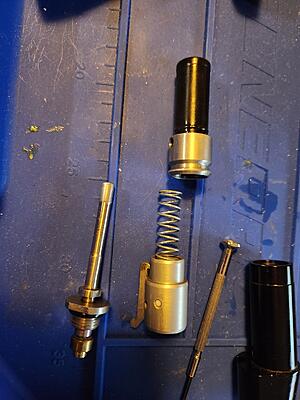

        • 4408
        Socalpumpballer
        All of mine have these internals.

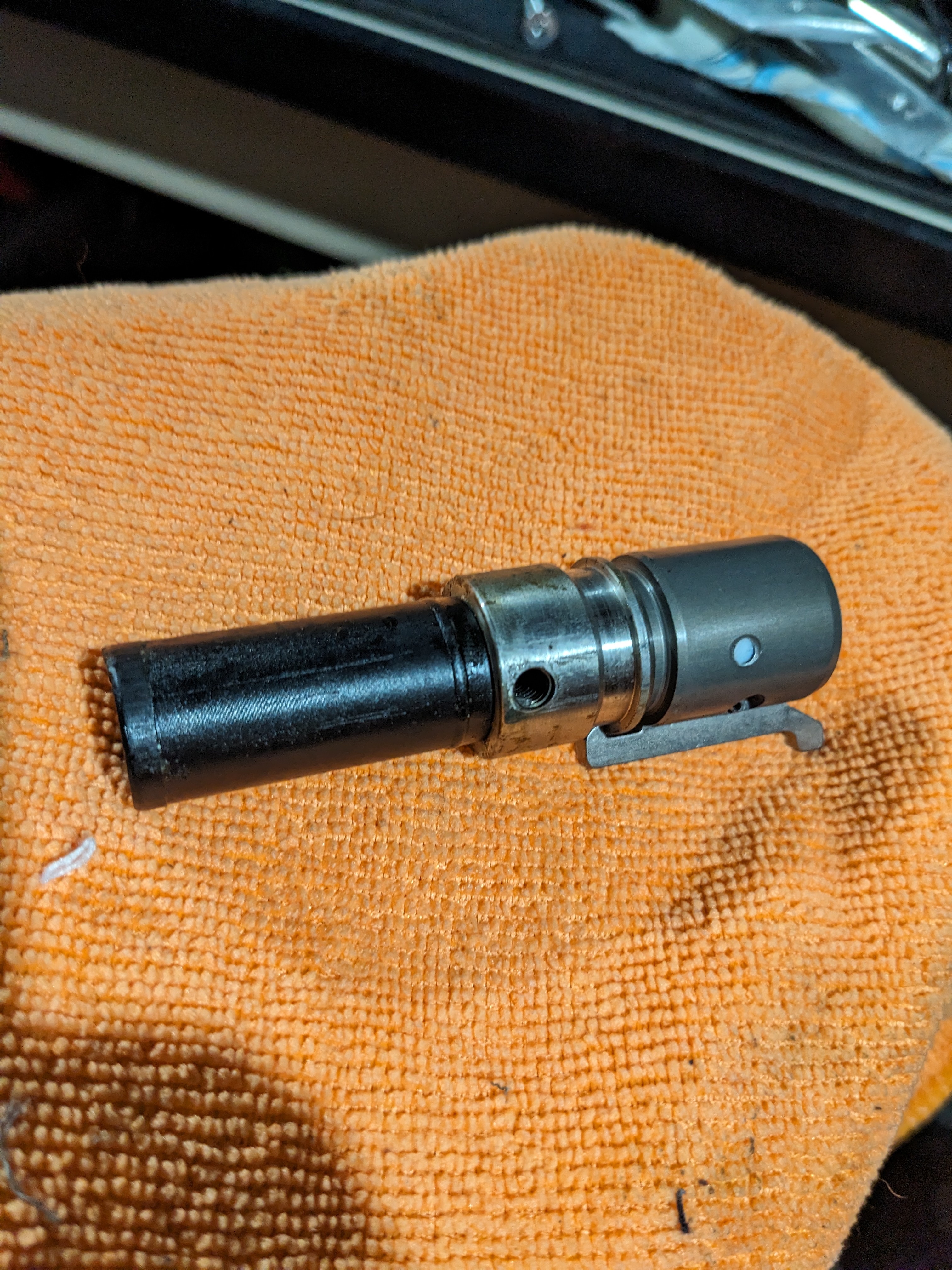

        • Glovebox Operator
          • Sep 2025
          • 446
          • New Mexico
          Delrin bolt with no groove for an oring, very little sign of wear on anything. Nothing seems bent or misaligned. I'll put it together once the baby goes to bed and check length of the tube.

            • flyweightnate
              • 1914
              • Dallas, TX
              That bolt looks far smoother and newer than any I've seen. The crooked side of my brain says it must be an undersized aftermarket bolt front, because all the original bolts I've owned were scratched all over and I haven't ever heard of this issue.
              • Glovebox Operator
                Glovebox Operator commented
                Could be, but the barrel also has very little wear on the anodizing from stroking the pump. This thing is in great shape overall. I'll have to test it with a hopper and see if it's actually an issue. The 10rd tube that was i used to test it earlier wasn't even close to a tight fit, gravity is about all that kept it in, and a single ball placed in the feed neck got puffed out too. I guess i should mic the bolt face and barrel ID.
