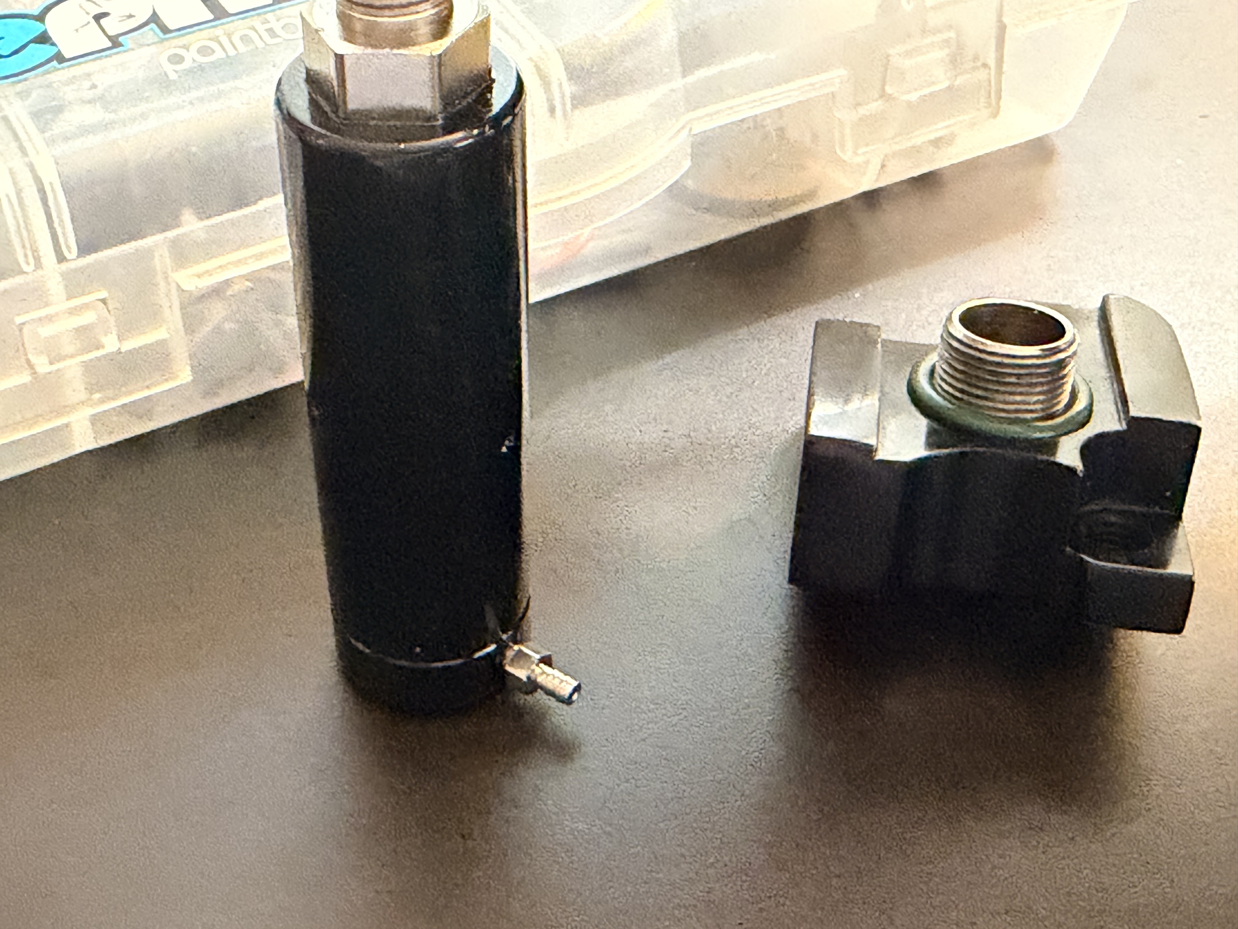

    Well, I broke a barb off last night trying to get the end cap off a LPR. What’s the best way to go about getting the broken part out with the least amount of damage? There doesn’t seem to be enough edge to grab it with pliers.

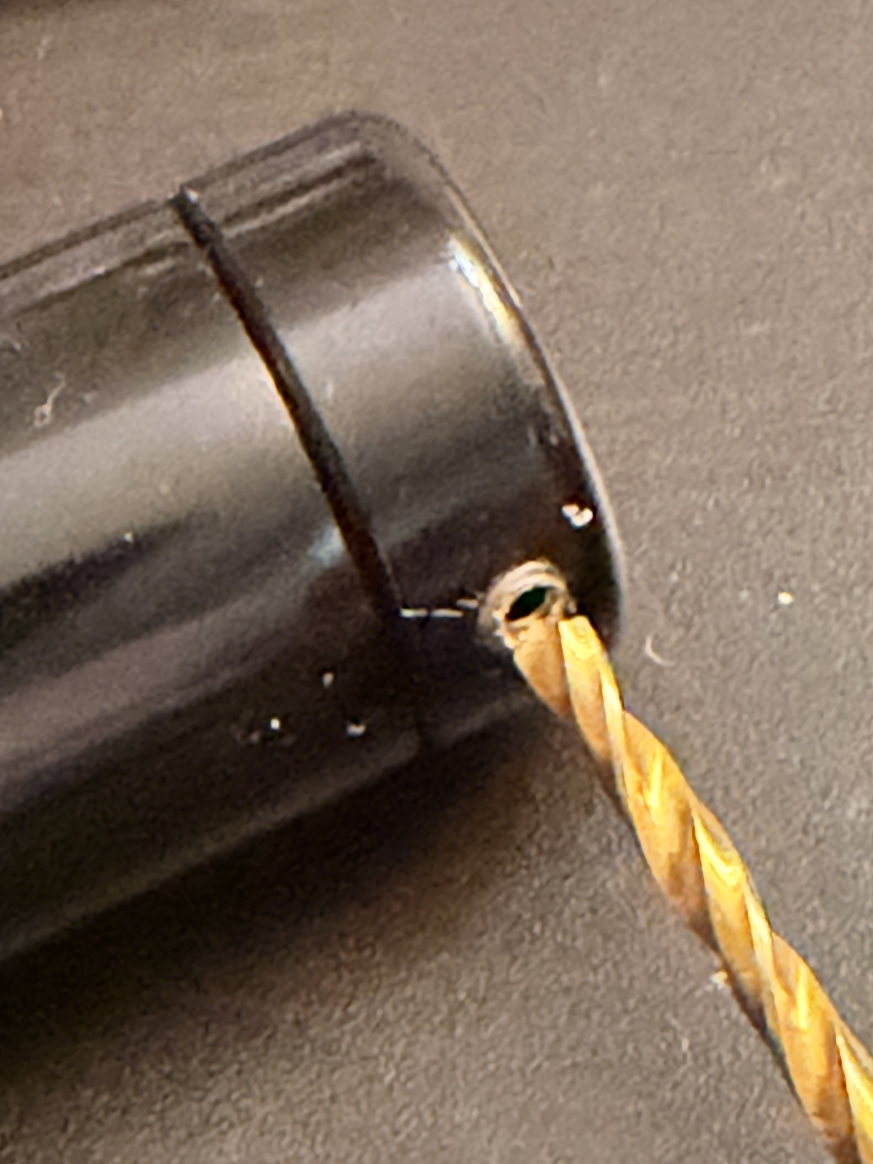

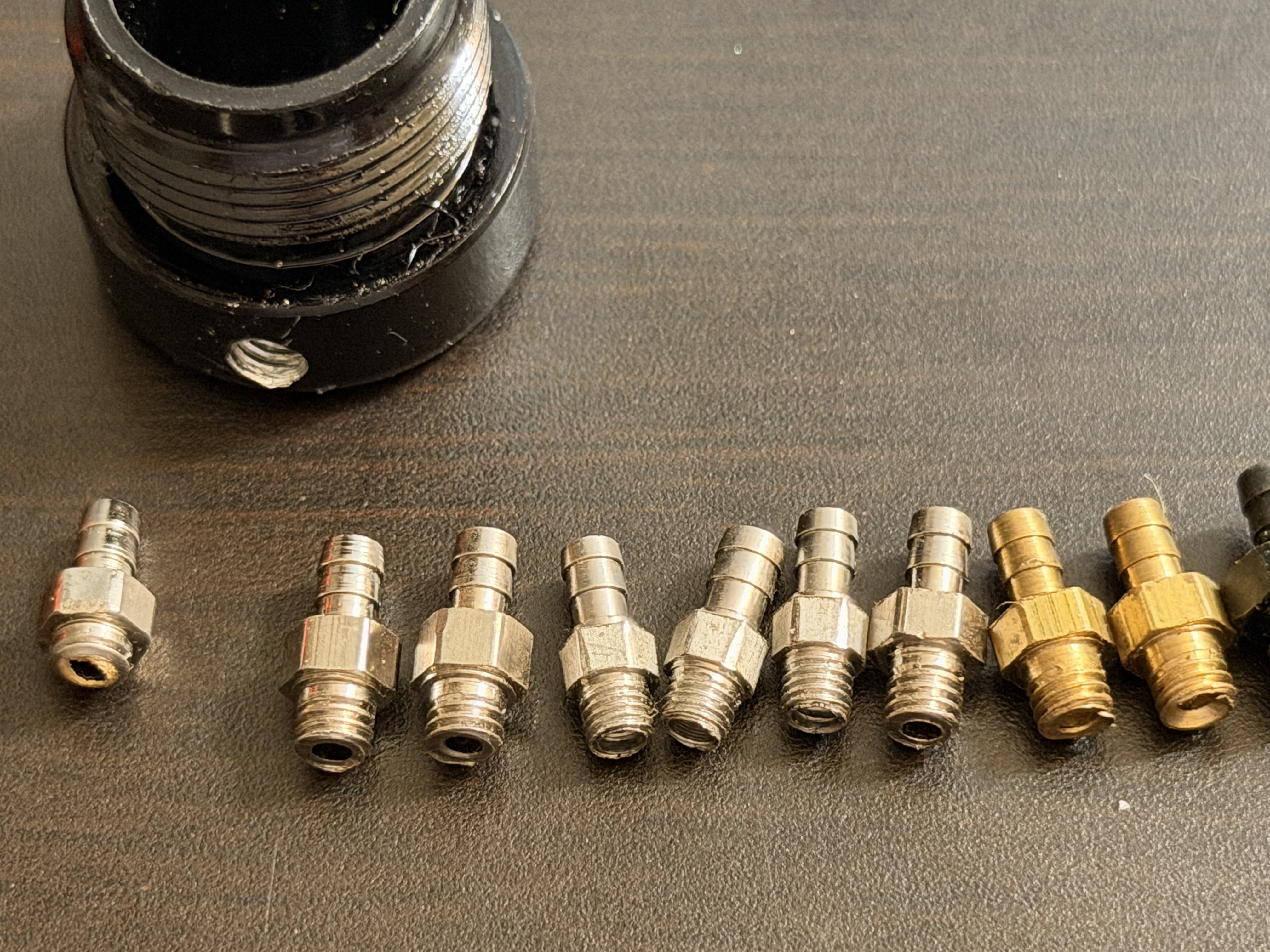

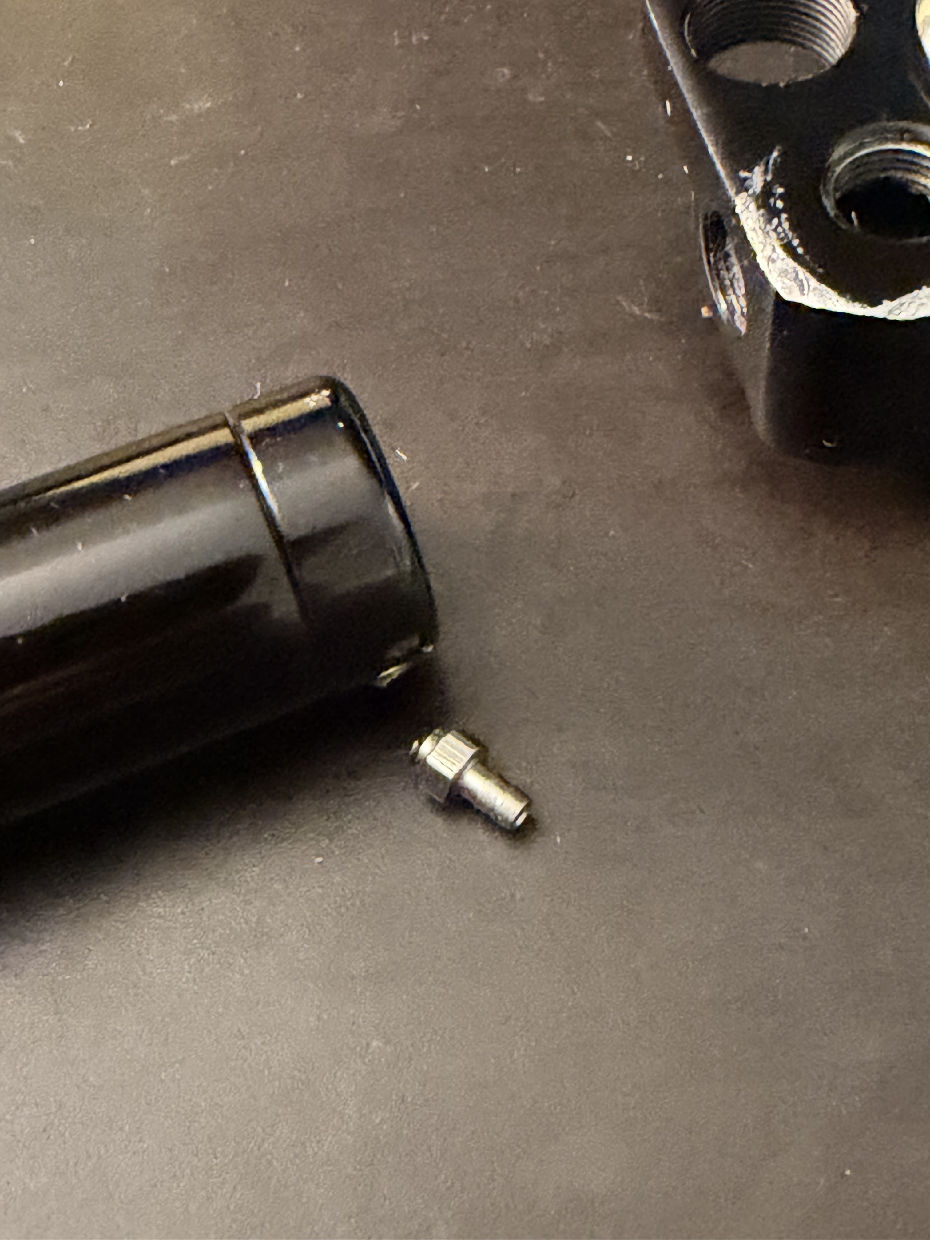

                IMG_9501.jpg Success, I picked up the 6-40 tap set. Drilling into it split and popped the barb out right away. The threads didn’t look great so I ran the tap and it cleaned them. Either they were filled with pieces of the original barb or the original thread size was smaller. Either way, one of the barbs in the pile fit so success. Thanks for the help, here are some pictures.
