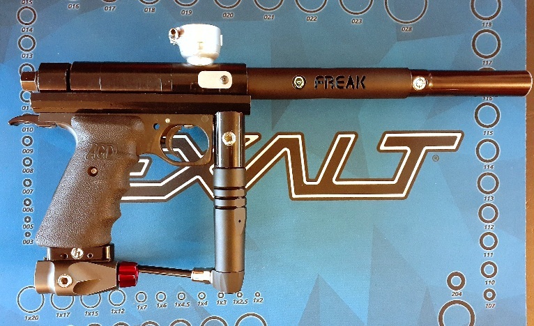

        I cut down this freak tip couple of month ago using a pipe cutter (one for copper)
        Take your time, start slow to make the initial groove and not too much pressure each time. I do 2 full turn and increment the pressure with the knob 1/2 turn and repeat.
        Aluminium is not that hard to cut.
        I put painter tape to prevent the roller from marking, use a deburring tool and sand paper to clear the burr inside the cut afterward
        it will show depending on the anodise color but I dont think it look too bad and can use sharpie to cover the cut.

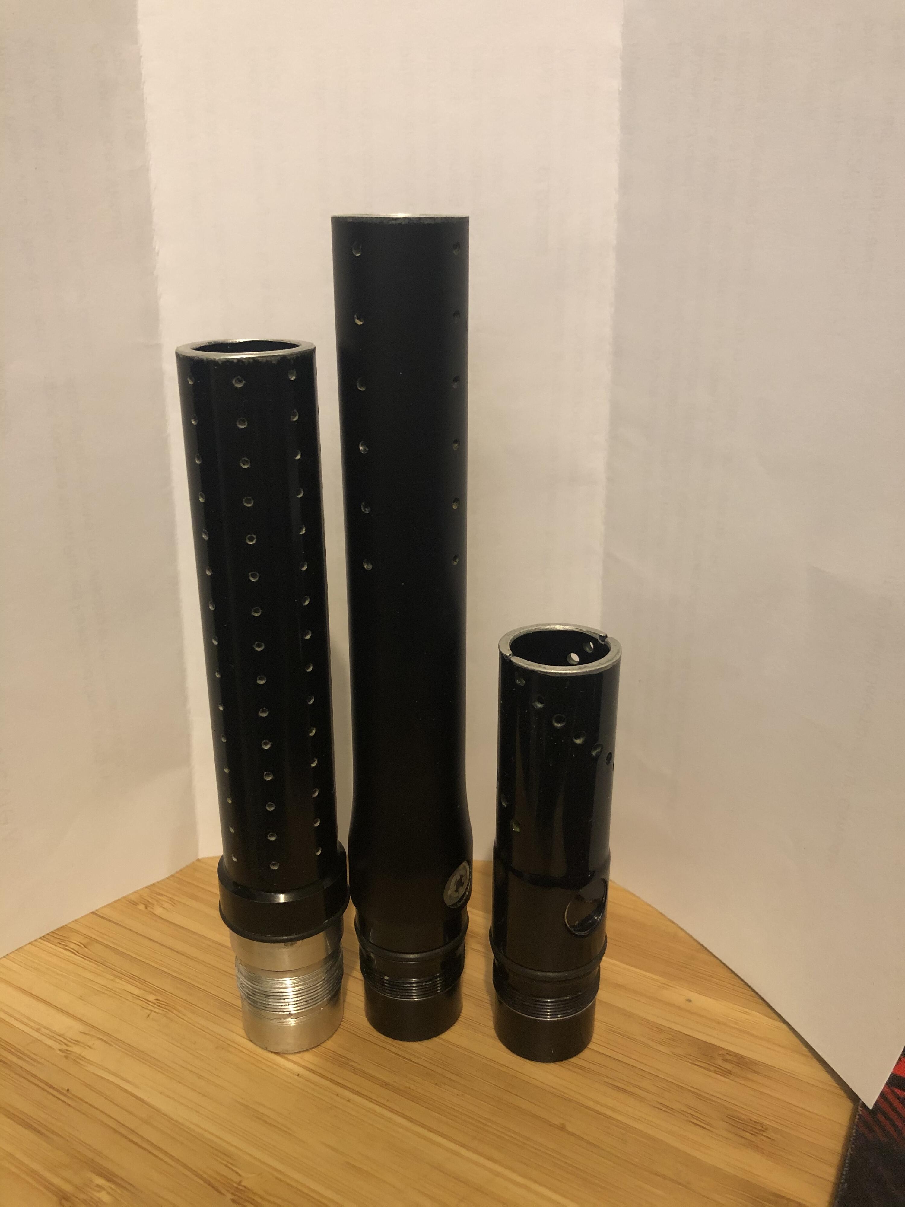

          So after doing a few practice cuts on a random Mini barrel in the bin, I got it cut and deburred. Might get some sand paper to make it a little more smooth. But it doesn't look bad at all.
          Would it be fine to leave the tip of the barrel raw, or should it be coated before use?
          My feedback
            Alexndl commented
            Raw tip should be fine
            But we need picture to see the end result before we can confirm 😄
