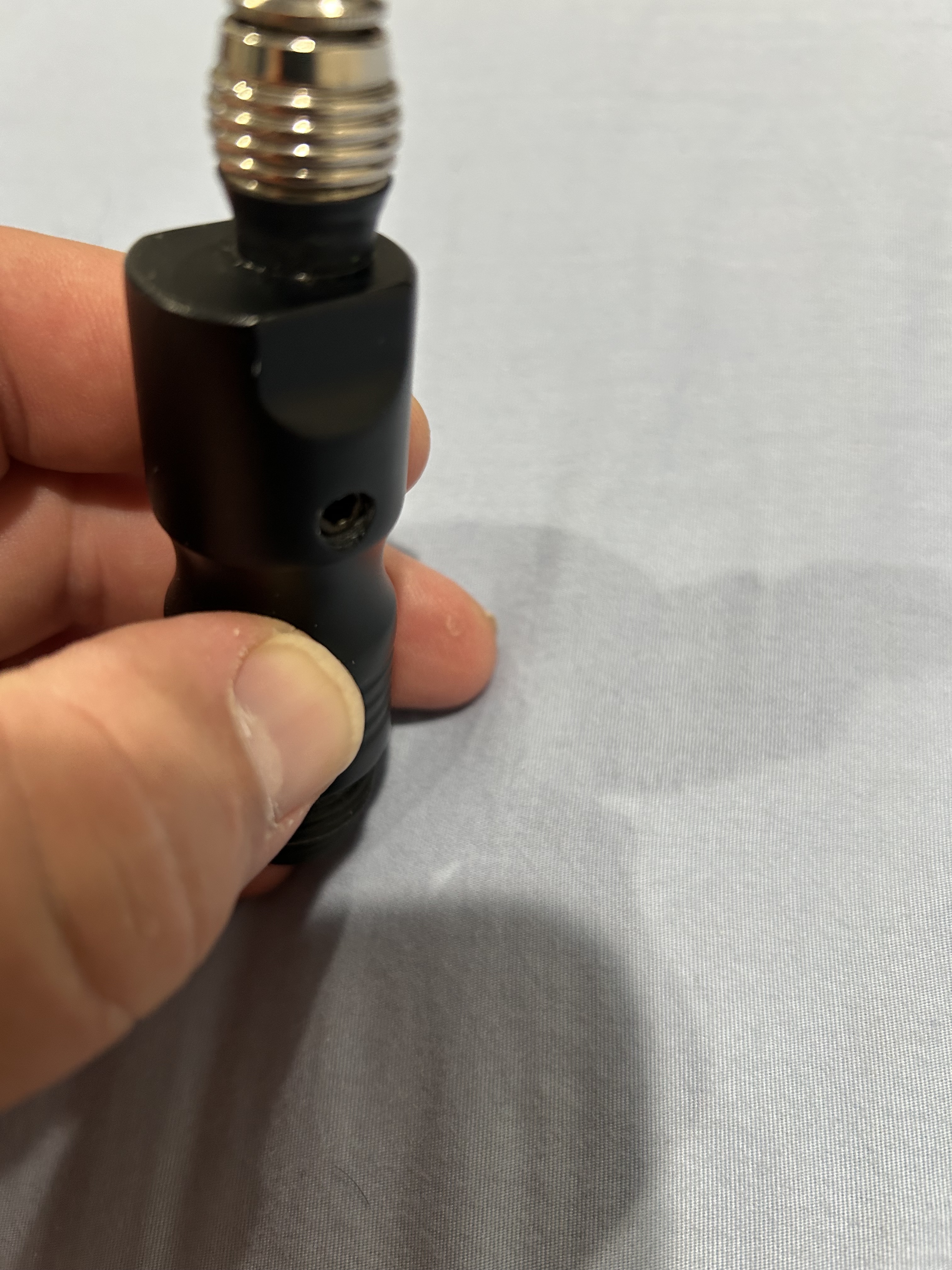

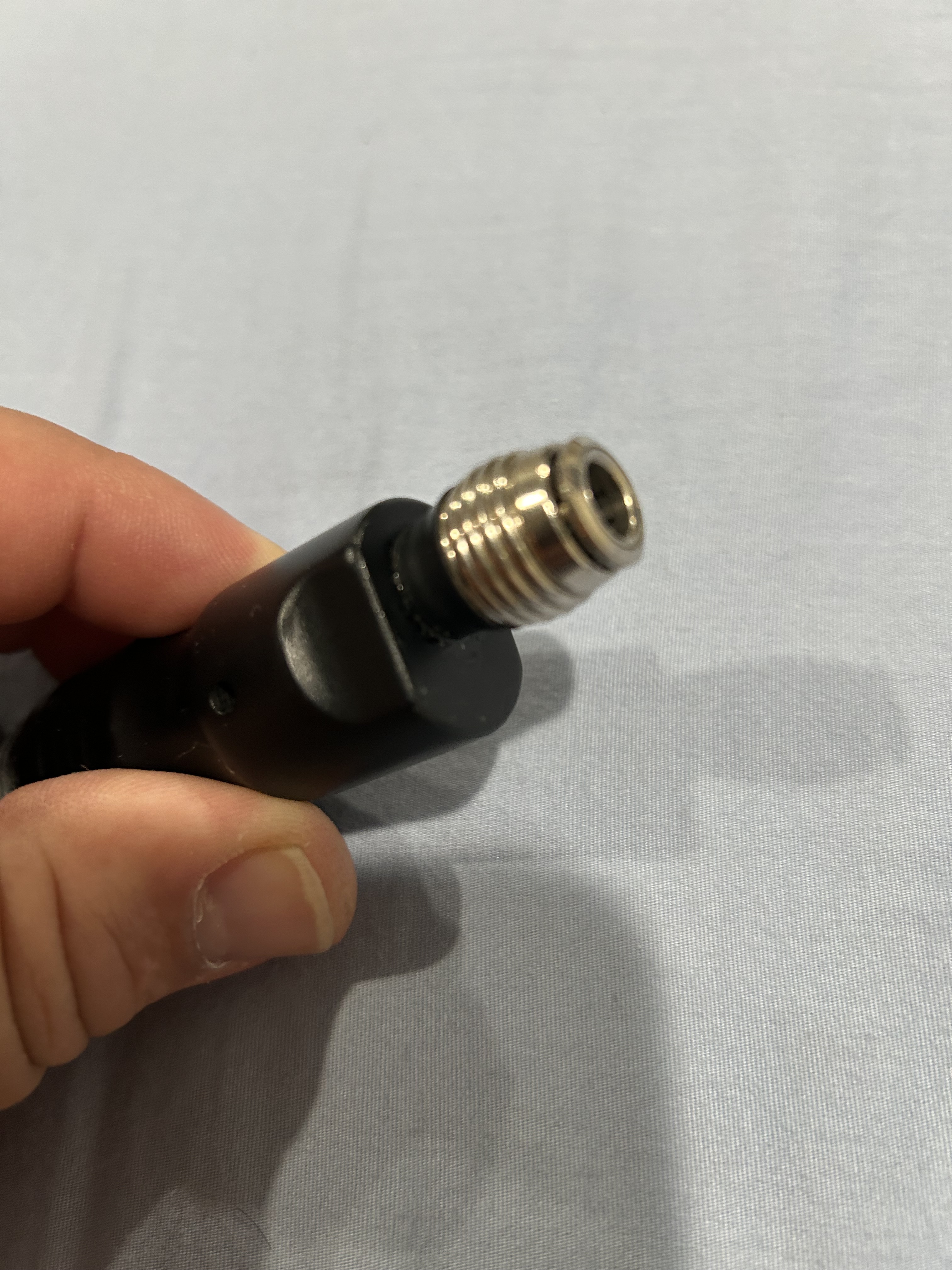

    Can anybody tell me the best way to remove this fitting or know if it is removable or not?Its for a project and I don’t want to mutilate it

    Is there not an Allen wrench hex pattern on the inside? It’s been a minute since I’ve touched one of those.
    • river031403
      river031403 commented
      I’ll get a flashlight Ana take a peak
    • river031403
      Tried not working
  • StaticShocked
    Didn't Read Instructions
    • Jun 2025
    • 382
    • Indiana, USA
    When i removed one it was very, very sealed in place. I stripped the internal hex of the fitting and ended up having to use vice grips on the fitting to get it free (while soft clamping the reg in a vise). Might try some heat to free up the sealant, as that is something i did not try. IIRC, it was a standard 1/8" NPT fitting thread underneath.

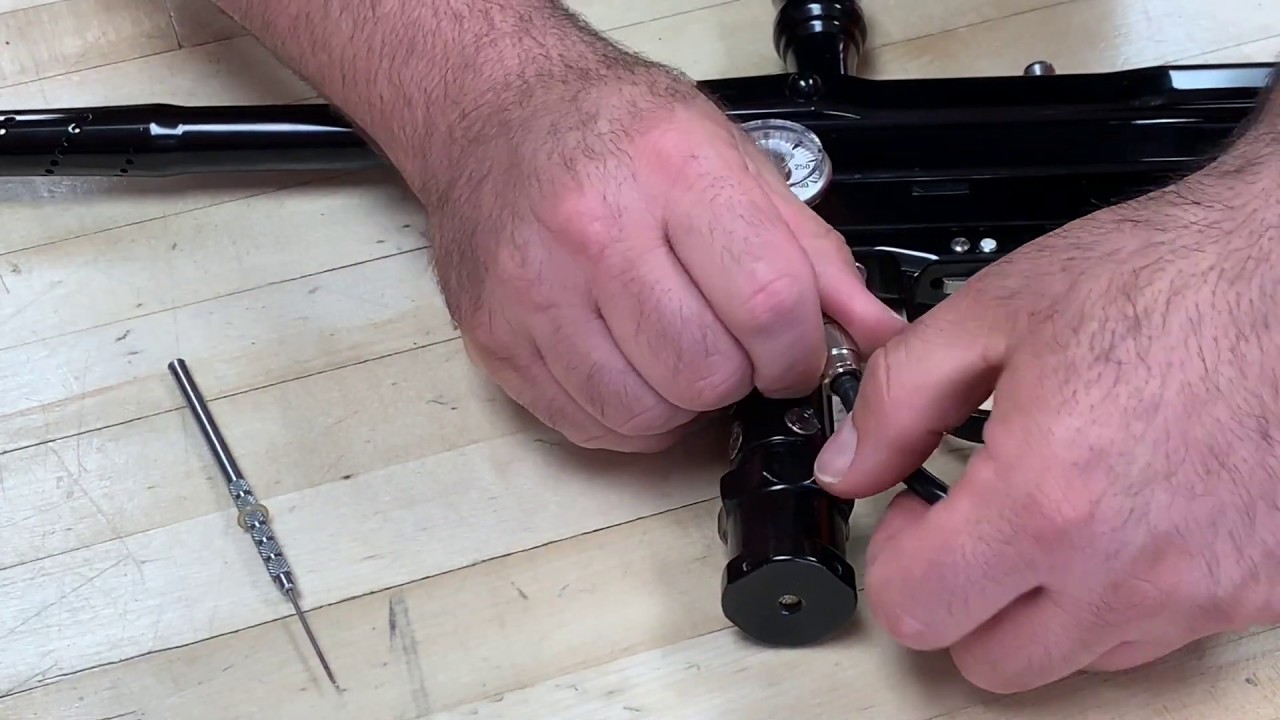

      I think it should come apart just like the other fittings.
      You put a flat head screwdriver under the collar and pry it up.
      Not sure about the o-ring size, it might be metric.
      Here is a video that shows the disassembly process:

        I want the entire fitting gone completely
      I used a little heat and crescent wrench 🔧 it worked thanks
