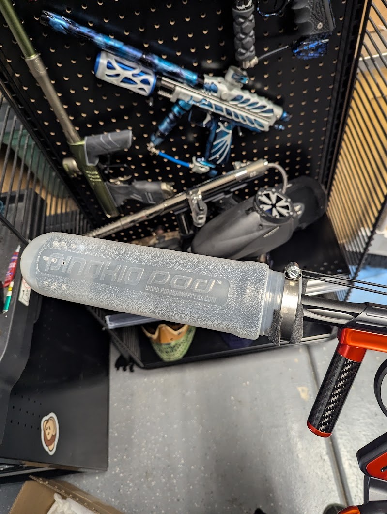

            I used an old pod I found on the field that had a broken lid. I took the cap off, rolled up some 1.5in case foam and stuffed it down the length so the barrel can slide in. I put an elastic band with a cinch on it so it works for various markers and barrel lengths. Just cram the barrel in, put the band around the feed neck and fire away. I'm not sure if it matters, but I drilled some holes in the end to relieve some pressure. Pretty dang quiet and cheap to boot.

              I LOVE this approach! Simple design. Great for those without 3D printers and with a ton of crapped out pods!
