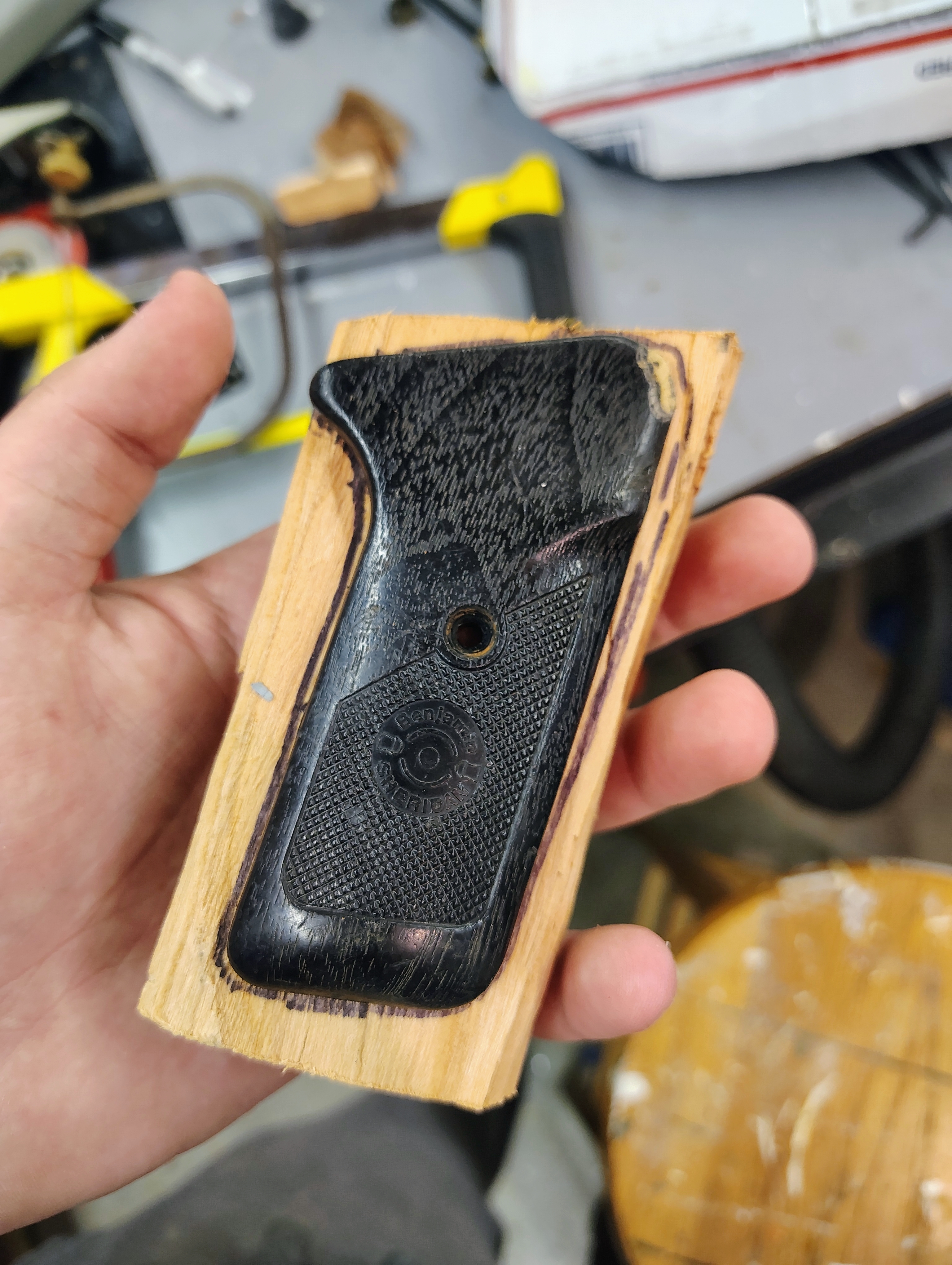

    Hey all, I'm working on making some cherry grips for my Sheridan. I have almost no idea what I'm doing but I think I have a plan on how I want to do it. Any suggestions or tips for this kind of thing?
  • BigRed
    • 1057
    • Canada
    Yup, get the pin holes (top inside) and the mounting holes drilled first before you start shaping. Cut bigger than the originals then shape down to size.

    I find that most wood, cherry included, chips very easily as you form the smaller corners. A few people have recommended Cactus Juice or similar stabilizers to help the grain adhere and fill the pores, both making it stronger and allowing for a nice polish.
    If you aren't moving that direction, a sharp file and a cabinet scraper are often-overlooked tools.
    Scanning an existing grip on a flatbed is a great way to make a template.

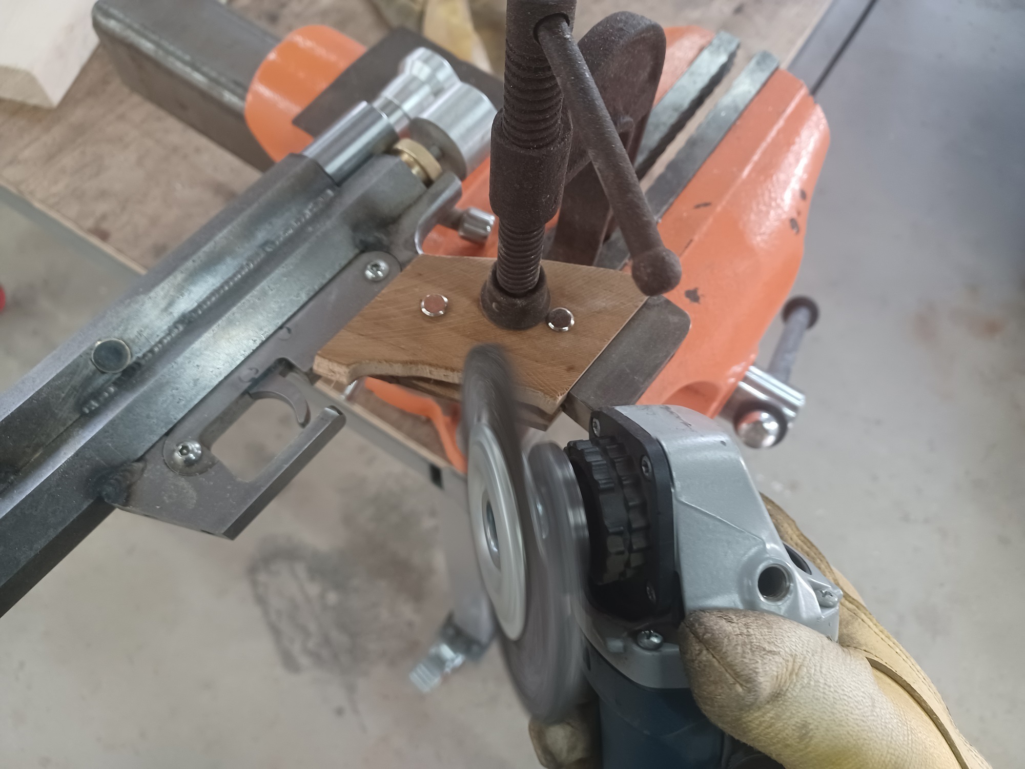

      Wire wheel on an angle grinder for rough shaping
      • Reflex0283
        Reflex0283 commented
        Never would have thought of that
        make sure you use a shield and long sleeves with those things. The wire can come flying off and will stick in yah real spicy like. Ask me how I know.
      • flyweightnate
        flyweightnate commented

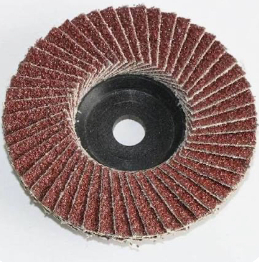

        Flap wheels are a little less spicy.
    • BigRed
      • 1057
      • Canada

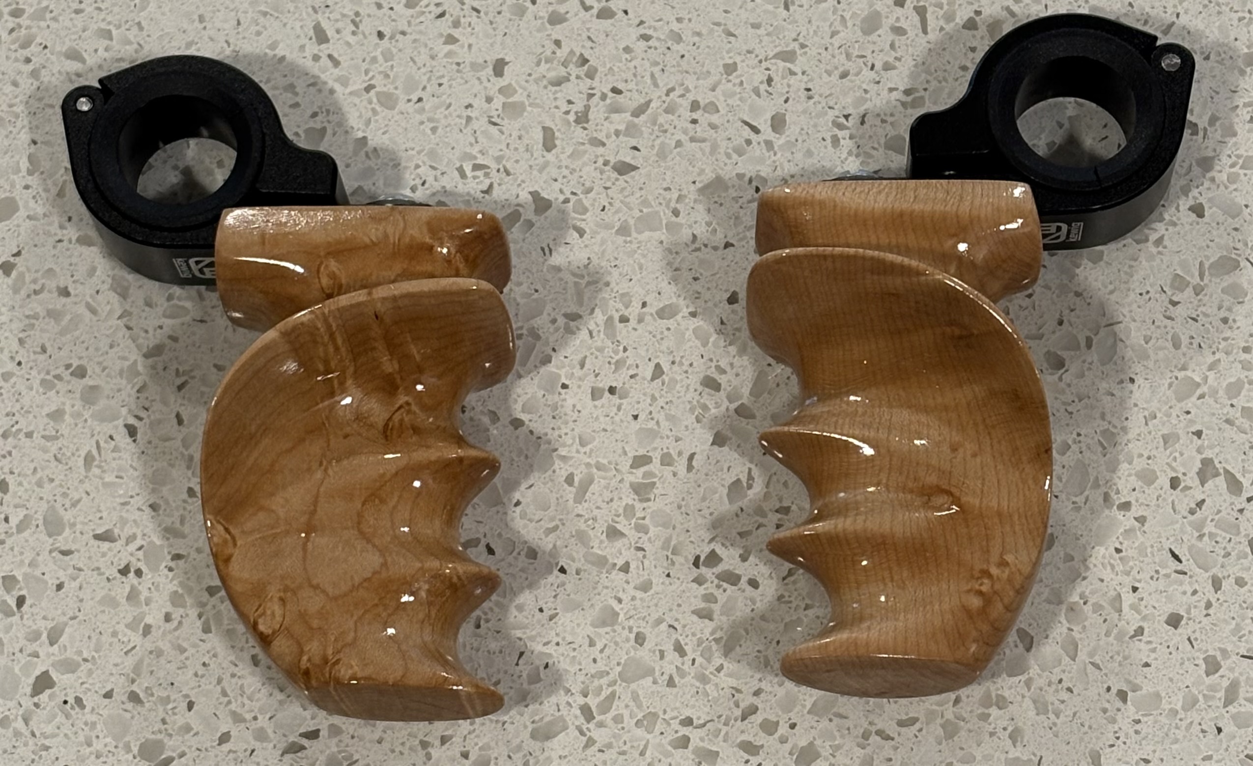

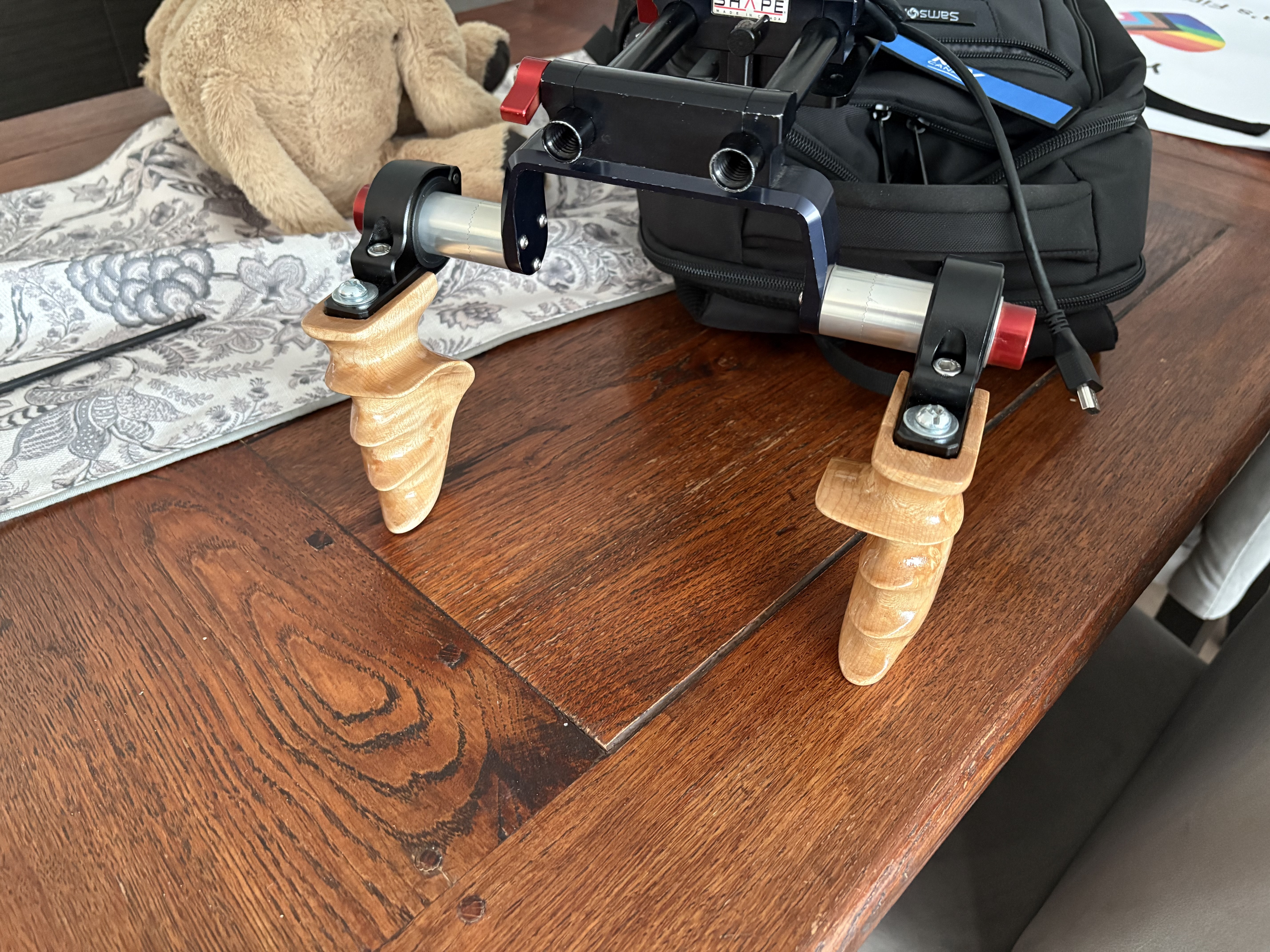

      I use a regular sanding wheel for the angle grinder. You can really move material quick but also be pretty surgical too. Click image for larger version
ID:	765396 Click image for larger version
ID:	765397 Click image for larger version
ID:	765398 Made these for my son’s camera rig.
      BigRed's feedback
      • $L!mBo
        $L!mBo commented
        awesome work
        whats that rig? a camera?
    • BigRed
      • 1057
      • Canada
      Yeah it’s a Shape composite rig. He’s running a Blackmagic Pocket cinema 4K at the moment on it.
      BigRed's feedback
      • BigRed
        BigRed commented
        Camera prices makes a joke of paintball’s!

      Also worth mentioning get them down to a rough shape and hold it and Trace where your fingers are and carve it out to fit your hand. I've done that once or twice with some stocks I've made and some other grips and generally they come out very comfortable.
      I'm not much of a woodworker but I do also recommend the flap wheel concept. I've used an angle grinder and a flap wheel to hog out thumb hole stocks from 3-in thick wood bars instead of taking days the roughing out takes maybe an hour.
