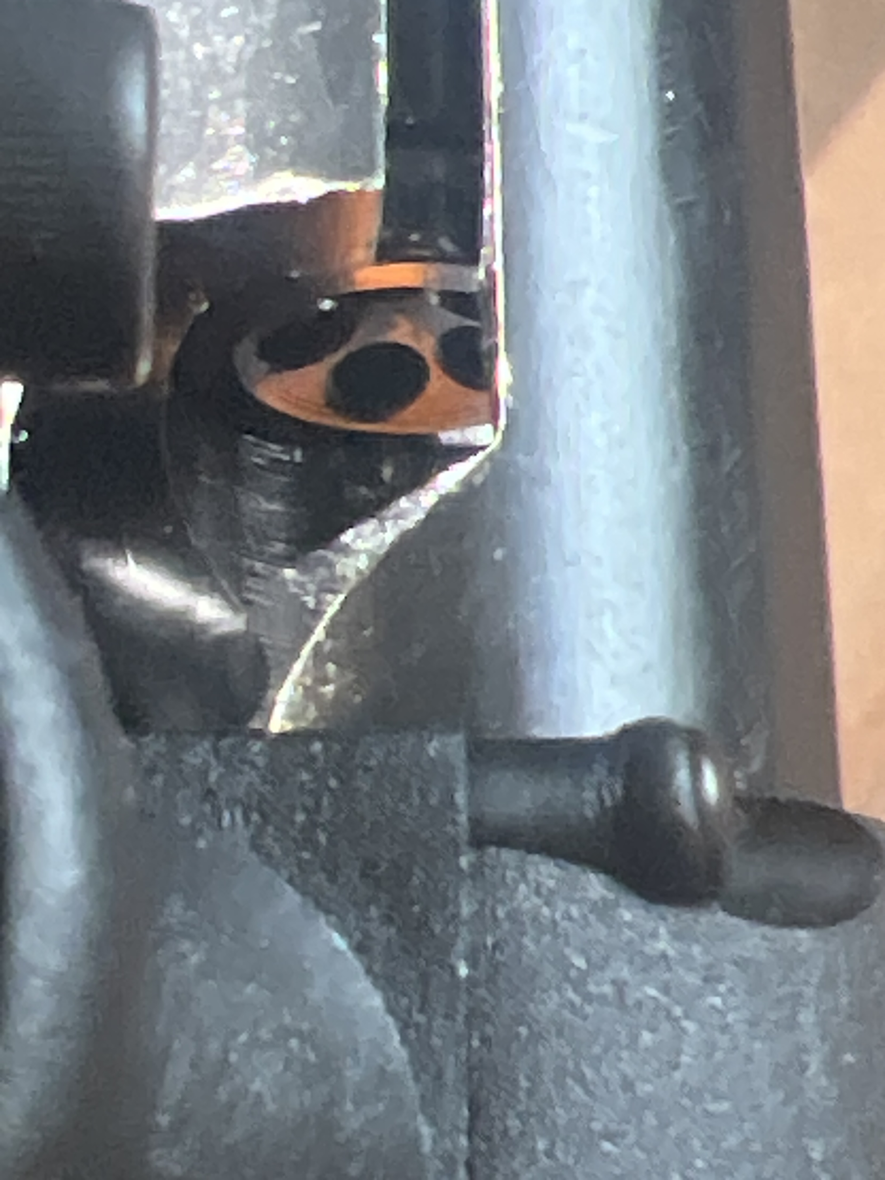

    So I picked this up and it was labeled as a Venturi front bolt for the Pro-Lite. I got it but the Venturi face made contact with the power tube which prevented sear engagement. It was also much longer than a standard Pro Lite bolt. It’s aluminum as well which surprised me.
    I tried it on the Pro Carbine and it was worse. The Pro Carbine doesn’t have the recess on the rear of the power tube the Pro Lite has so it wouldn’t even get close to cocking back. I decided to make it work for the Pro Lite which required me cutting part of the powertube so the Venturi face wouldn’t contact it and I had to cut the back of the bolt down because it was just a little too long which was also preventing sear engagement. I got it all squared away but I’m wondering who made it and which marker it was intended for?
    The picture is post cut, it was longer, I think I cut 3/16 off. I can’t remember. Maybe it was 1/4 but I’m pretty sure it was 3/16. Same for the power tube. It was either 3/16 or 1/4 that made it work. They both were cut the same amount. I learned the hard way that I can’t just drill a new linkage arm recess when I was working on another bolt for a different Tippmann. If I had drilled a new recess the bolt would’ve stuck out too far in the breech.

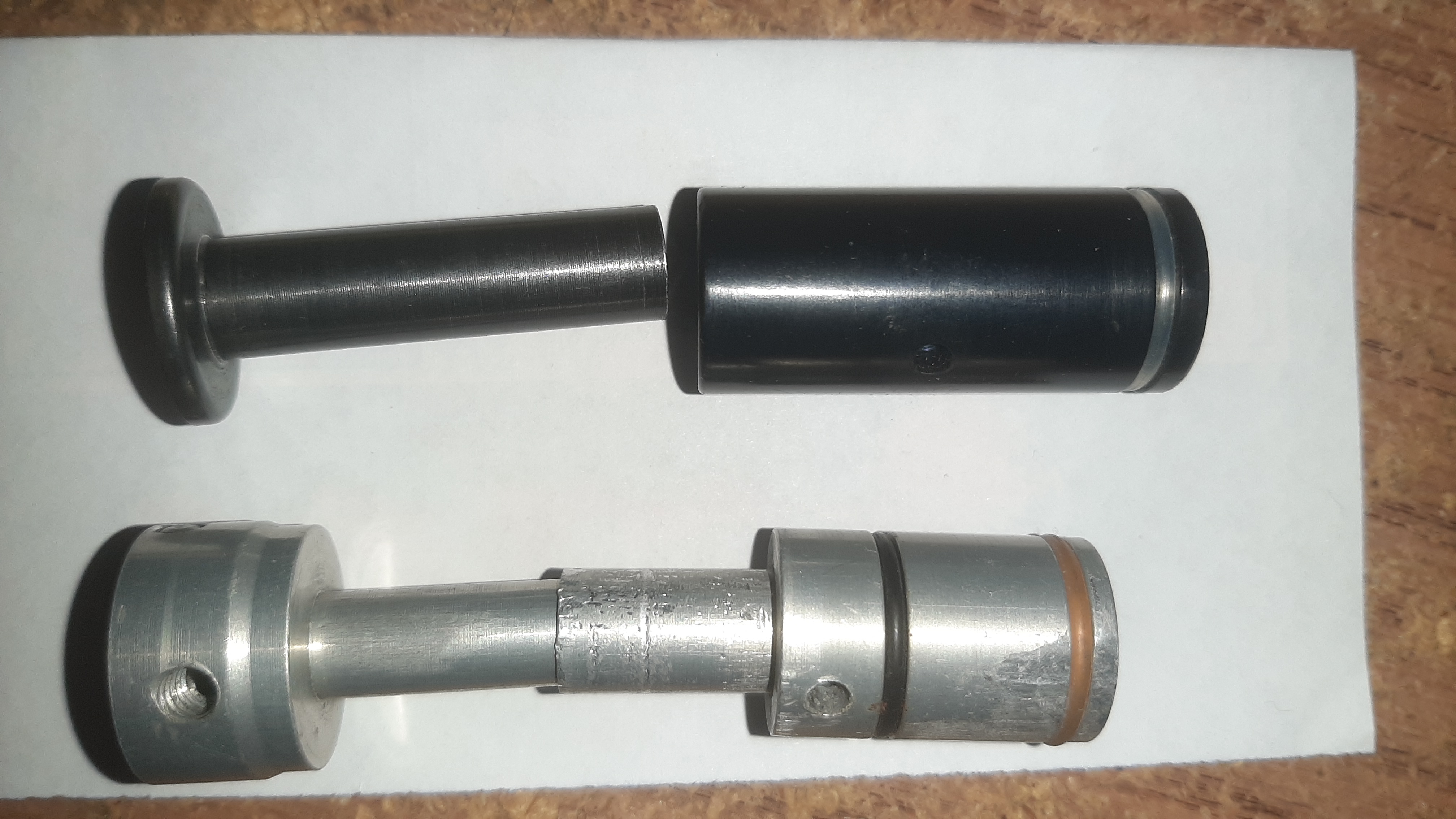

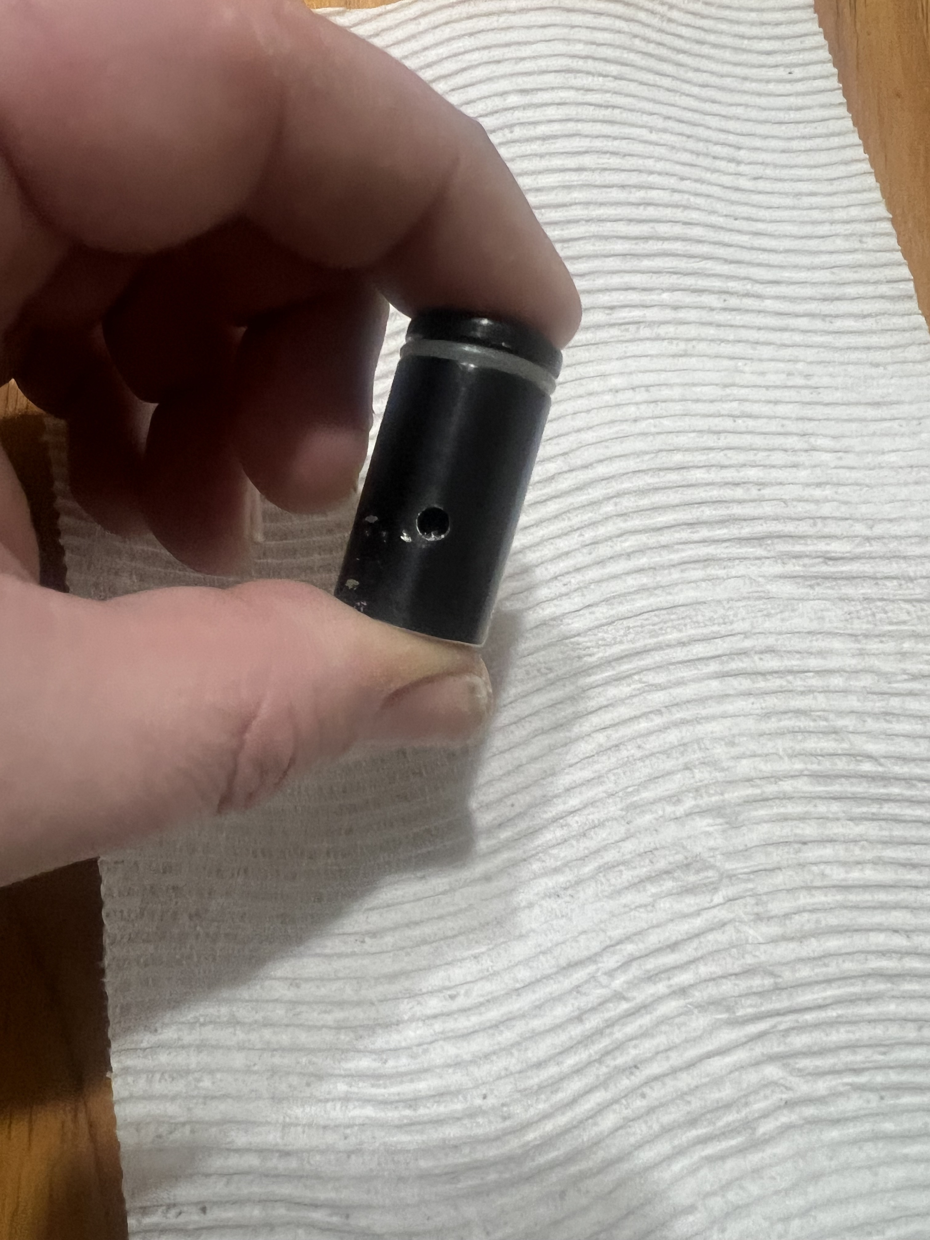

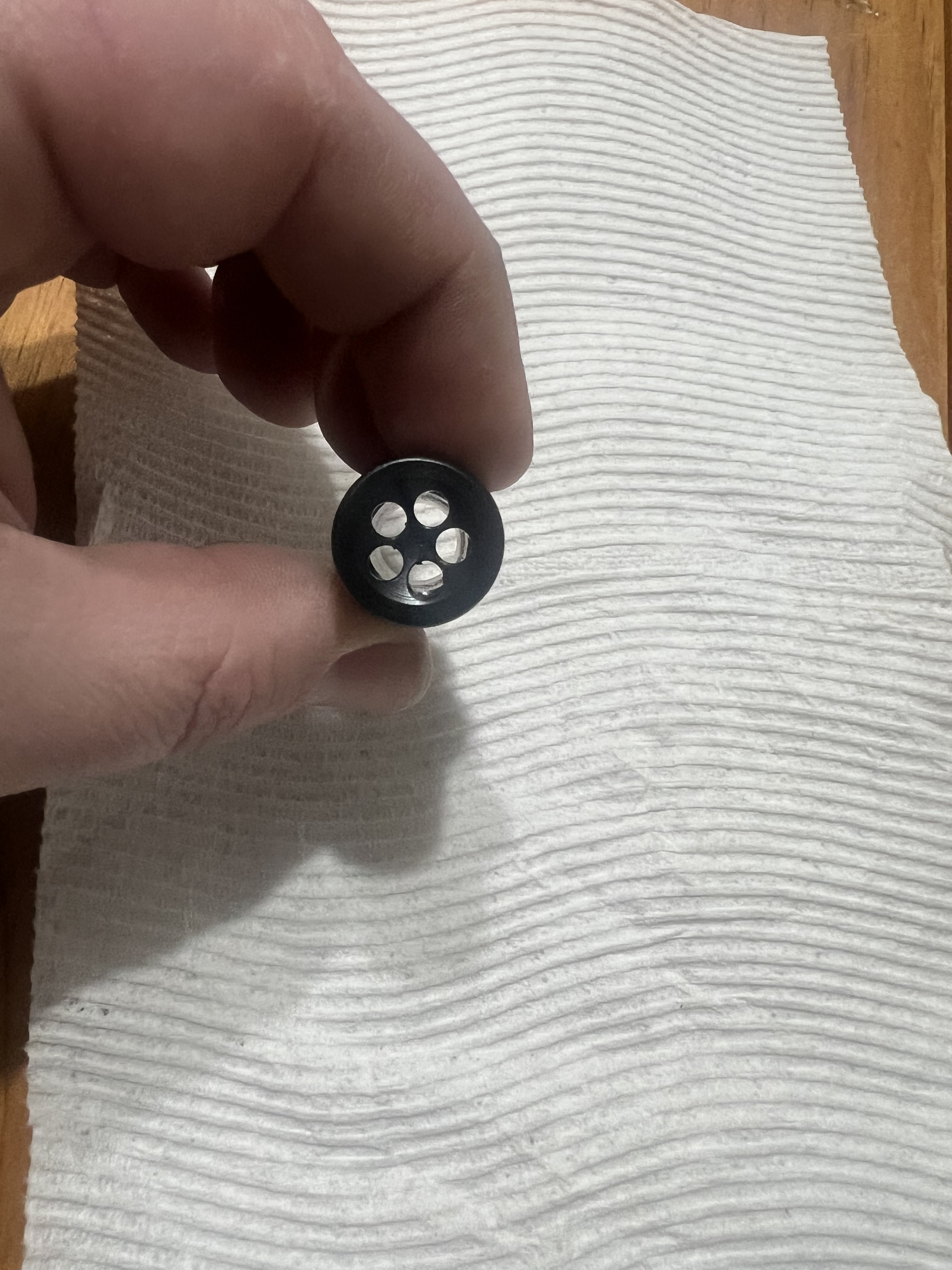

      It was sold by I&I Sports. It came with a power tube that would not fit in the gun(Pro-Lite). it was one of the many parts back in the day, that were created and sold but never tested or even installed. I complained to them when i received it but they really didn't know anything about, they just sold it.
      The only Venturi bolt that worked(sometimes) it the Pro-lite was Telescoping. It was like a collapsing antenna. I still have one in my Pro-Lite
      Edit My bolt does look different then yours. You can see the powertube they included . It wont work because its loose and does not open the front valve pin.
      the bottom bolt is the telescoping one. Click image for larger version

        FlightMedic938 the base of the power tube needs to be the same as the original. When installed there is nothing holding it in place. it will never work.
        it pre-dated the Carbine so it wasn't made for it, I just checked and the power tube is to big (width) for the Carbine. it could be modded to fit, but you loose your velocity control.
