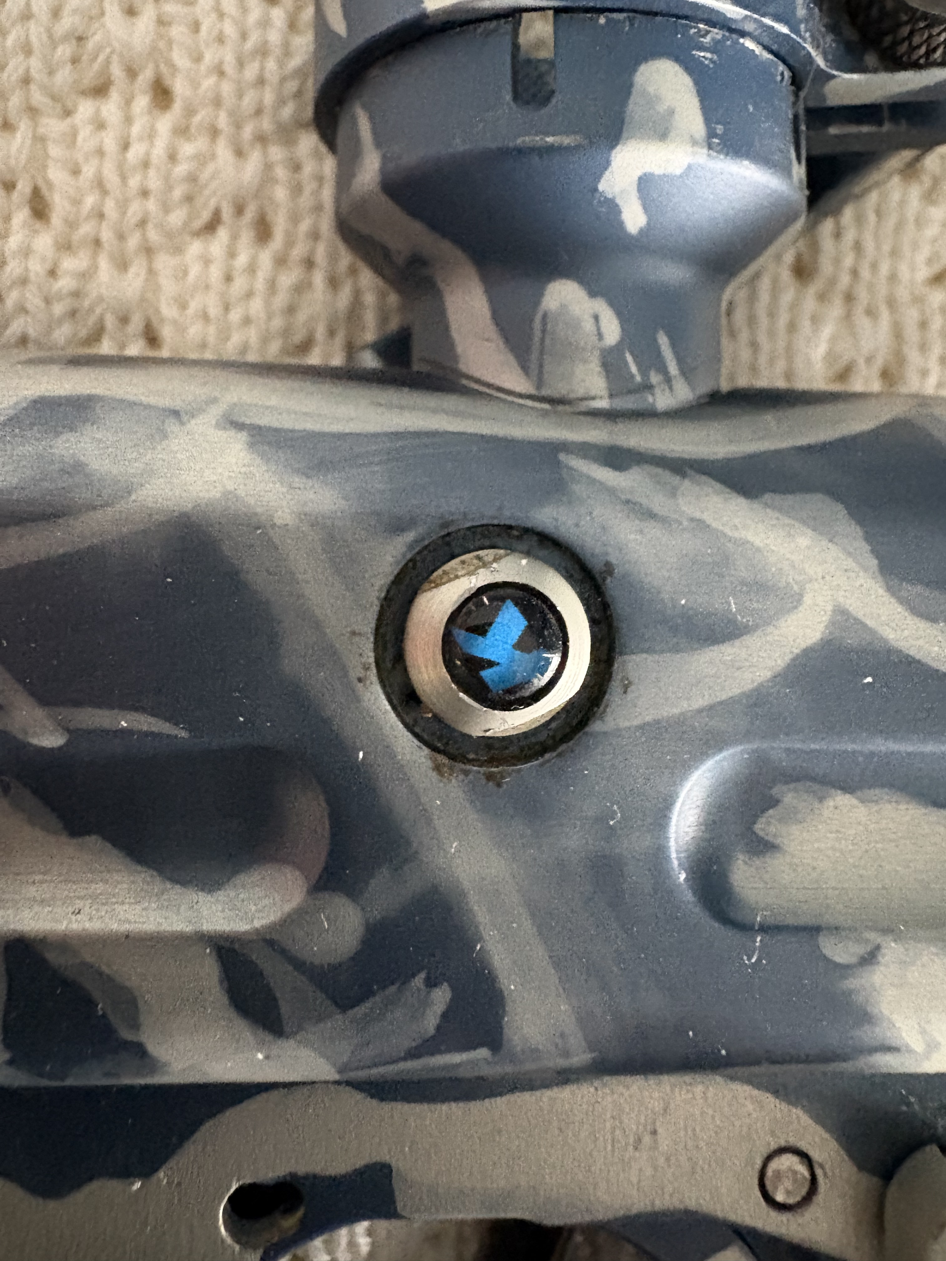

    I just overhauled this one and need to find out something about these detents. Both detents are shot and my AGD detents wont work. I know there are a myriad of detent threads and i really dont want to buy a bunch that wont screw in. They look like Kapp's but I know they dont make them anymore. Any help would be appreciated.

    That is a Kila detent. Pretty sure i have one of those bodies kicking around that i can check.
    My guess is it is either angel or cocker threaded. I know i have seen those detents in ule bodies though.
      Well thanks for that info. I dont see a way to get these apart even if there were parts available to fix them. If you could figure out what might work in here that would be great. Thanks Jake. Do you know who made this body?

        The body I'd guess was made by XM15, I've got one of his prototype bodies that looks very similar to this one.

        XM15 made them. Pretty sure mine is cocker threaded.

      Believe you have to take off the jewel and there is a hex beneath. Typically Kila detents just have a delrin pin with a magnet.

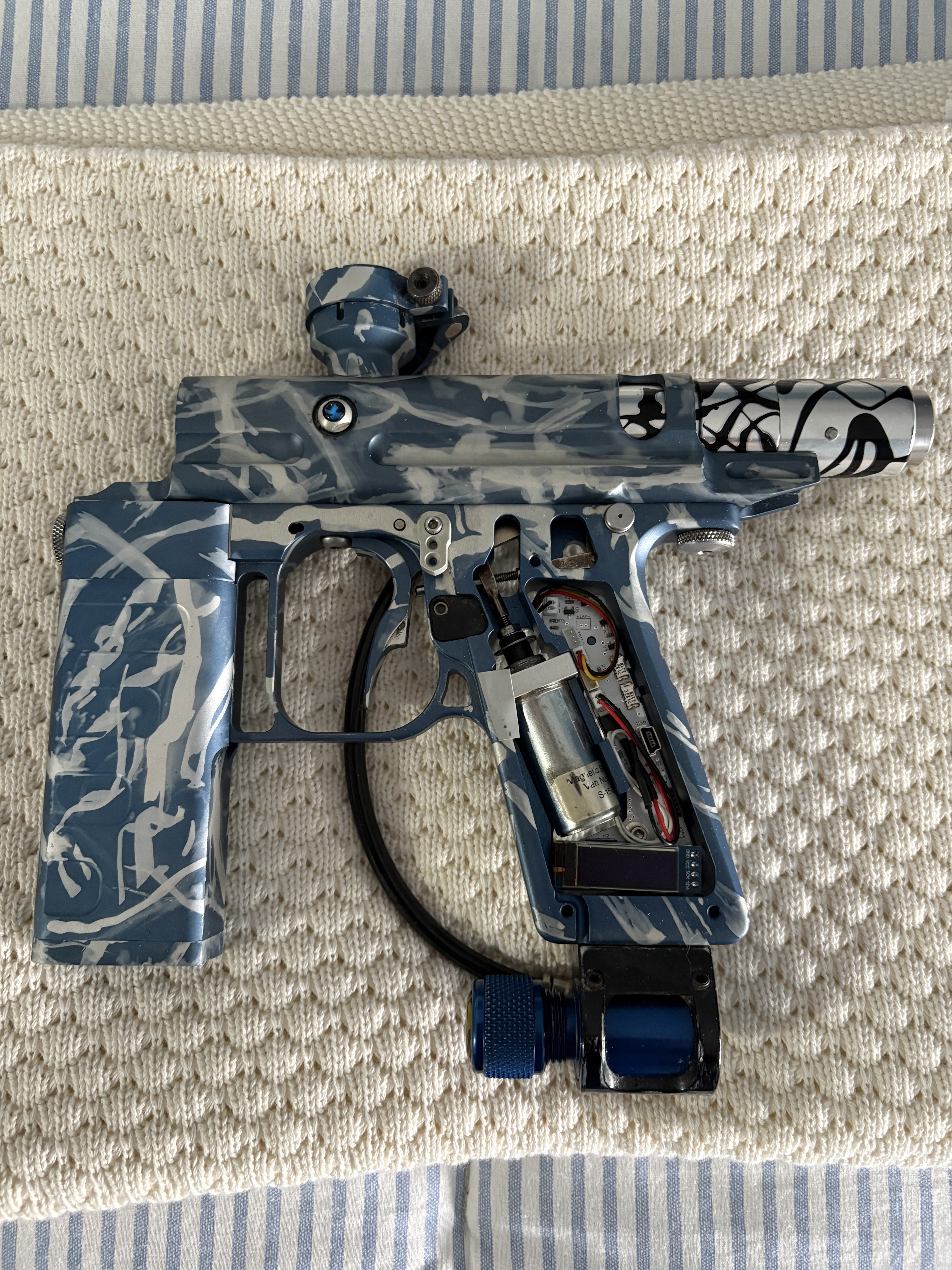

          I set this gun all up with the Sci-Fi board, new Inception Detents from Jake, and a new 1000MAH battery made by me. Tuned and tested the guy just emailed me and said it rips. Gotta love these Mags! Thanks for the help Boys!
