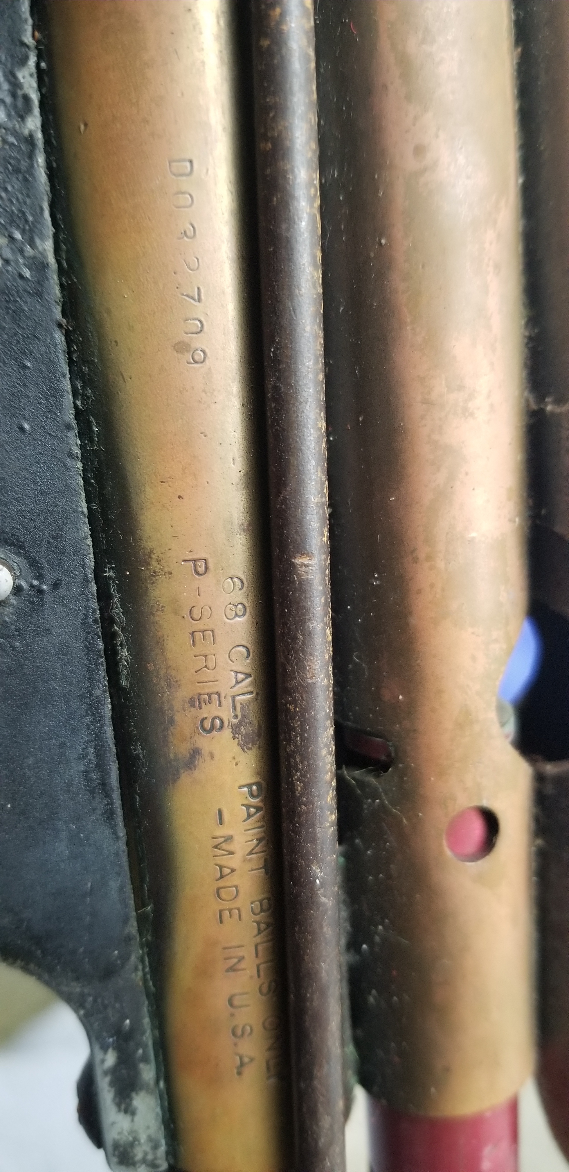

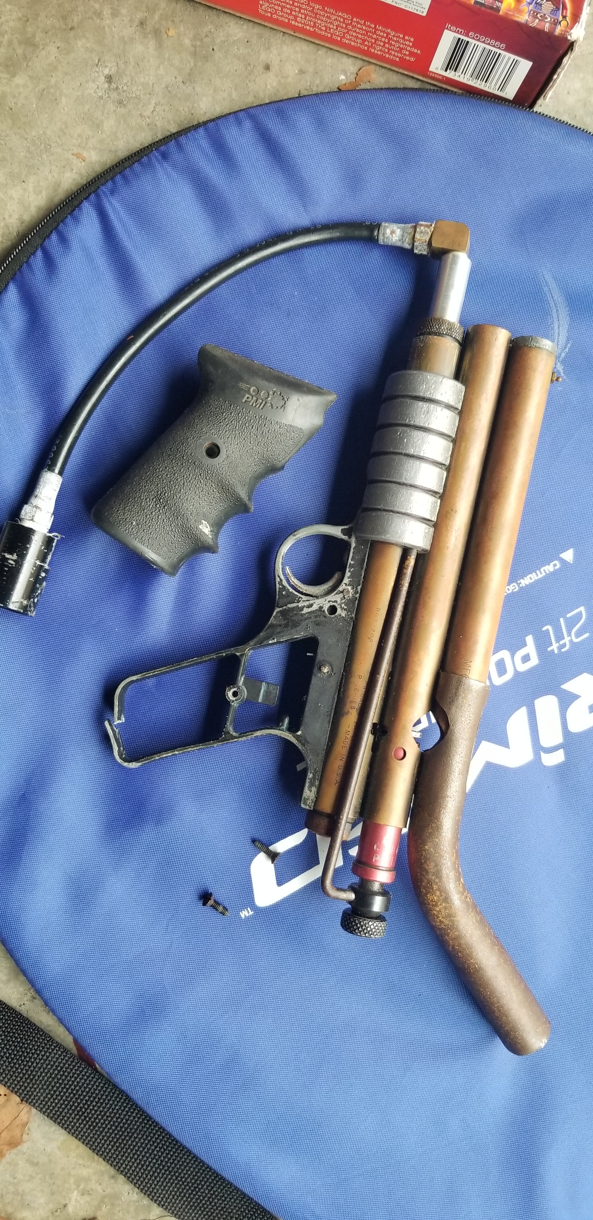

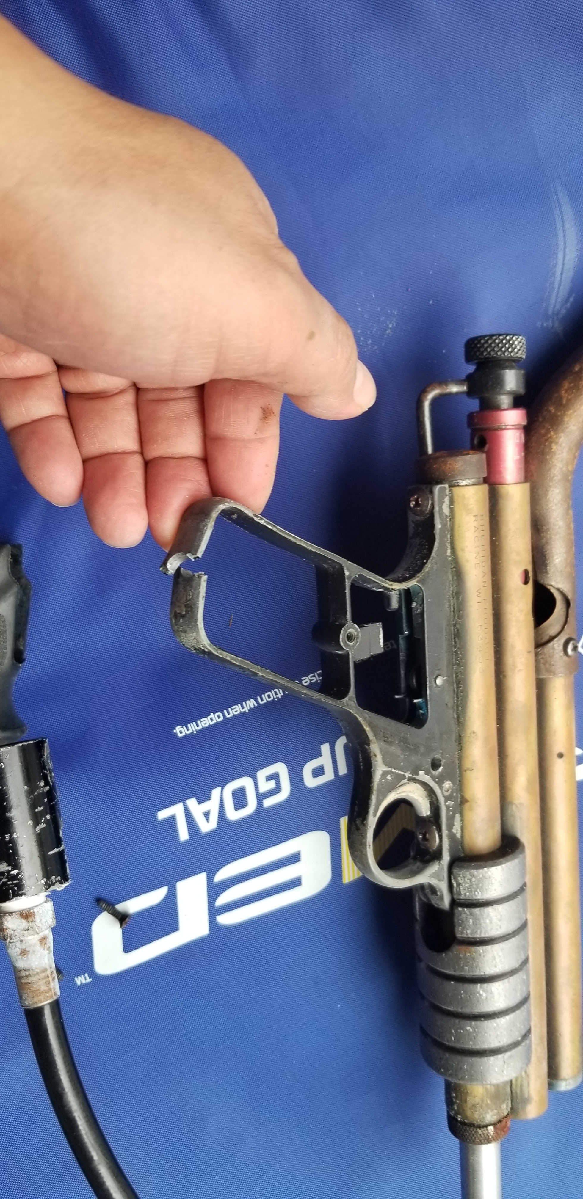

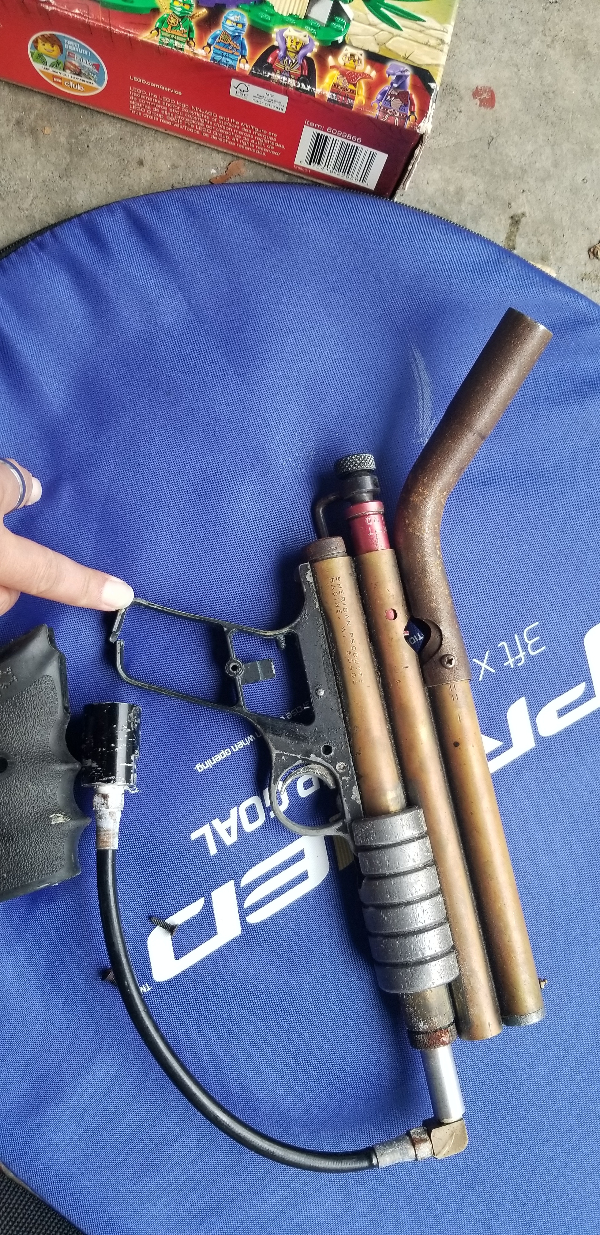

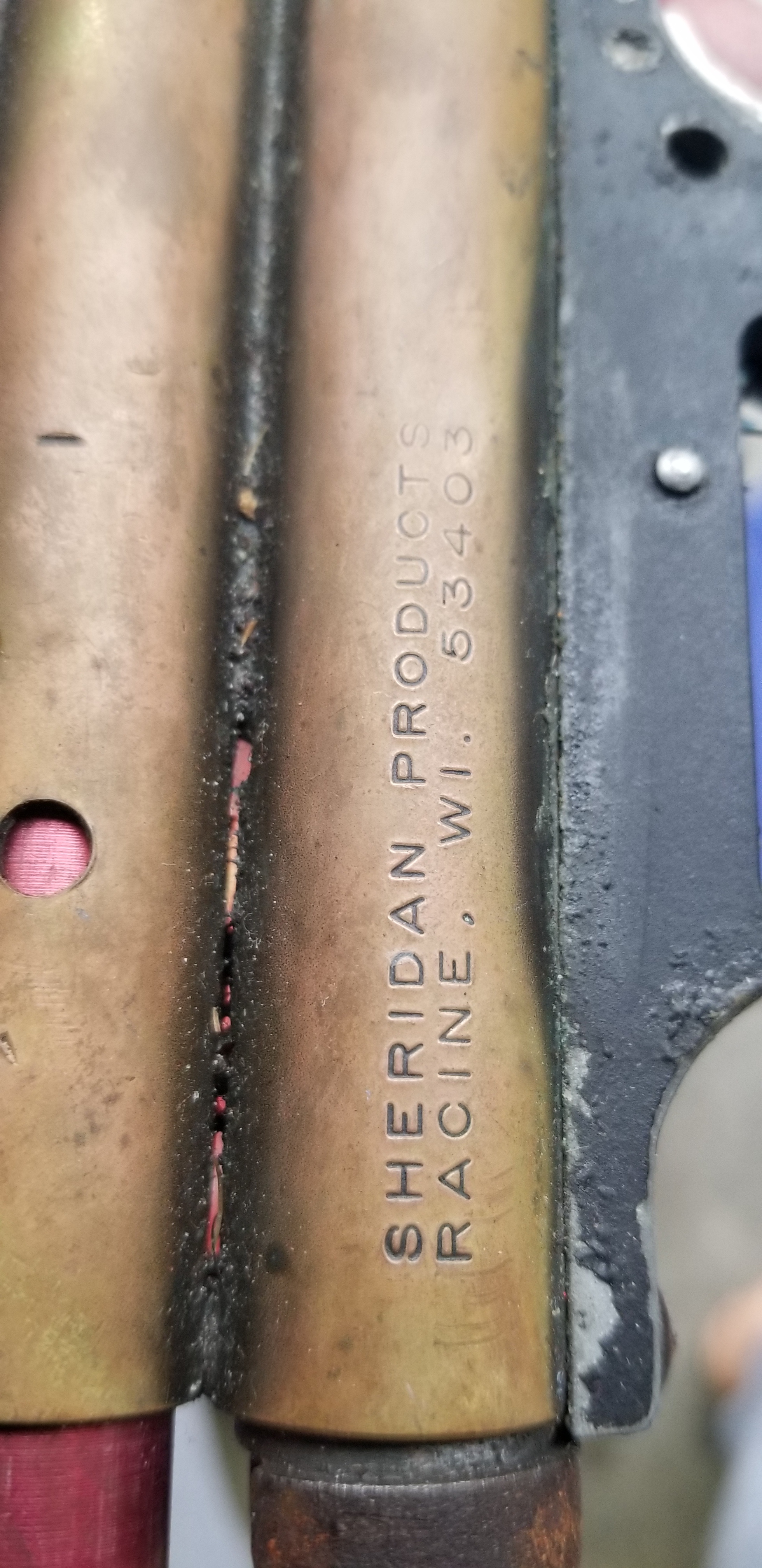

    What can you share on this pgp.looks like it should be constant air at the bottom of the frame. But the frame is cracked there. Home brew gravity feed. Not seen a red bolt before.

    That’s a Cooper T bolt.
      • 4456
      Abd that's a pk45 hopper adapter
        enter over there..☝
        • 5081
        • ....on the 13th floor!
        older p-series = non-cartridge valve body
        Possibly an Assault Line CA adapter. Those were usually anno'd in black though. (the part in the 12g area)

          I think I've got another frame if you want it, just pay shipping
          • FredMnkyDad10
            FredMnkyDad10 commented
            I will take you up on that. PM you.
          • 6401
          Frame likely cracked from someone drilling it and mounting that bottom line. Putting a tank off the back of those frames without reinforcement puts a bunch of stress at that point. Especially the size tanks that were available in its day.
          There are options available to mount a bottom line to that more securely if that what you want to do. They are basically thin panel’s that fit under the grips and mount on the grip screw holes on both sides that give you a much stronger hold for an ASA to mount. There is also cocker frame adapter plates you could use that are already designed for bottom lines or BlueFork trigger group that takes AR style grips like a Phantom 45 with bottom mount holes.
          If it were me I would throw a Doc quick changer on the front replace the frame with one not cracked a shoot it as is. Sounds like Reflex already got you hooked up with one.
          Those Cooper T bolts are nice upgrades I believe they are center fire.
