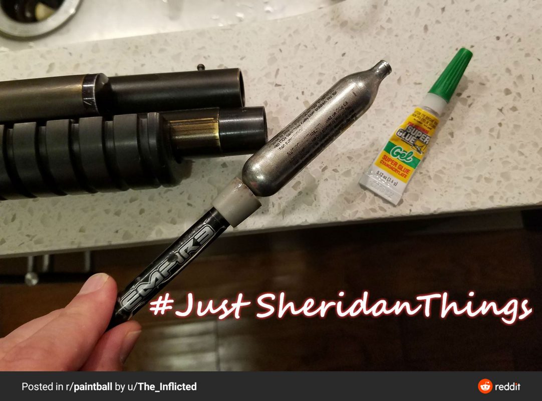

      As for removing a stuck cartridge, my go-to has usually been super-glue and a stick of some sort.
              O, I totally forgot to mention, remove that plug right in front of the frame and you can usually sick a wrench or screwdriver through it to knock the cartridge lose and get it out because it lines up right where the cartridge is necking down
