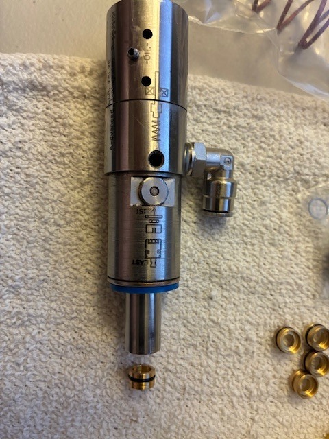

    Installing a Level 10 on a classic valve and am having some issues. The black O-ring on the bolt carrier causes the carrier to get jammed in the power tube, making the bolt carrier near impossible to remove. Is this a normal problem? Does the black O-ring need to be broken in? Do I just jam it in (insert anime woman gif here)? Is it my power tube? I checked the install thread and couldn't find answers. Any help is appreciated, thanks!

    They can occasionally be tight. make sure the carrier oring faces the rear of the valve when installed.

      Got it, appreciate the help!

    I use the field strip screw to pull it back out of the powertube.
