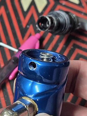

    I am looking at getting an inline reg that is known to have a bad cup seal. Where can I find a new one as well as info for what orings I will need.
    This gallery has 3 photos.

    If this is the same reg (in a different housing), then there's not really a cup seal. Just a bunch of o-rings.
    https://www.zdspb.com/tech/mguide/re...n_nextreg.html
