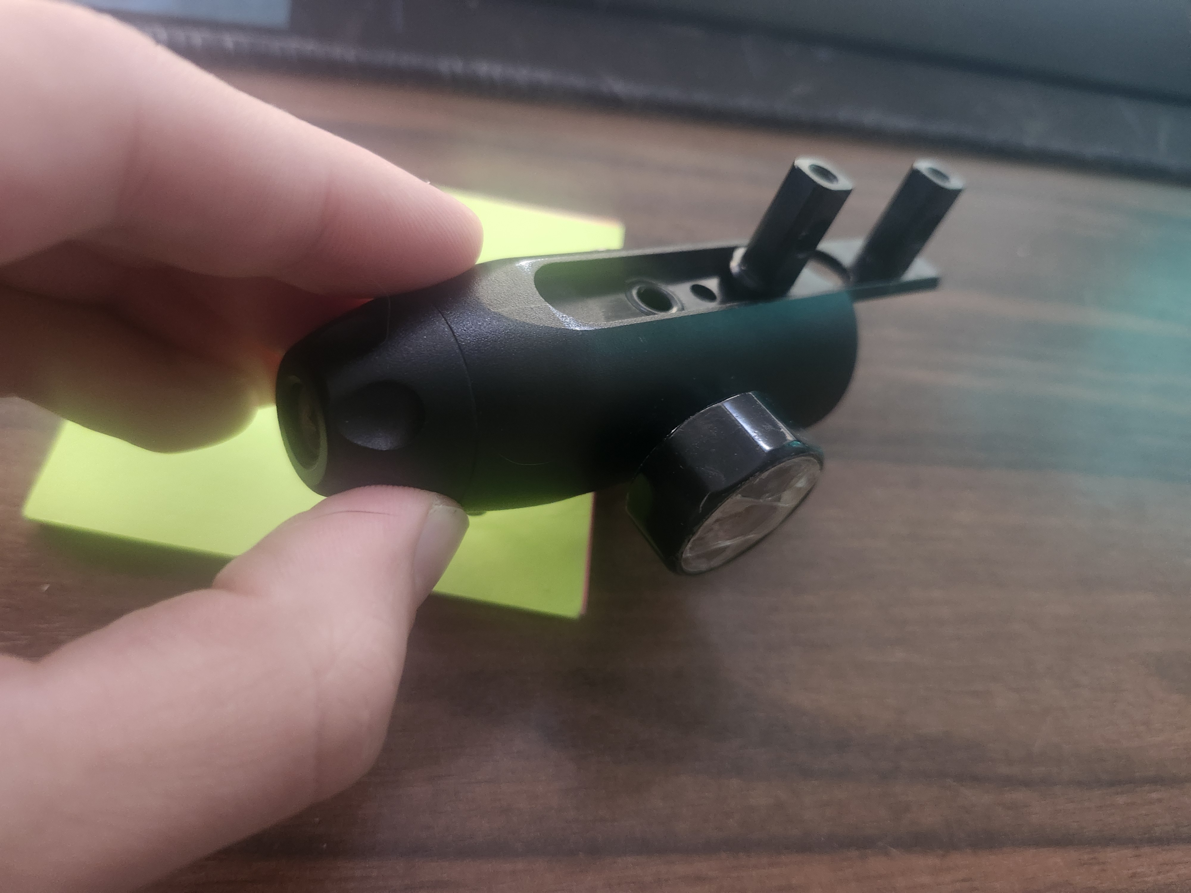

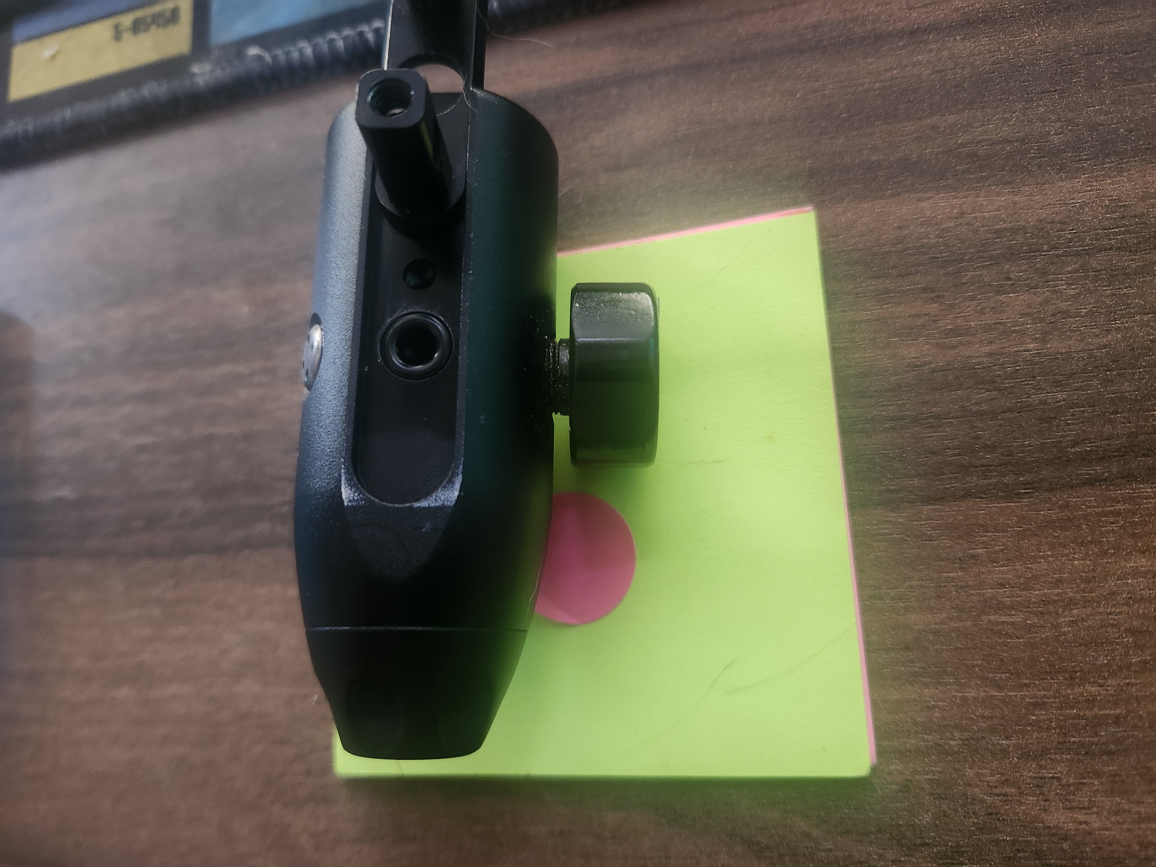

    Hello! I've been getting a lot of excellent advice on MCB lately so here's my latest question.
    I picked up an old Empire Relay ASA/Regulator to get my BT TM7 running again.
    Current situation:
    • No idea if the reg has ever been serviced
    • Internal O-rings are likely 10+ years old
    • I’ll test it once my adapter arrives, but I don’t expect it to work as-is

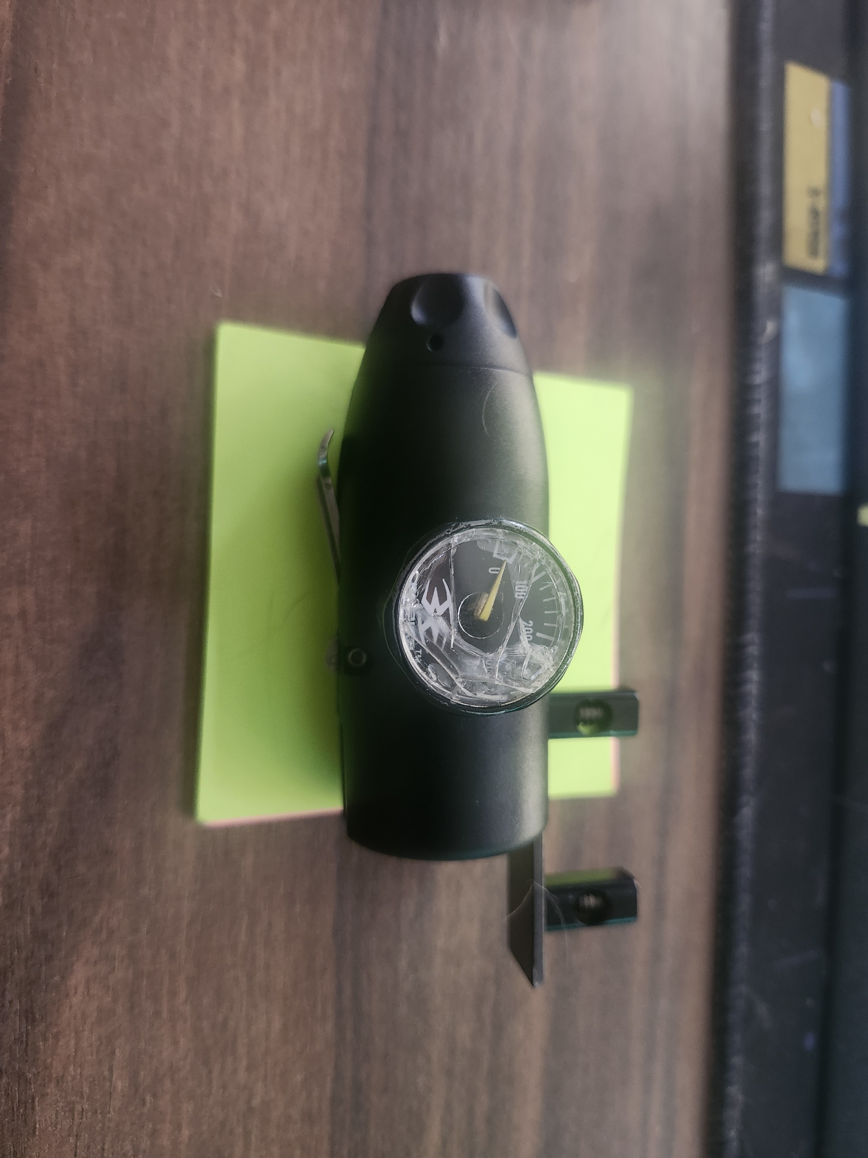

    • The pressure gauge is shattered, and I have a new Empire gauge ready to install
    Concern:
    Empire sometimes uses red Loctite on these regs
    I’ve damaged threads before trying to remove Loctited parts
    Questions:
    Best way to soften or defeat red Loctite without damaging threads? Any general tips for disassembling or rebuilding this regulator safely?
    Thanks in advance.​
