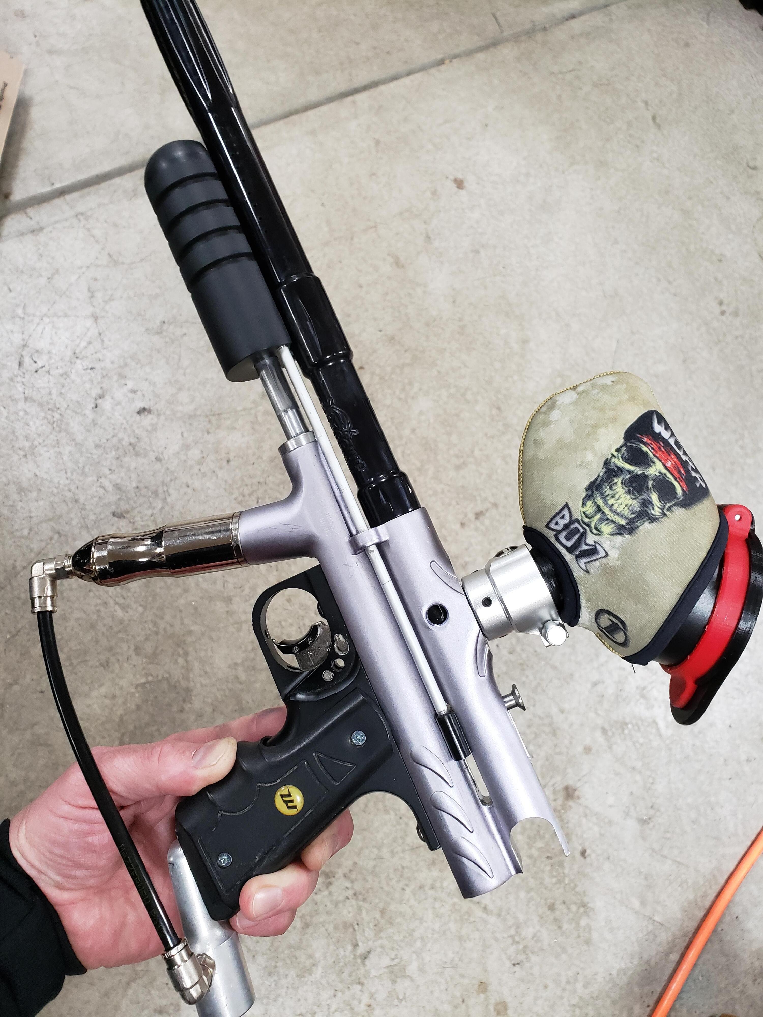

                BMC Fabrication did mine. Also turned it into a mid-block while he had it for me.
                If you want to send him a barrel or 5, he does freak boring too.
                He just got a legit website up and running, so you can check it out here:
                https://www.bmcfabricationservice.com/
