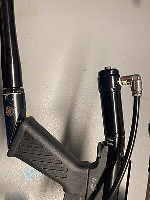

    I recently saw what appeared to be a regulator screwed into the back of a nelson based pump. What is the purposes of this? Does it help?
    • 4456
    Regulating air pressure.... Basically another point of velocity adjustment albeit a limited one
    • automeister
      automeister commented
      Would any HPA regulator work?
    • 6401
    You can regulate Phantoms if you want but you need to find one that operates at higher pressure. Phantoms like high pressure. (800-850psi on stock silver springs)
    They work fine without. However you can run one of you want.
    CCI made one for the revolution but it works on a regular phantom. Palmers made a valve body with a built in stabilizer. Or you can just screw one into any phantom ASA option.

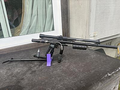

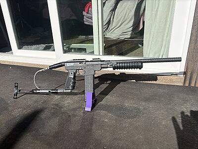

      I run a phantom and a Hammer7 with regs and 12ies.
      I can see better consistency in both markers compared to rawdogging 12ies. Efficiency is a little worse, but in my climate it doesn’t matter much.
      It also lets you run a lighter mainspring for easy pumping, and a quieter shot signature.
      As a bonus my phantom sidestab lets me set velocity without a 3’ long allen key

          Palmers sidestab on the phantom, wgp sledge on the hammer7.
          Both set at 550psi, stock springs in the hammer7 and both light springs in the phantom.
