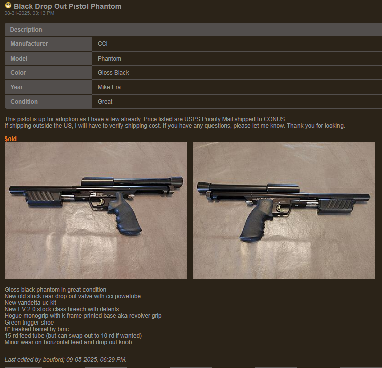

    Feedback!: https://www.mcarterbrown.com/forum/b...rough-feedback
    • DieManInTheRough
      Loooongtime Lurker
      • Apr 2023
      • 254
      • PeNsAcOlA,Fl, or Hell
      $L!mBo This is one of the only ones ive ever seen. ^

            Look like 3d printed
            The issue with the profile is the center section holding the grip is somewhat thin for the weight the the marker. I have seen several 3d printed kframe for sheridan break. Your best bet would be to model the part and test fit with 3d print and then have someone making a run in aluminum.
            I have a 3d model that could be used but will need modification, let me see if I can pull some measurement from it. But my model is for round but grip or square conversion grip.

              It was 3d printed
            • 6276

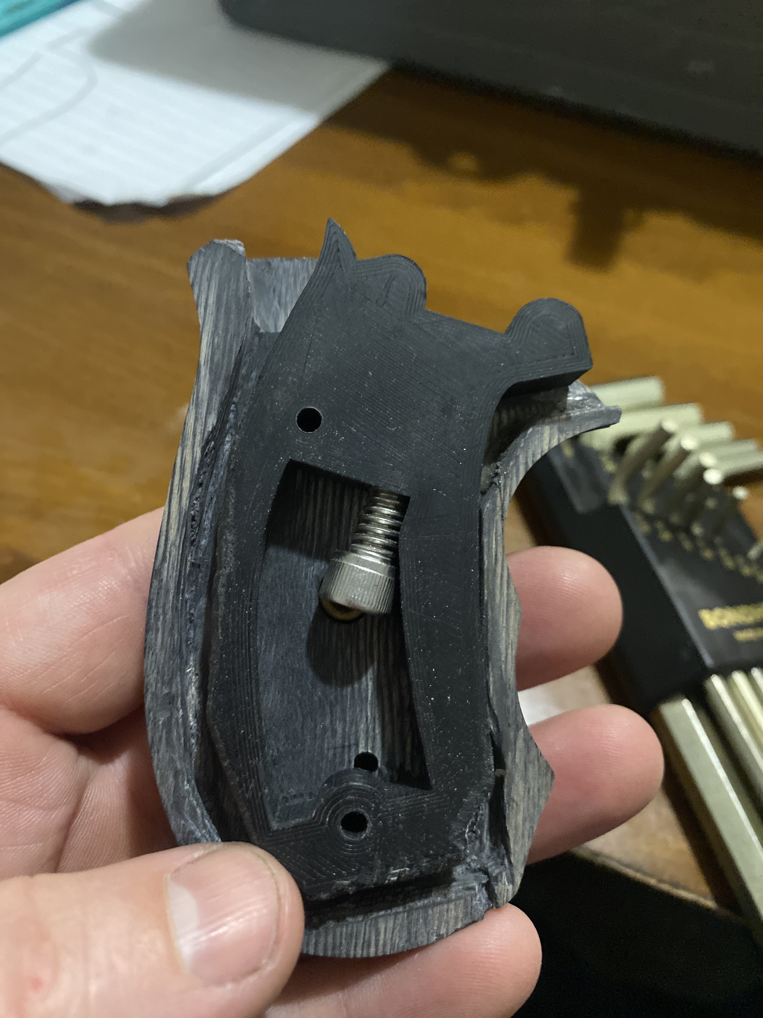

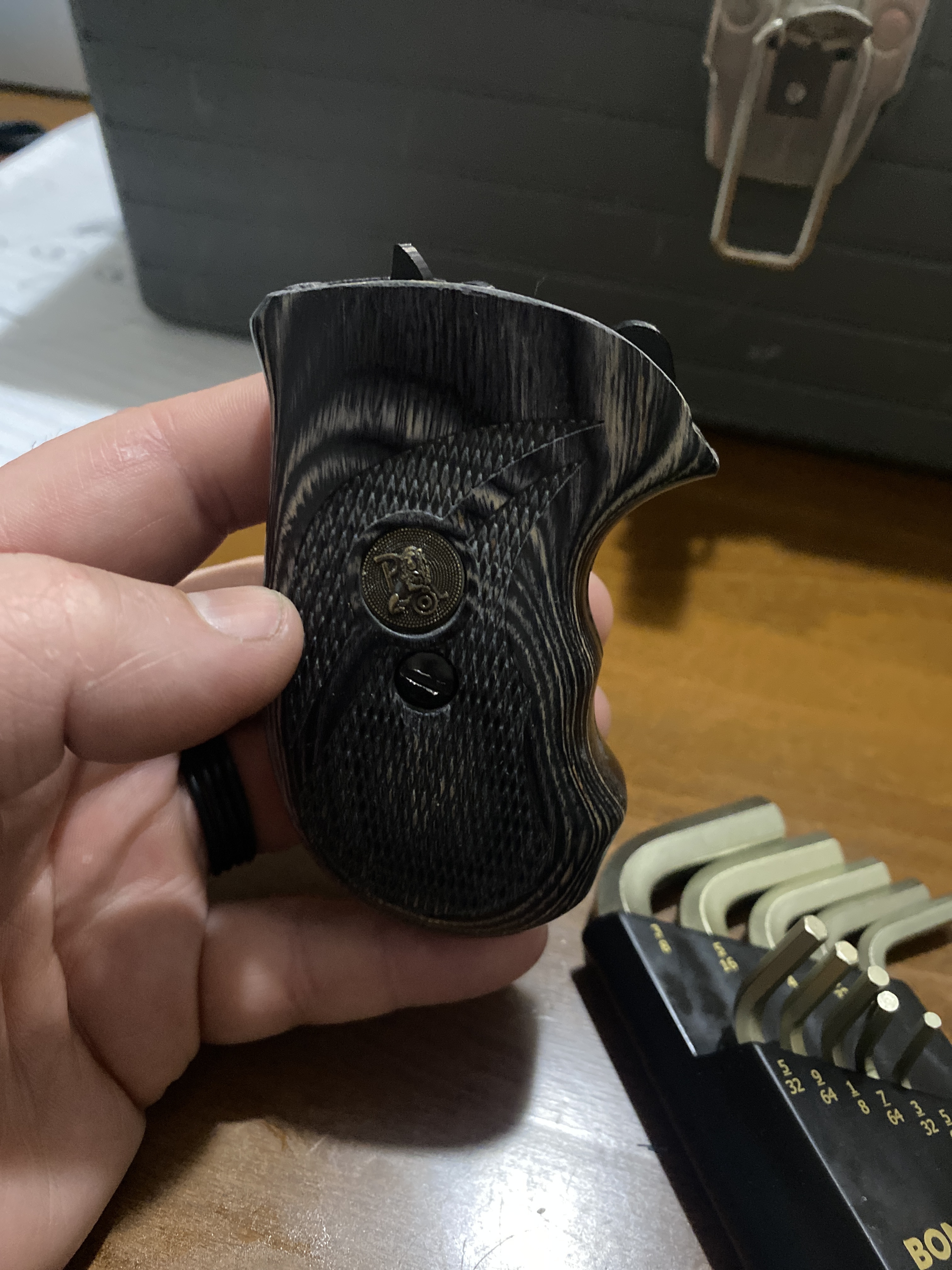

            It was definitely 3D printed. I have one in the parts bin with some wood grips I modified to fit (if I didn’t already give it away) They weren’t exactly bolt on.

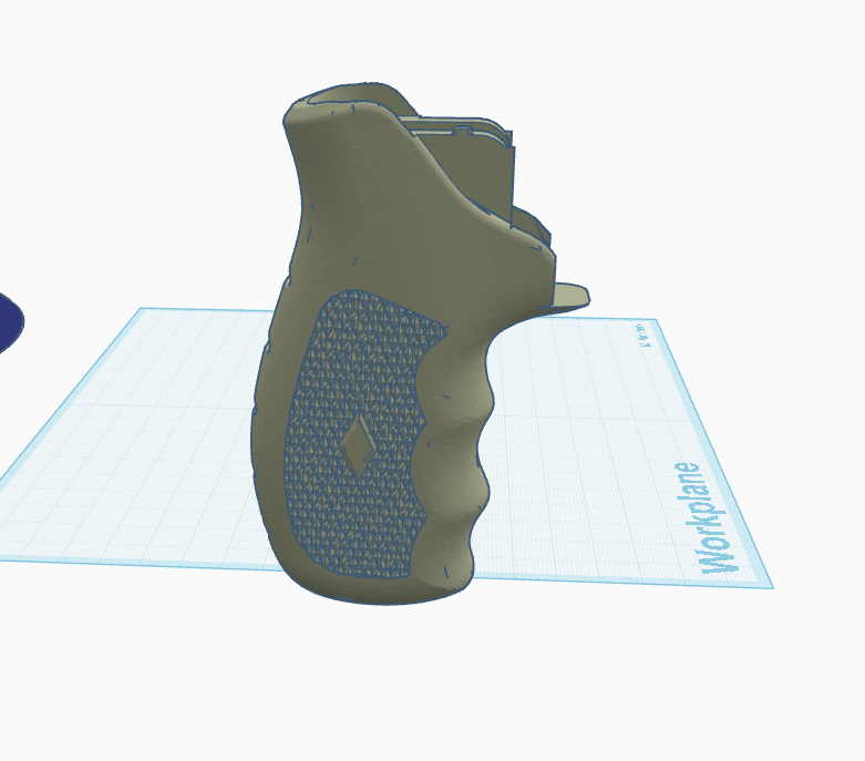

ID:	800888​I took a crack at it. Setting up a new machine so test print is a ways out.

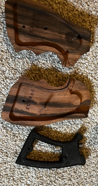

                  I modified it to fit the grips I have.
