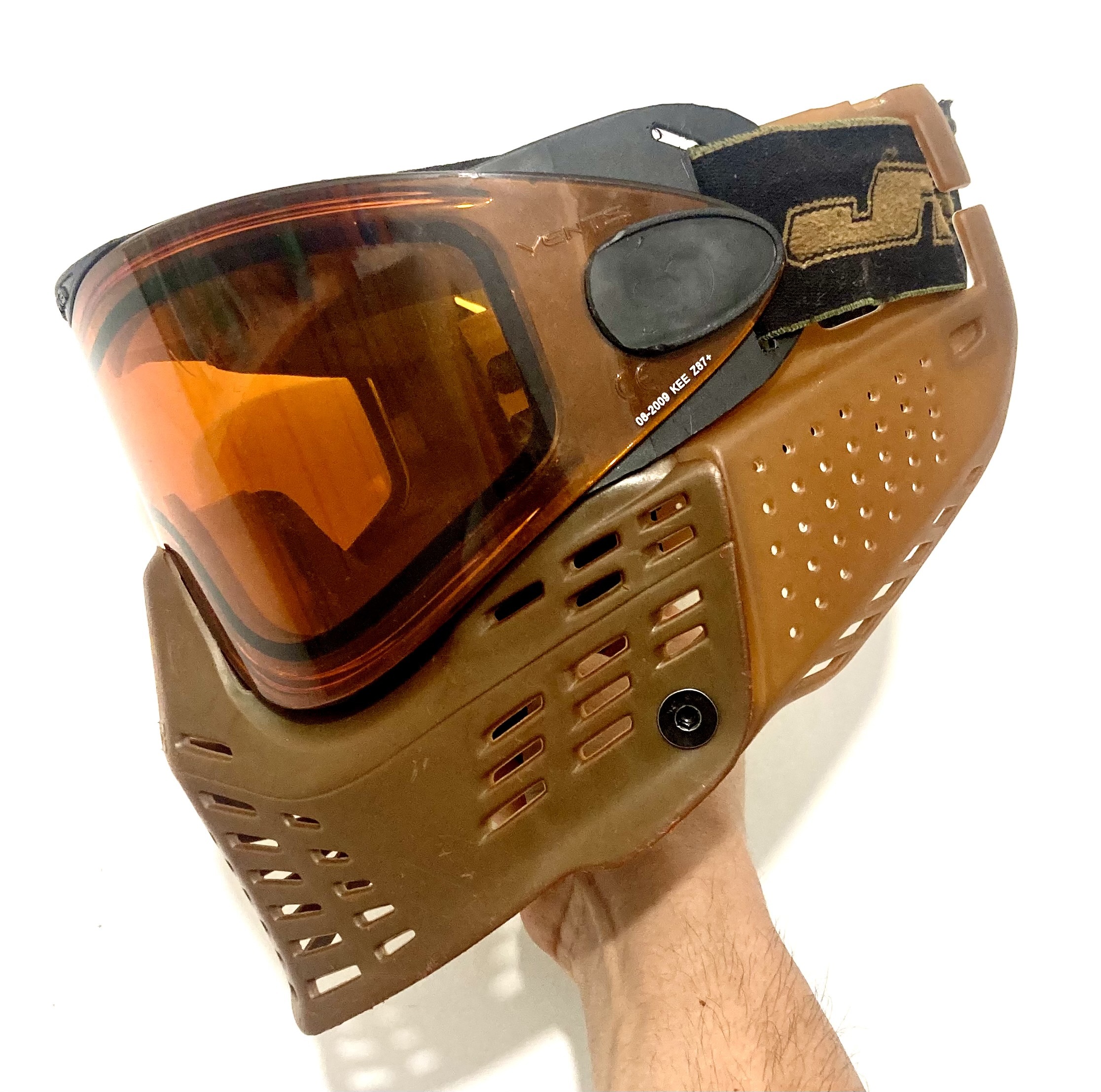

      heres some olives i was able to get pretty close to the ize nose brown. most folks use scarlet, but i got this shade by using Jacquard basic yellow, then RiT orange,
      then a tiny bit of red. i just kept adding the colors to the same pot without fresh water inbetween dunks. And i didnt measure anything either, for maximum diy iq points
