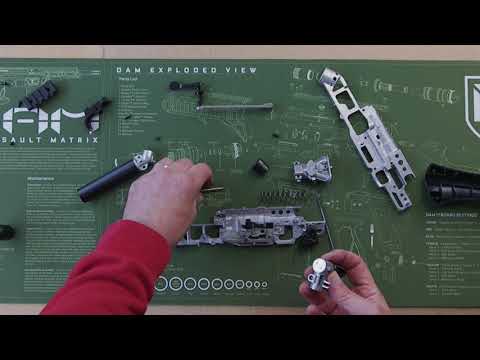

    I've got one but, I've not needed to do this yet..
    Carp 's Feedback
    • shadow191
      shadow191 commented
      Thanks for this, helps in understanding. I've worked on usual stuff like blowbacks, cockers, and modern stuff where it is mostly just o-rings. When the Umarex started leaking, I realized I had no idea how it worked.
