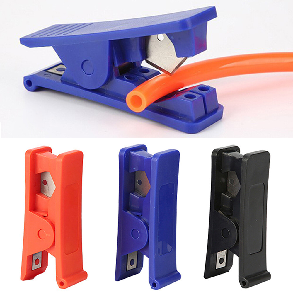

        I picked up a 3 pack of these on amazon for like 5 bucks, still using first one

        • Buff_phroggie
          Buff_phroggie commented
          These are the best way to do it. Im fortunate to "find" them at work
