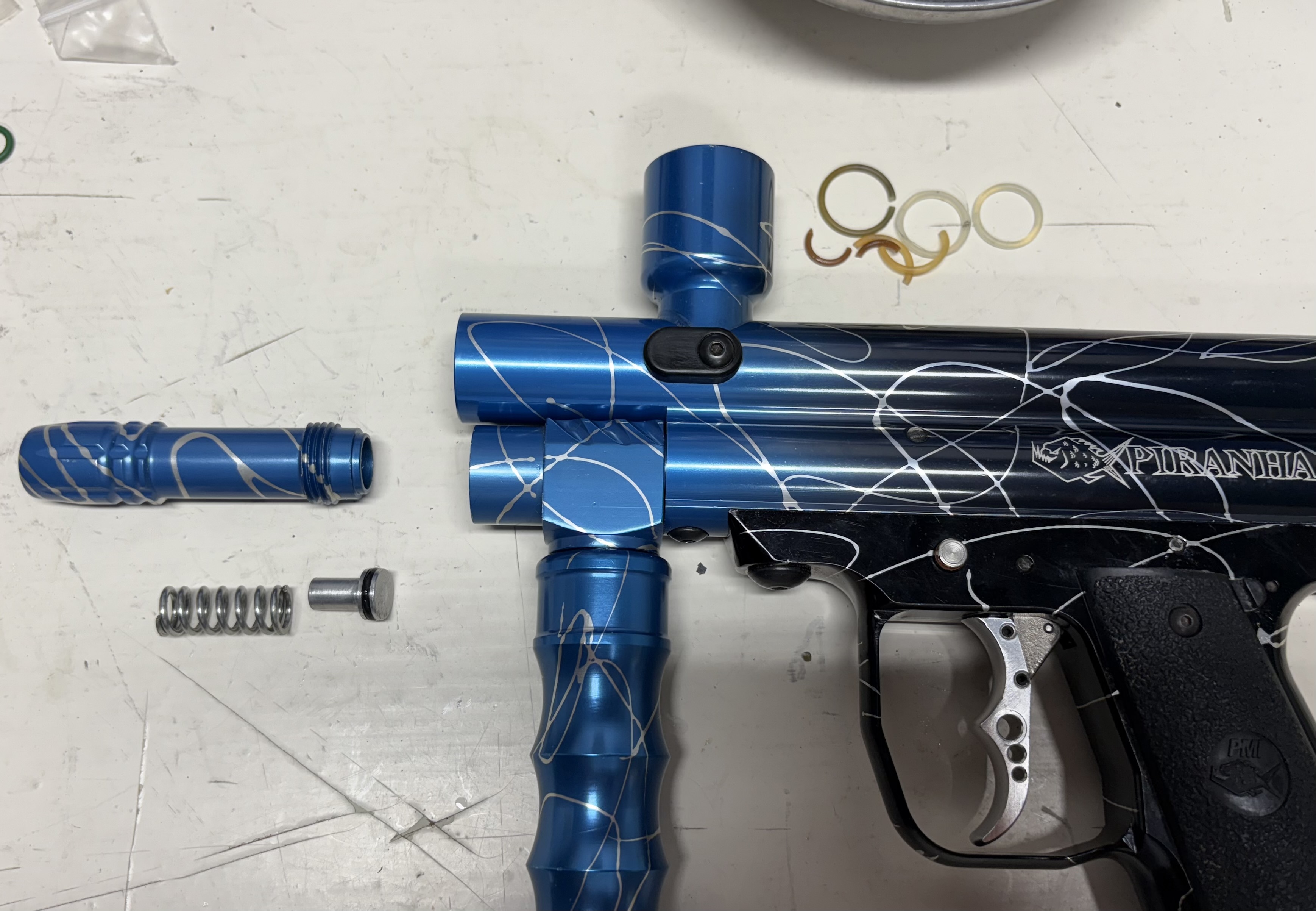

    Hello McB community,
    Is the stiker oring the same as Spyder? Usually I can get away with a bottle oring (nitrile) on a Spyder but not in this case.
    Is the active volumizer positioned correctly, I can’t recall if the spring goes on the piston closer to the main body or opposite.
    thanks
    • 6185
    015 o ring for the hammer, same as a spyder but the hammer itself is actually larger so you can't swap them
    The real orientation of the parts you have there is you throw the spring and piston in the trash as long as there's no hole in the front of the volumizer.
    But from the factory that's correct

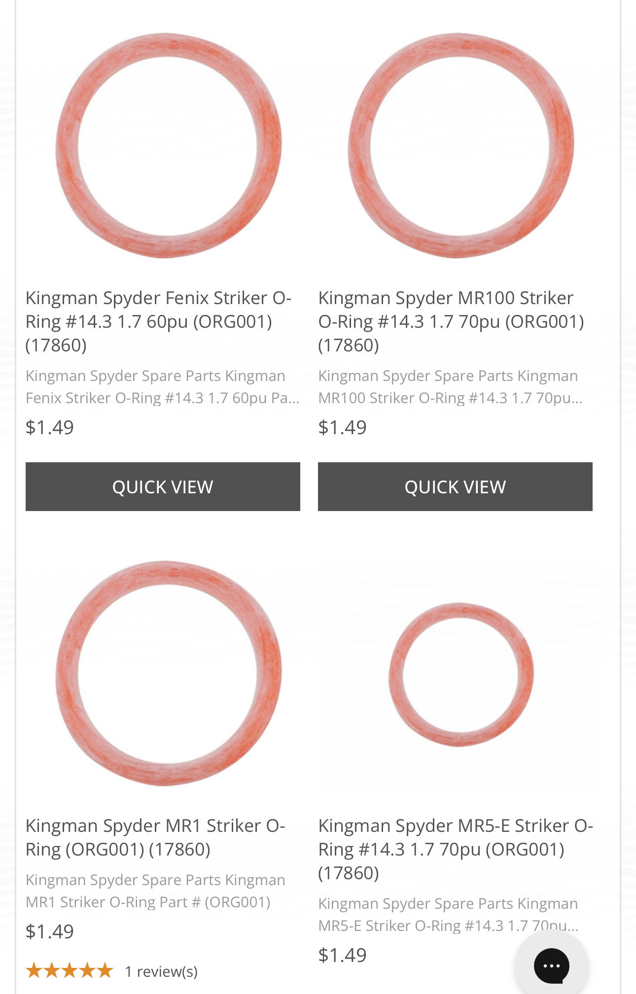

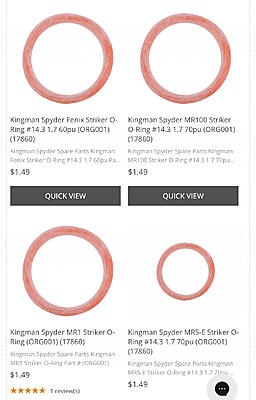

      Thanks for the help. My candidate will be this #15 at ANS.
      I was about to order every “striker oring” and these are funny #14.3 size with different “pu” rating.
