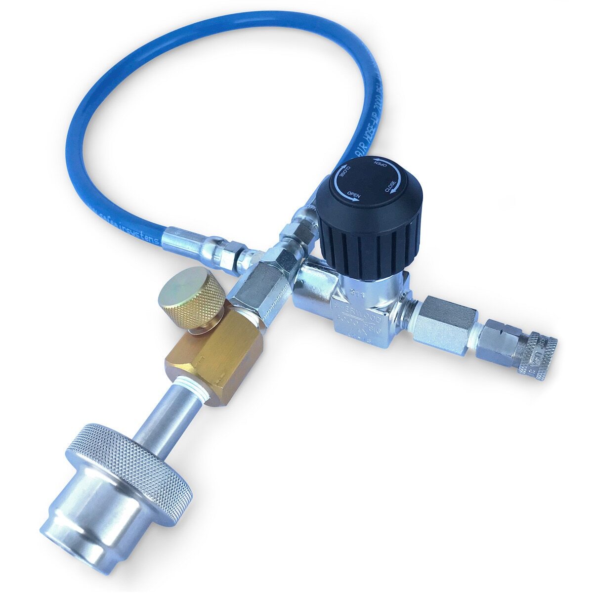

                            You need a CGA347 Male adapter to take your SCBA valve output to build a paintball fill rig. Not a huge deal to cobble together. I was using one for a while until it ran out of life, but now I have a compressor, so I have not picked one up again, though I have thought about it.
                            Here is an example that is made to go from CGA347 Male to paintball (not what I have I built mine) https://www.safeairsystems.com/91-SCBA-PB-CGA347-SCBA-Male-to-Paintball-QC-Fill-Adapter
                            Click image for larger version  Name:	91-SCBA-PB_01.jpg?resizeid=15&amp;resizeh=1200&amp;resizew=1200.jpg Views:	0 Size:	104.8 KB ID:	812757
