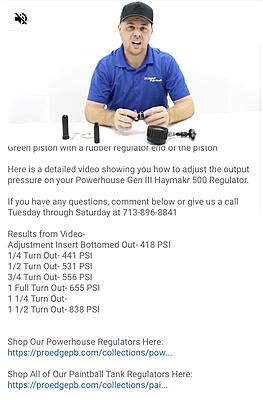

    Keep in mind the PH 4.5k reg is a little bit lower output pressure then you want to run on the Phantom. You would need to switch springs on your Phantom to run at a lower pressure. Or set the PH reg to 800-825psi in that case your Phantom will work on HPA, C02 and 12G with the stock silver springs. I recommend getting a dedicated tank reg for the phantom they operate best @825psi something that’s a little high for most other markers. I run a cheap 3k Gorilla air reg on mine that’s shimmed up to 825. It only adds approx 1/2” in length.

      Setting the PH reg is pretty straightforward, here’s a cheat sheet. Looks like 1.5 turns out for the pressure you’re looking for.
