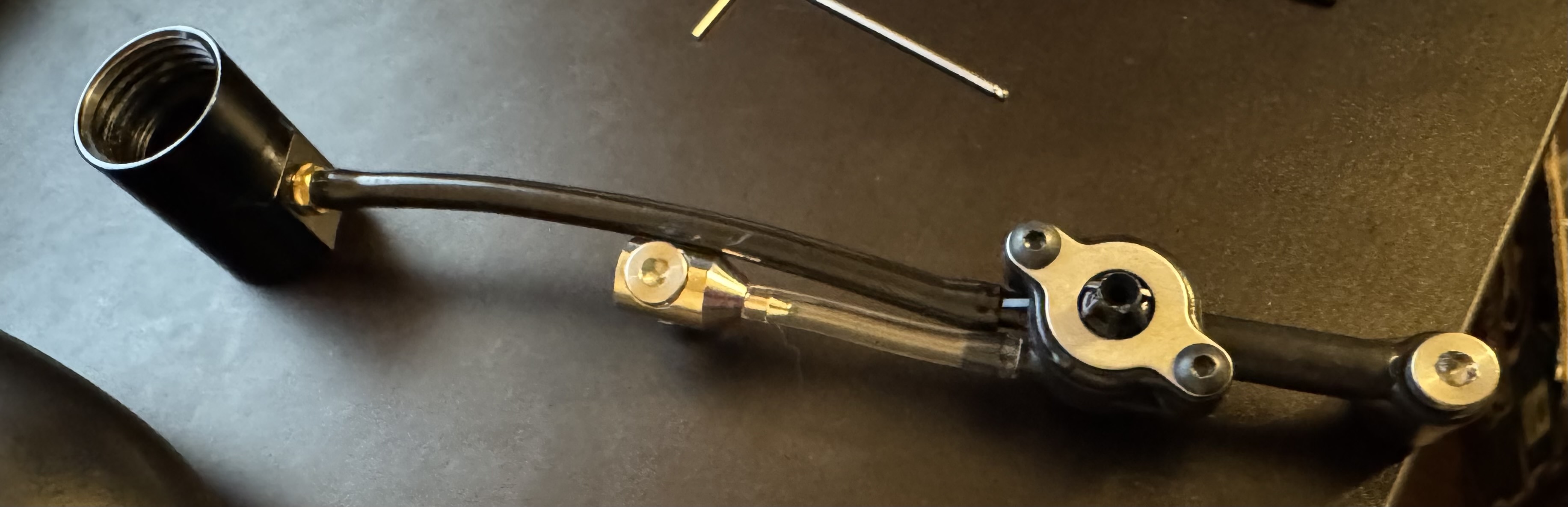

        • JoeSchitt
          • Sep 2023
          • 59
          Pic of valve assembly.
          Click image for larger version  Name:	IMG_4144.jpg Views:	0 Size:	506.2 KB ID:	817846
          • Calvin
            Calvin commented
            That valve is beautiful. No rust or dried paint. How could it leak? 🤪

          Got her all fixed up and will be headed off to a new home! It ended up being a leak on the banjo line running from the QEV to the HE valve. I diagnosed this by airing up the marker with the gun halfway disassembled (to where I could see/hear valve assembly while gassed up).
          Replaced the line, gave it a fresh set of o rings on the bolt (some were tattered) and she’s ripping!
