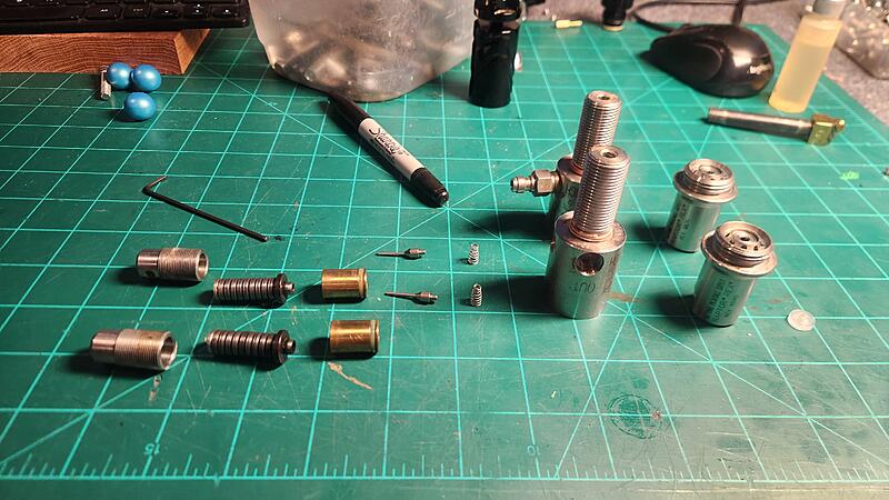

    I picked up a couple Raptor Rex regs from a parts bin at my local field. I have them broken down and have a few questions I hope more experienced members can answer.
    1.) Are the pistons the same as Mag pistons? I know the safety seals inside will need to be flipped, but I have a couple brand new mag pistons that I hope could be used instead.
    2.) Are these the same reg seats as a mag? If so, I have plenty of new ones.
    3.) Can I use a Buna Oring to seal the body halves as I am doing on Mag bodies right now?
    4.)One of the pins is bent. Is it acceptable to attempt to straighten it, or should I accept the L and just get one running?
    5.) Burst discs and bodies: I want to run the bodiea in the ultrasonic cleaner. Can I do that with the burst discs in place? aif I have to remove them, are the ruined? I assume they are red loctited in there.
    6.) Guages: I assume any modern 4500 guage will fit??
    7.) Cradles/Drops: Does anyone have 1 or two they would part with?
    Thanks!

    My recolection is if using mag pins you eed mag seats.

      They’re not the same as mags, neither are the pins. Immortal Air makes new replacements though. It’s run by the old Air America people.
      • Calvin
        Calvin commented
        Great tip! They aren't that far from me either. I will call them in the morning. Thank you!!!
