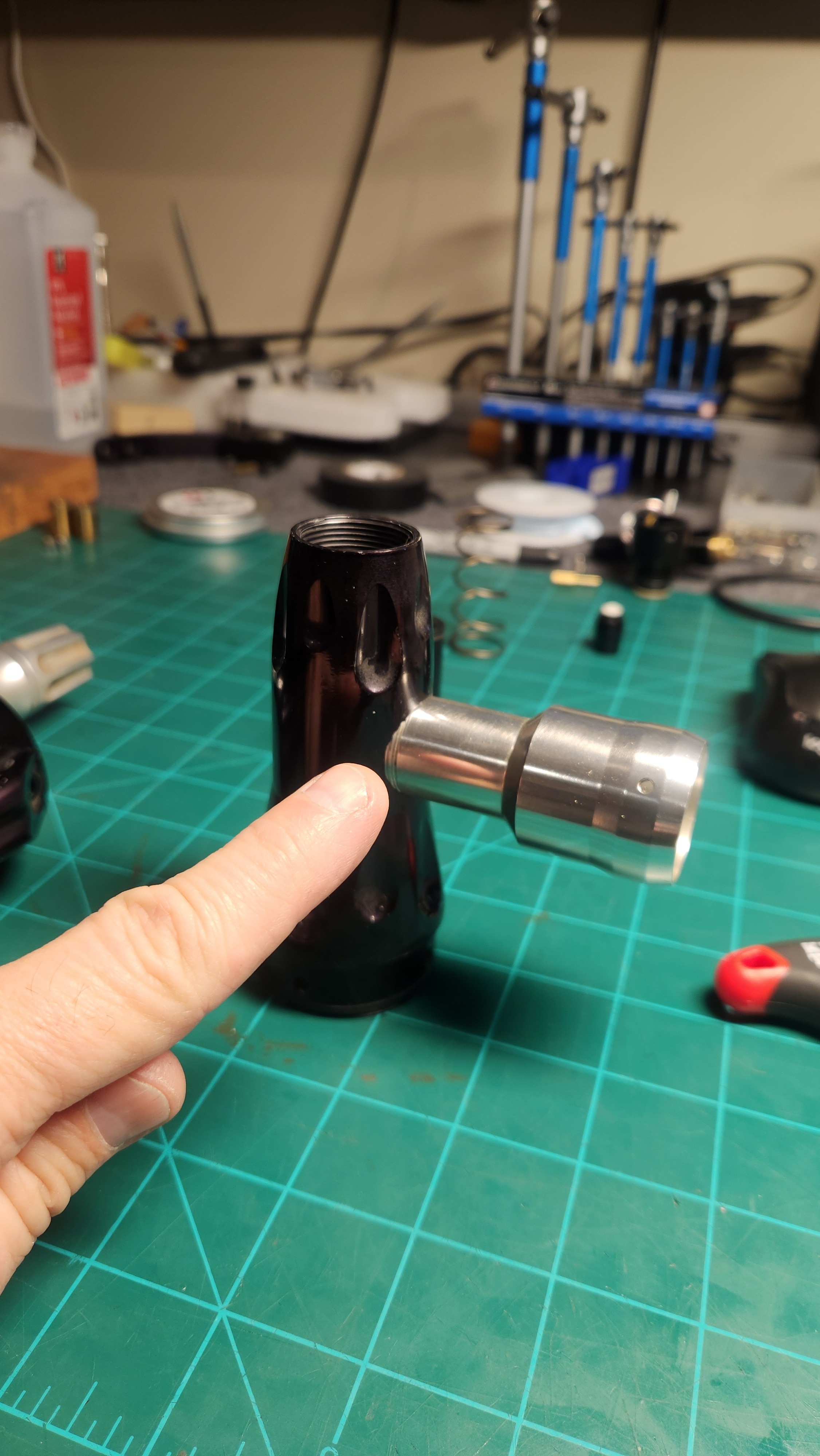

    Does anyone know what the War Machine Assault 80 feedneck threading is???

    If you are trying to get that lower or use a empire feedneck, i am sure it can be cut easily to fit if you want to got that route.
    7/8"-27 UN
    Per this https://www.zdspb.com/tech/misc/cadf...feednecks.html

      Holy shit, superman You found the spec!!! Am I correct in reading that no other marker shares that threading?

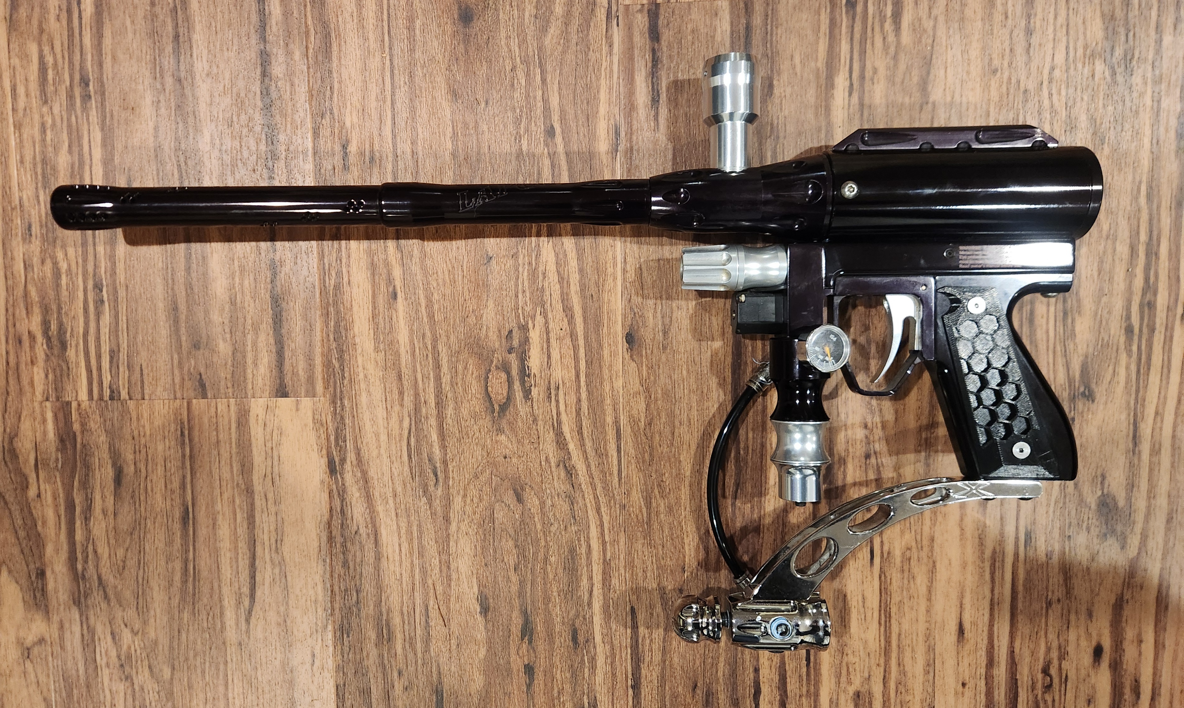

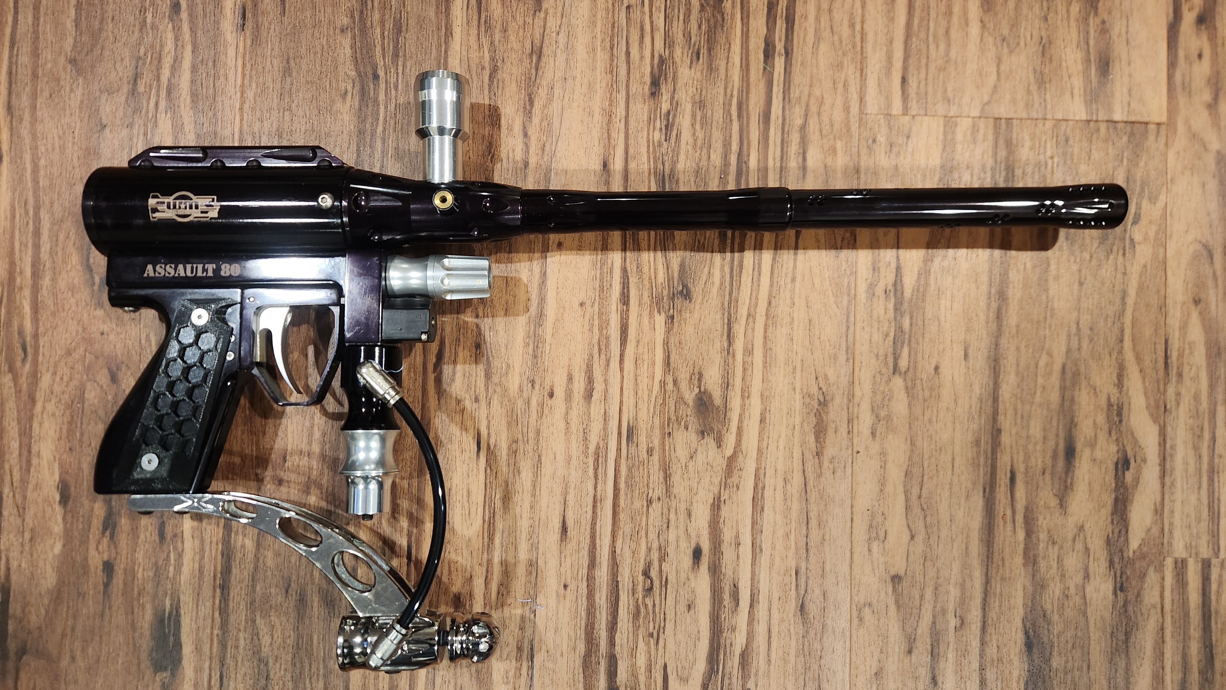

      The Assault 80 lets you choose between 90 left, 90 right, or vert feed. What I want to do is use my same feed I am making for my warpfeed left mag body on this. I would chop this feedneck down to make it if the marker wasn't so rare. It's in such good shape that I feel like non-destructive modding is how it has to be. Could you make such a tube that I could purchase from you?
      I just got all the seals changed and she is chugging away. I plan on chronoing in tomorrow. If its shooting to speed, I'm definitely going to use it, just to see the looks of confusion on people's faces.
      It came with hogue wrap arounds. The grip is already huge so I put some thinner panels on there. Much more manageable now.

        Potentially. Do you have a set of calipers?

          Absolutely. What do you need measured?
