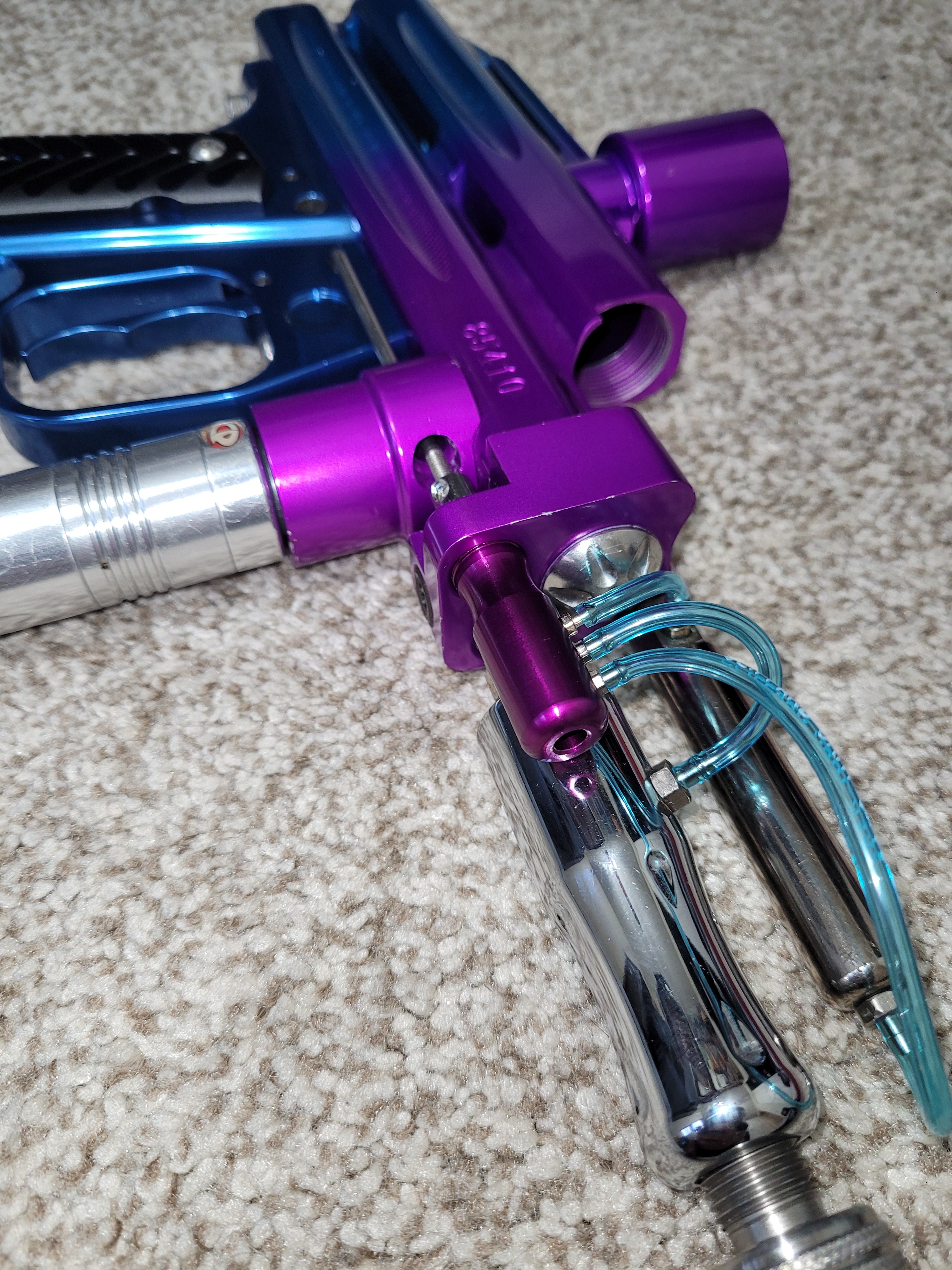

    Edit, adding photo of my current pain in my ass 3-way. Really want this to work for the color match but damn if I'm not about to say screw it and throw a bomb 3 way on and be done 🤣
    EDIT - I got this one working! I tried a few things but ultimately replaced 1 of the o-rings on the shaft and wiped most of the lube off and suddenly its running leak-free. So either I had a bad oring or it didn't like the grease, lol.
    From all the feedback it sounds like 3-ways are just finicky in general. I'm gonna need to play with o-rings/lube and I now have a longer, more accurate, checklist of things to look at for troubleshooting.

    In my limited autococker experience, 3ways are usually on the cusp of leaking to minimize drag on the trigger. I'd bet you can add a couple wraps of Teflon tape to the oring glands to add a little extra compression to the orings to get them to seal.

    I've found that sometimes lubing the o-rings will make them leak and have a lot of drag. I don't know why, but that's how my trilogy worked. Might be worth cleaning everything off and trying it dry if you haven't already
