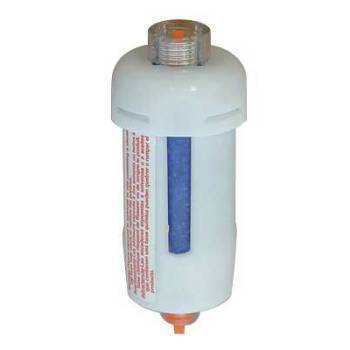

              The desiccant filter I'm talking about are those:
              The blue turns pink when they're spent/wet and you just replace the whole thing (~$10/each)
