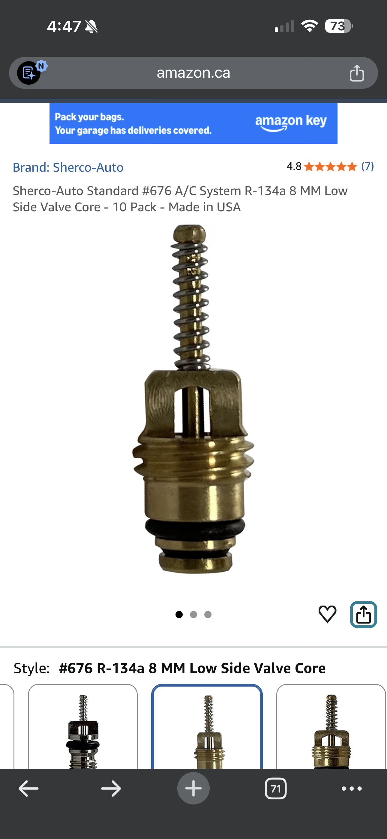

                    Oh , so with the velocity screw backed out all the way when I turn the air on I can still hear the reg charge, just very slowly , is that a sign the valve is toast? Is there anything I can do to maintain it ? Or basically when it’s toast it’s toast?
                    Can someone please verify this is the correct valve ?
                      • 6185
                      I can't say for certain since I've never ordered them like that but that does look like many of the BL schrader valves I've delt with in the past
