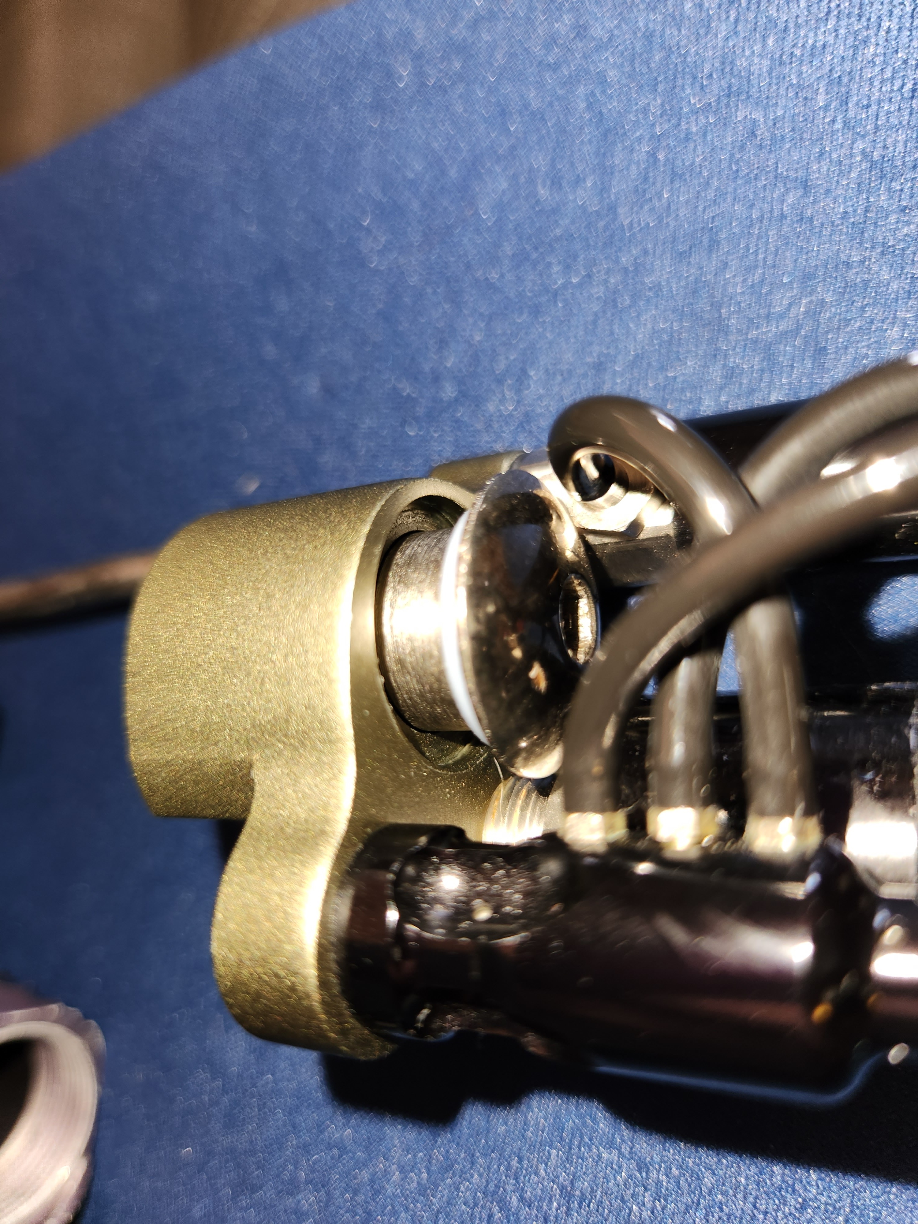

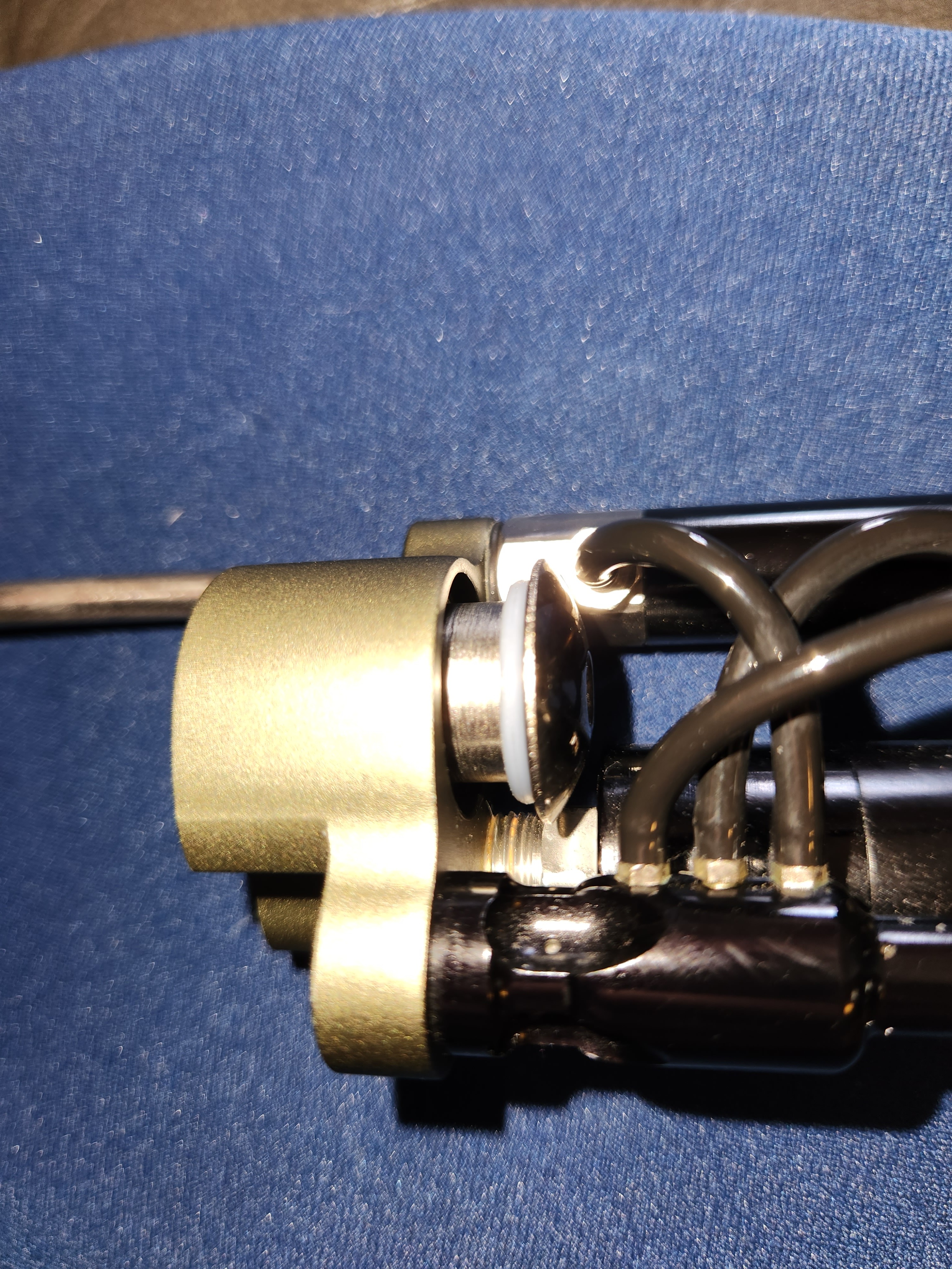

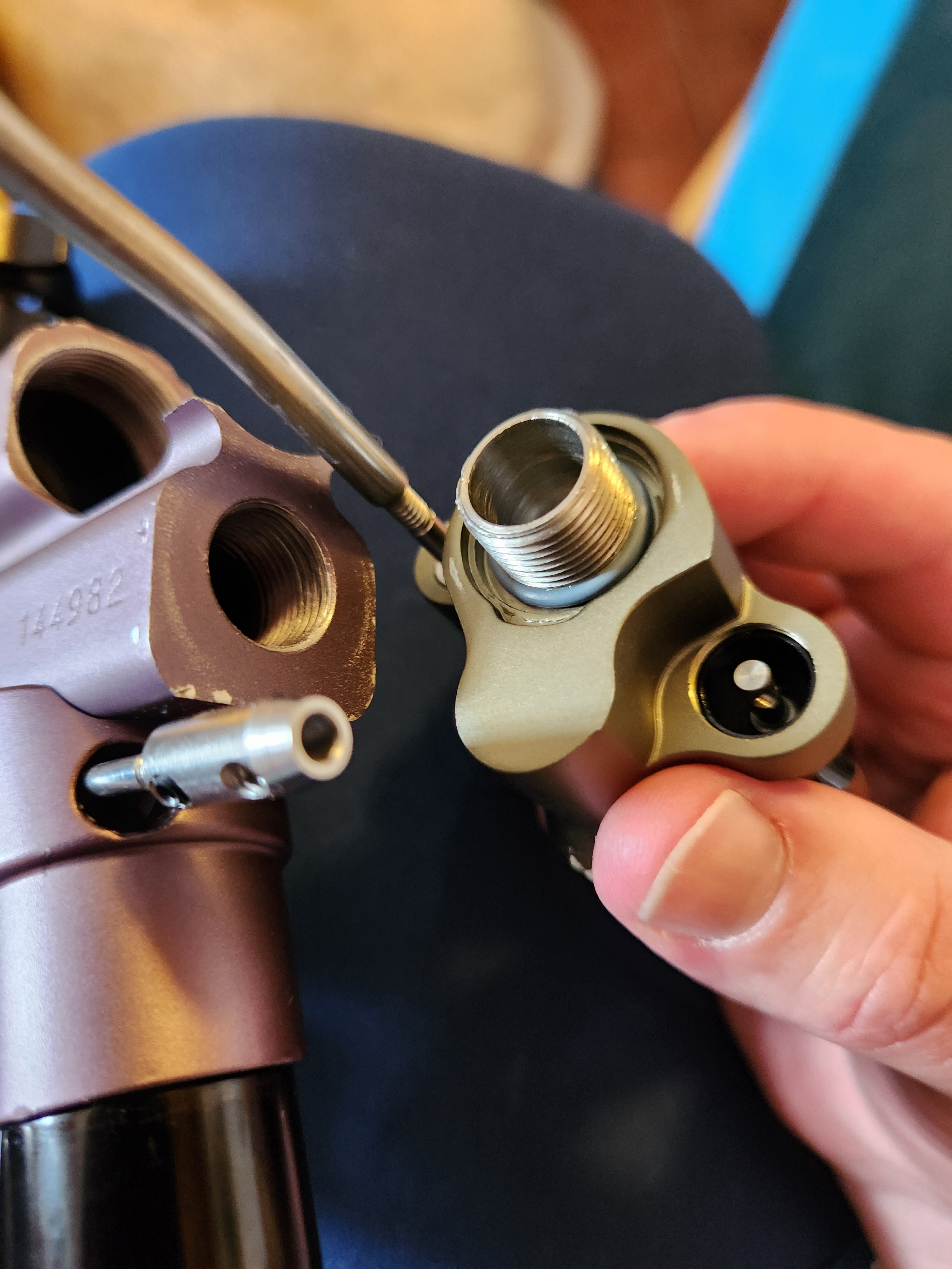

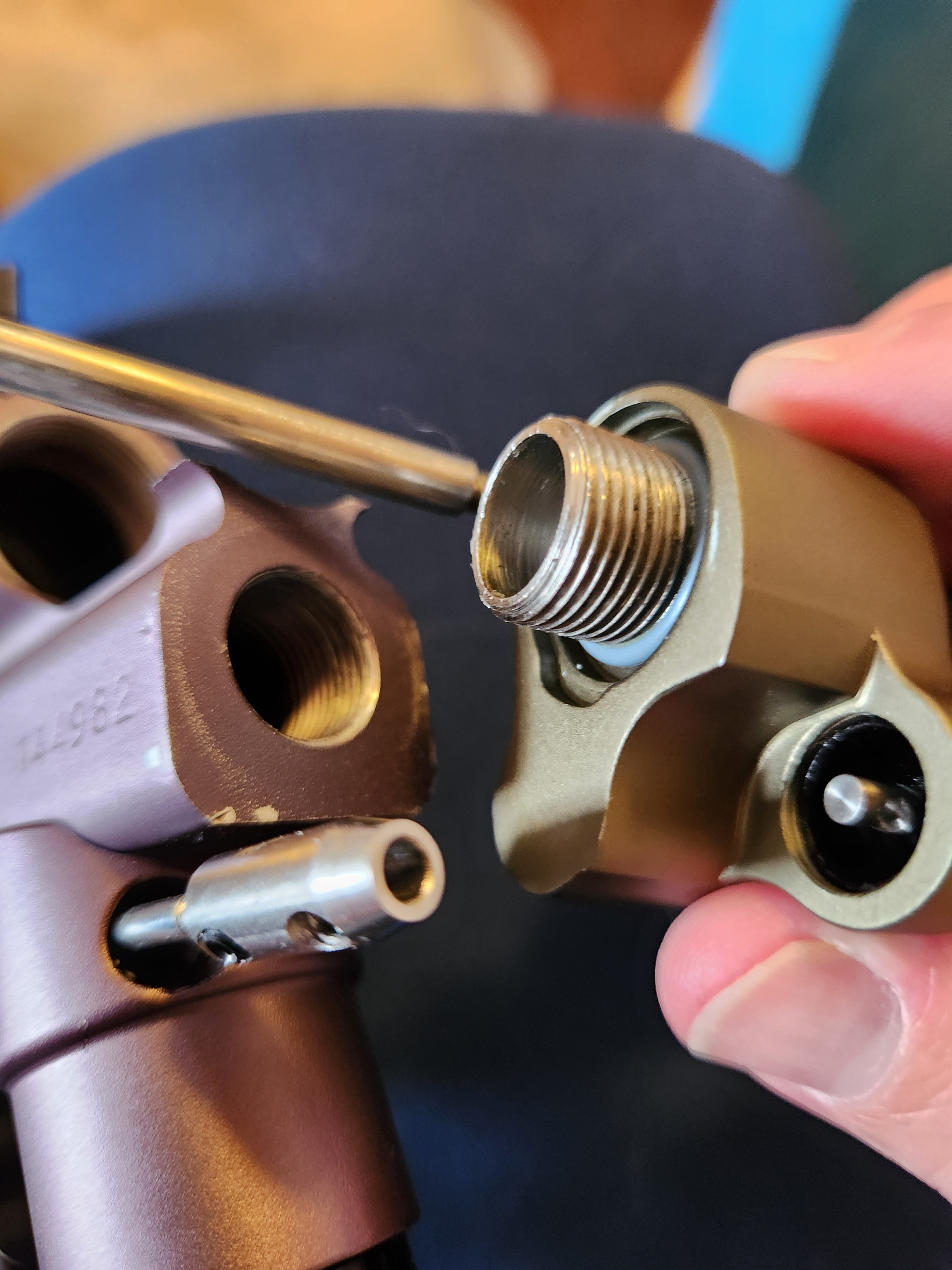

    I picked up this Black Magic a while ago and finally got around to looking at the significant leak from the shocktech front block. There's gotta be something missing, because there's no way these oring seal anything. Could it be a wrong block for the body, or does it take square cut orings? I'm not terribly familiar with cocker front ends yet.

    Trilogy King?
    • May 2025
    • 365
    • Central Iowa
    Wrong kind of front block unfortunatly. I believe that is a reserection front block.
    • Glovebox Operator
      • Sep 2025
      • 448
      • New Mexico
      That's what I was thinking. Needs a snout to get in there and seal.
        • 4456
        That's a later 05/karni style front block. Won't work with that body
        • Glovebox Operator
          • Sep 2025
          • 448
          • New Mexico
          So now I need to find a karni body.
            • 4456
            No, this is an 05 prostock block
            • Glovebox Operator
              • Sep 2025
              • 448
              • New Mexico
              Building a karnivor around this front block won't work? And just getting a prostock block for the BM?
                • 6185
                This is correct. It may also be a 05/06 black magic, I think they are cut the same but I'm not positive on that one.
                05 pro/super stock has a short snout, karnivor is the same shape but has a longer snout
                • Glovebox Operator
                  • Sep 2025
                  • 448
                  • New Mexico
                  Who makes a good proper front block to replace it?
                    • 4456
                    2k spec.
                    Basically everyone in the 2000's
                    • Real Dare Devil
                      • May 2026
                      • 3
                      Go on ebay and search autococker 2k front block for options.
                      • Glovebox Operator
                        • Sep 2025
                        • 448
                        • New Mexico
                        I think I'm going to send it to superman and have it worked over. I dont have time and air to mess with it these days.
