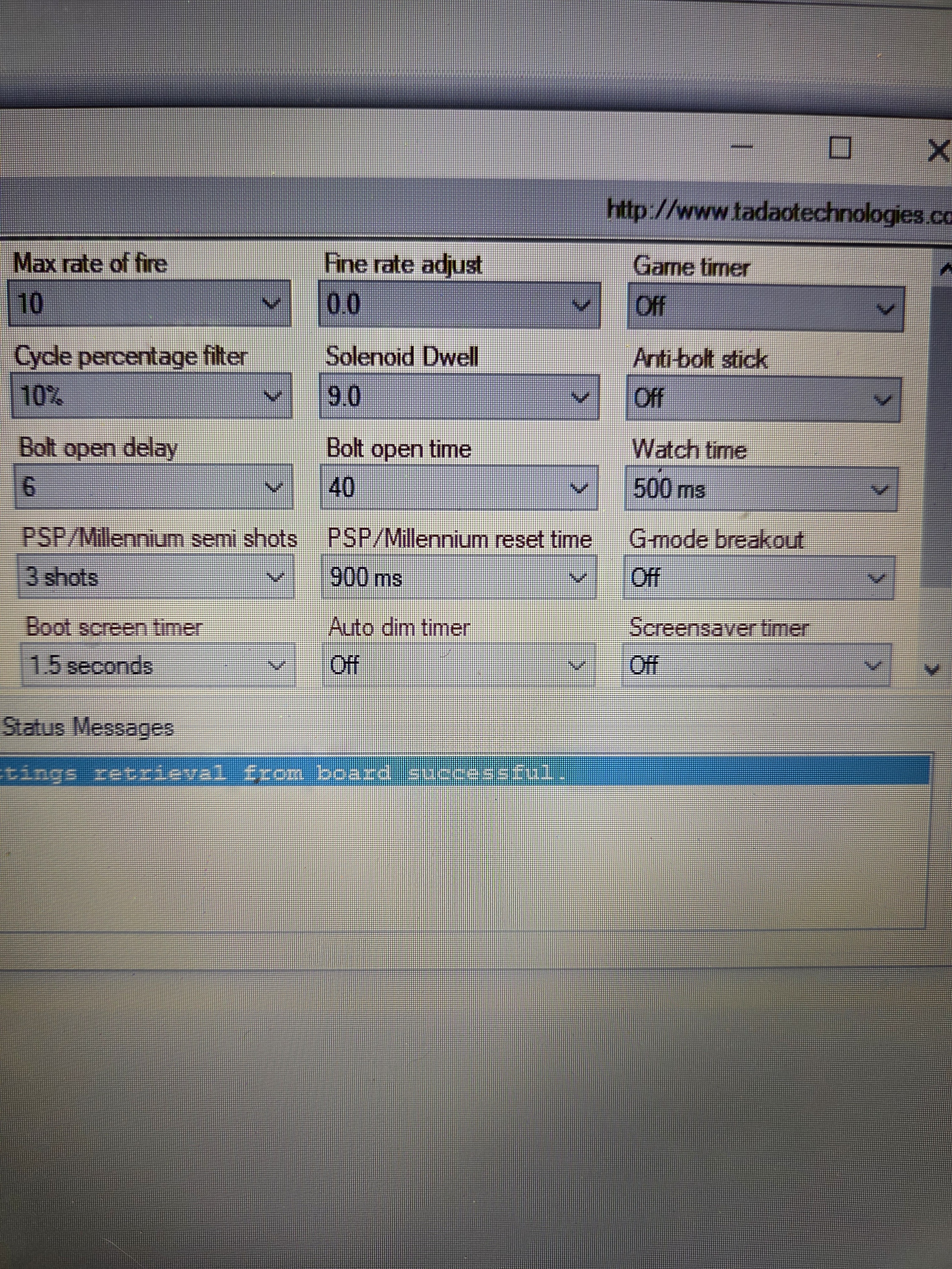

            I do not see those names as drop downs. Just solenoid dwell. Here is what it is currently at. I put it back to the default settings thinking it might be an issue there. But same issue.

              Thinking back and looking. I had a burnt out oled screen and converted to a led. Reading the literature from the tadao site it looks like the oled has the extra dwell setting but not the led.

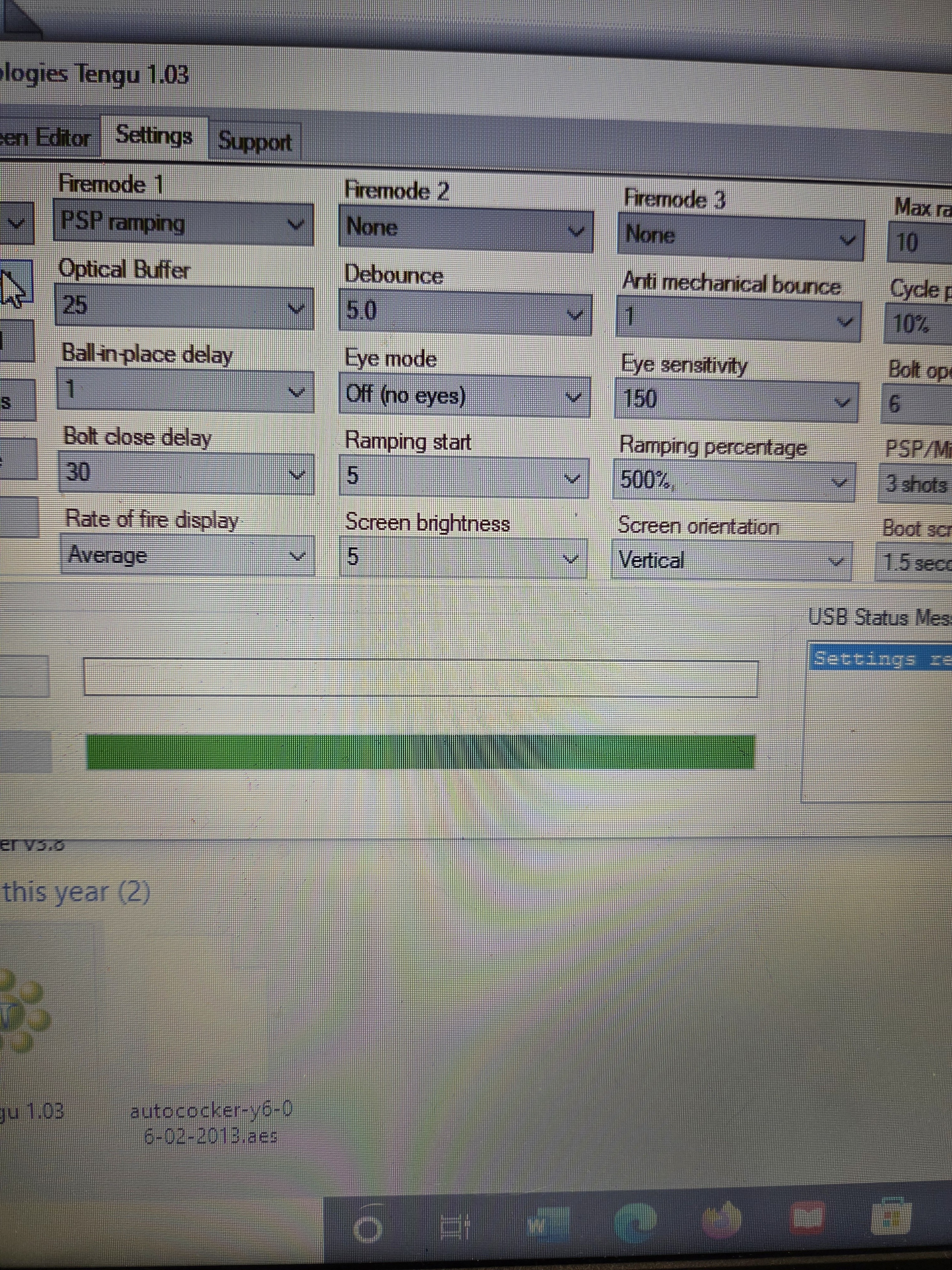

                I downloaded the oled software again and now the clapper sear works as it should but on the screen to modify the parameters it didn't change. The led still seems to be kinda working.

                    Looks that way I downloaded a new copy of the led firmware and uploaded it and everything is working as it should.
