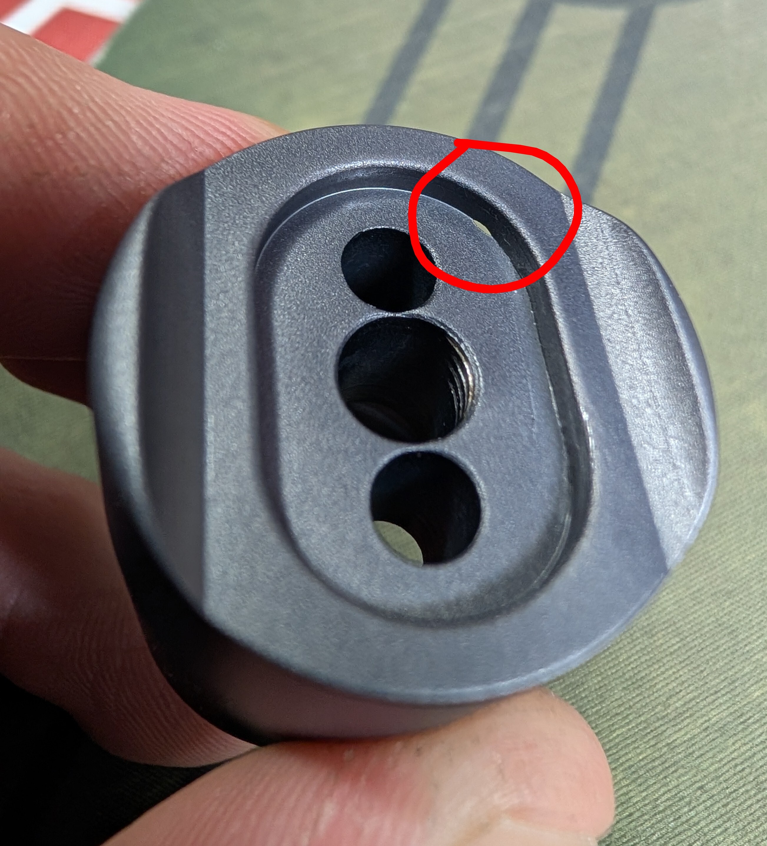

    I got this autococker VASA back from anodizing with an extra hole in it. Didn't notice it at first up until I tracked down where the gun was leaking from. I'd hate to scrap it since it's anodized to match my sniper. Any suggestions on how to plug the hole? Jb weld came to mind.
    Thanks

    I vote JB weld, anything else I can think of would require going back to anno ๐Ÿ‘Ž

      Are you using the right size oring? I would think that might still seal.

        Yes it's the correct size oring.

      I think I remember having a similar problem on a build years ago, I want to say I double stacked o rings in the vasa, took a slightly smaller one and put it inside the larger one in the vasa. Atleast worth a shot trying

        That did the trick! Thank you!

      I bet nicks suggestion would work with some Dow 55 when you got it in place probably wonโ€™t be an issue. Itโ€™s blown through at the timing rod slot?
