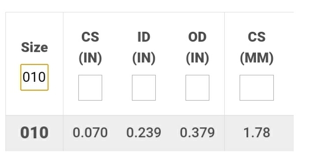

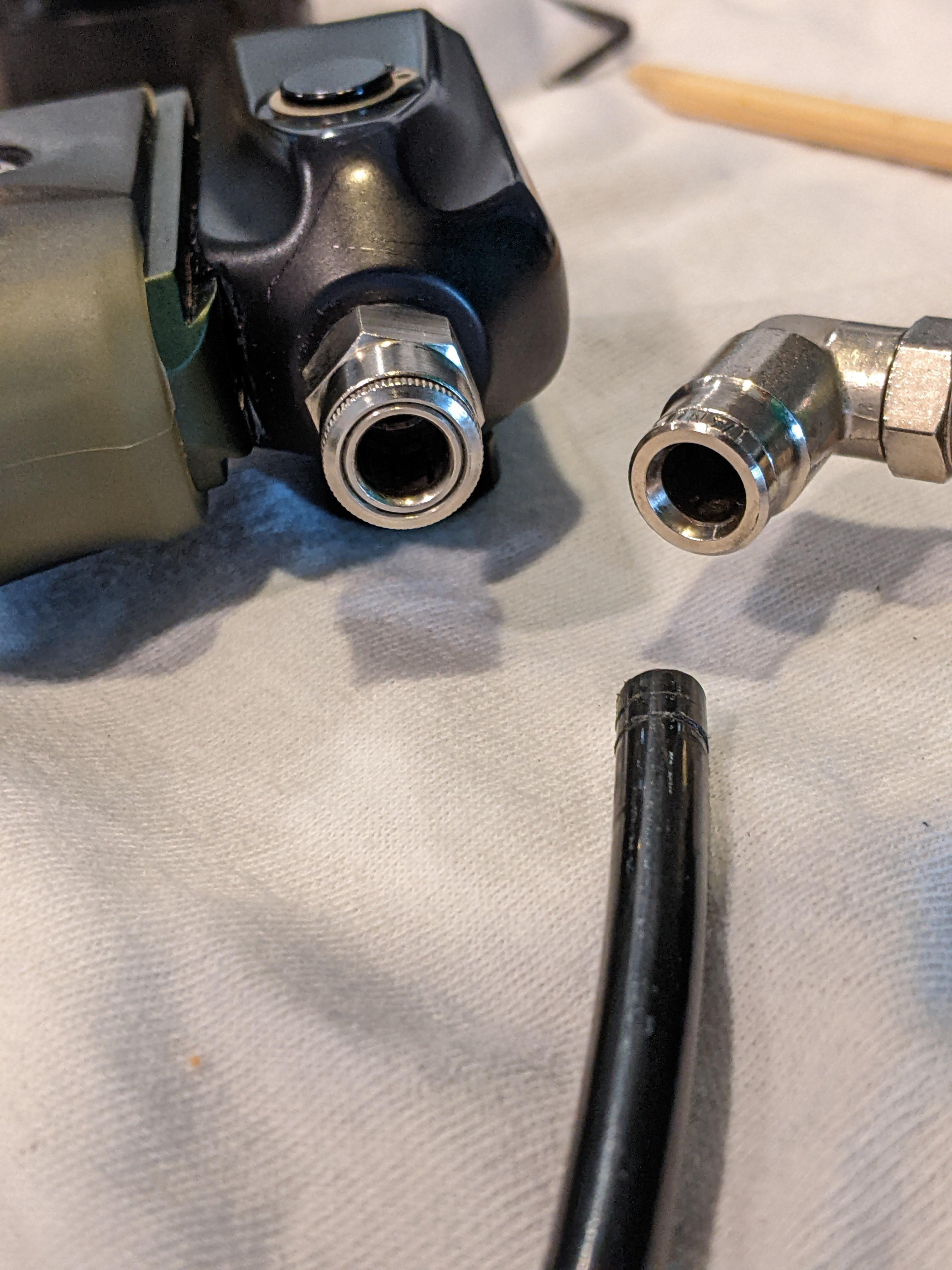

    The fitting on my Micro Max Flo is leaking, and it is definitely larger than a standard 010 oring. Anyone know?

      OD is 6.3mm/.248", and appears to be for CO2 (came on an ex rental SP1, so it may be for durability). Second photo is the oring compared to a 010 (it is the thicker of the 2).
        I. Am. Canadian. 🇨🇦
        • 3511
        Looks like you have a "non-rebuildable" fitting there, that doesn't take off the shelf seals. I've run into a few over the years. Unfortunately I have no idea what seal to use, I never found one that worked.

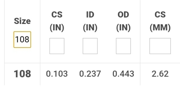

            Have you tried 108 oring?
            its similar ID than 010 but thicker profile

                Alexndl commented
                I edited my post to 108
                107 was on a print sheet I keep to ID unknown oring but the oring size is better with a 108 looking at nominal value

              Bumping an old post rather than making my own. Has anyone had any luck using a 108? I pulled the oring out of stock smart parts on/off asa on a shocker nxt and then promptly lost it, so I don't have anything to measure.
