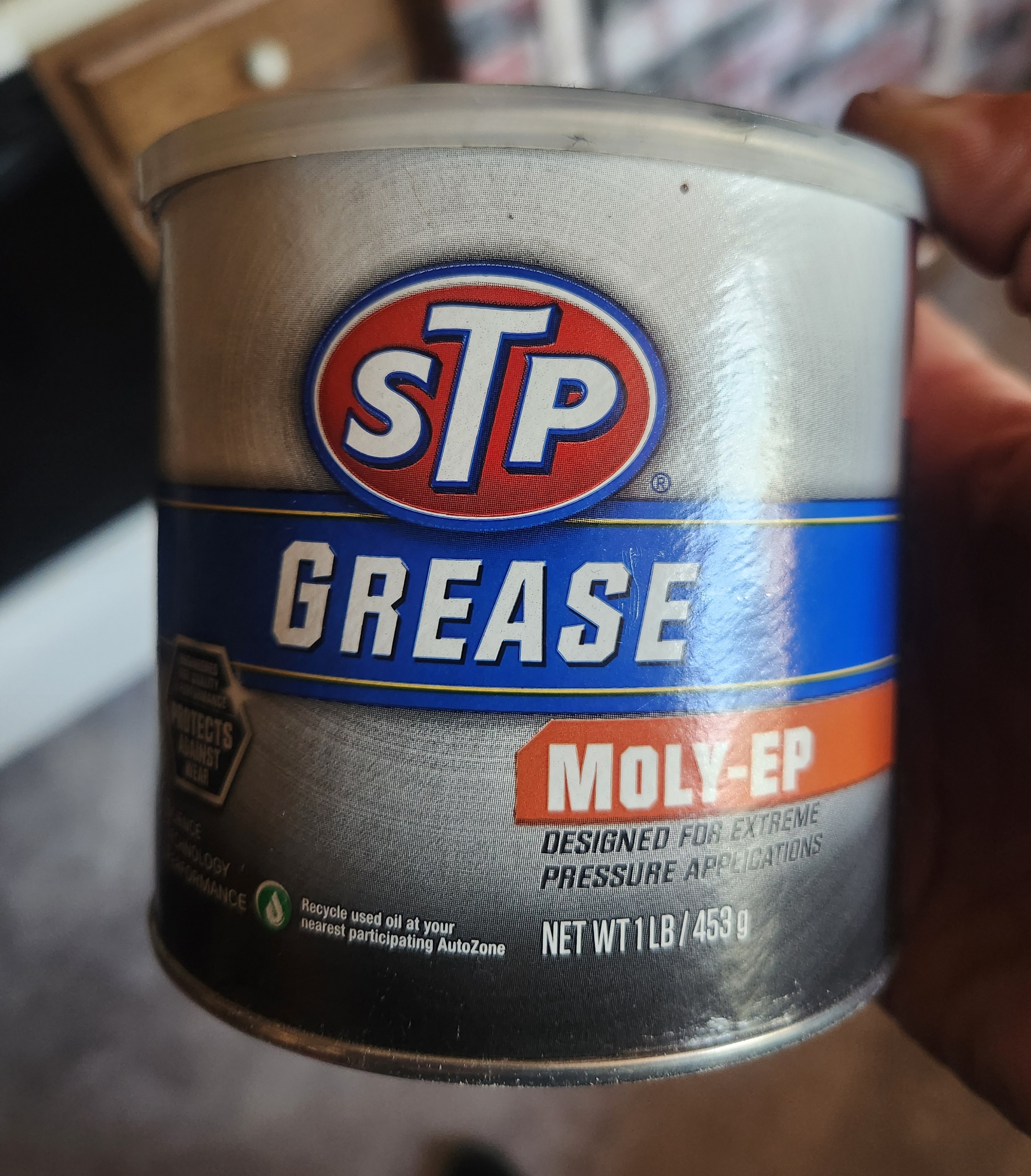

    Synthetic grease containing molybdenum disulfide.
    You can get it at autozone and the like.

      Moly grease works well, it's cheap and readily available.
      If you want to be fancy, zinc anti-size is the best you can use (but $$$)

        Thanks guys.
        I've come across paintball guns with what appeared to be moly grease or similar in them. Now I know why. Because it was some smart guy.
