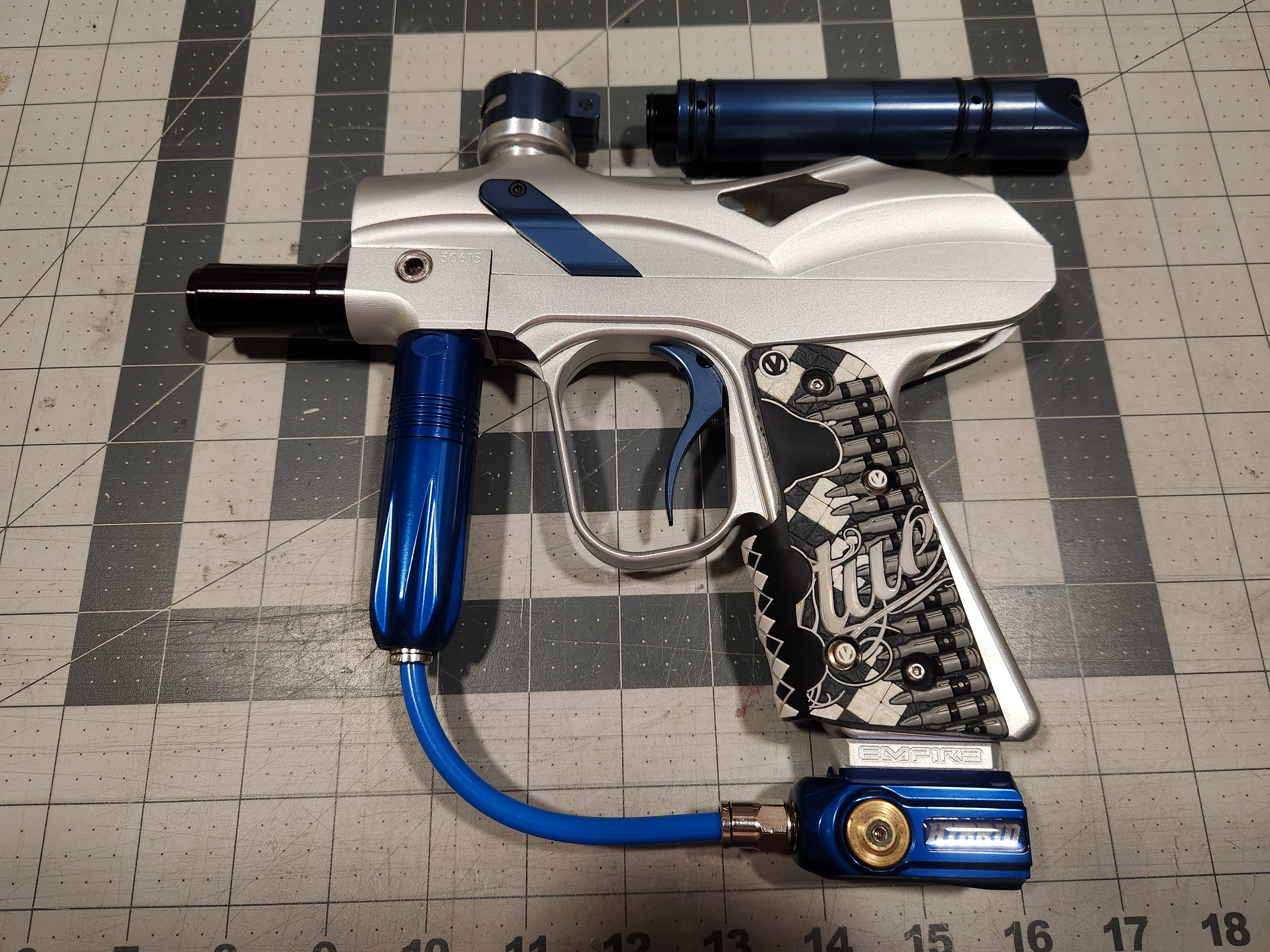

    I have never had anything anodized before, mostly because I have a hard time justifying the cost, but I am thinking I would like to at least get the accent pieces on my ICD FS8 anodized to have them all match.
    I'd like to have the main engine, feed neck clamp, eye covers, lpr, hpr and ASA all done to be a matching blue and possible a red splash and just leave the silver body\barrel\frame as is.

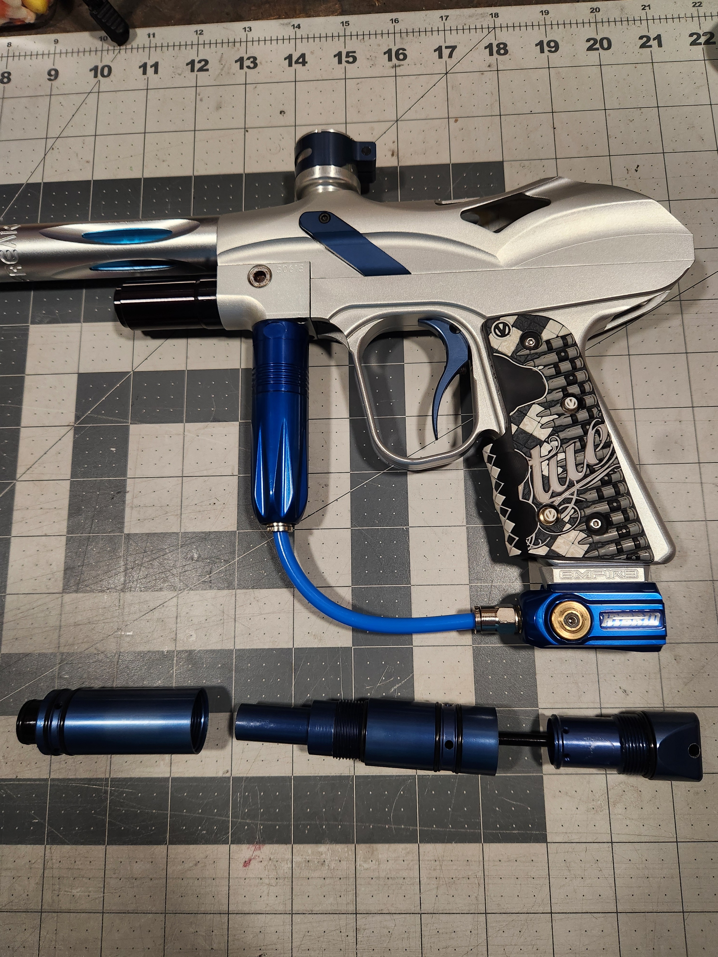

    2. Is there anything to worry about as far as clearance\assembly if having the main engine anodized? I am guessing its not any different than having a LPR or HPR done as those break down into parts as well.
    3. Any tips on tearing down the STD Industries JDS lpr? The installation paper work says to not remove the set screw on the side. Of course it would need to be disassembled for the anodizing.

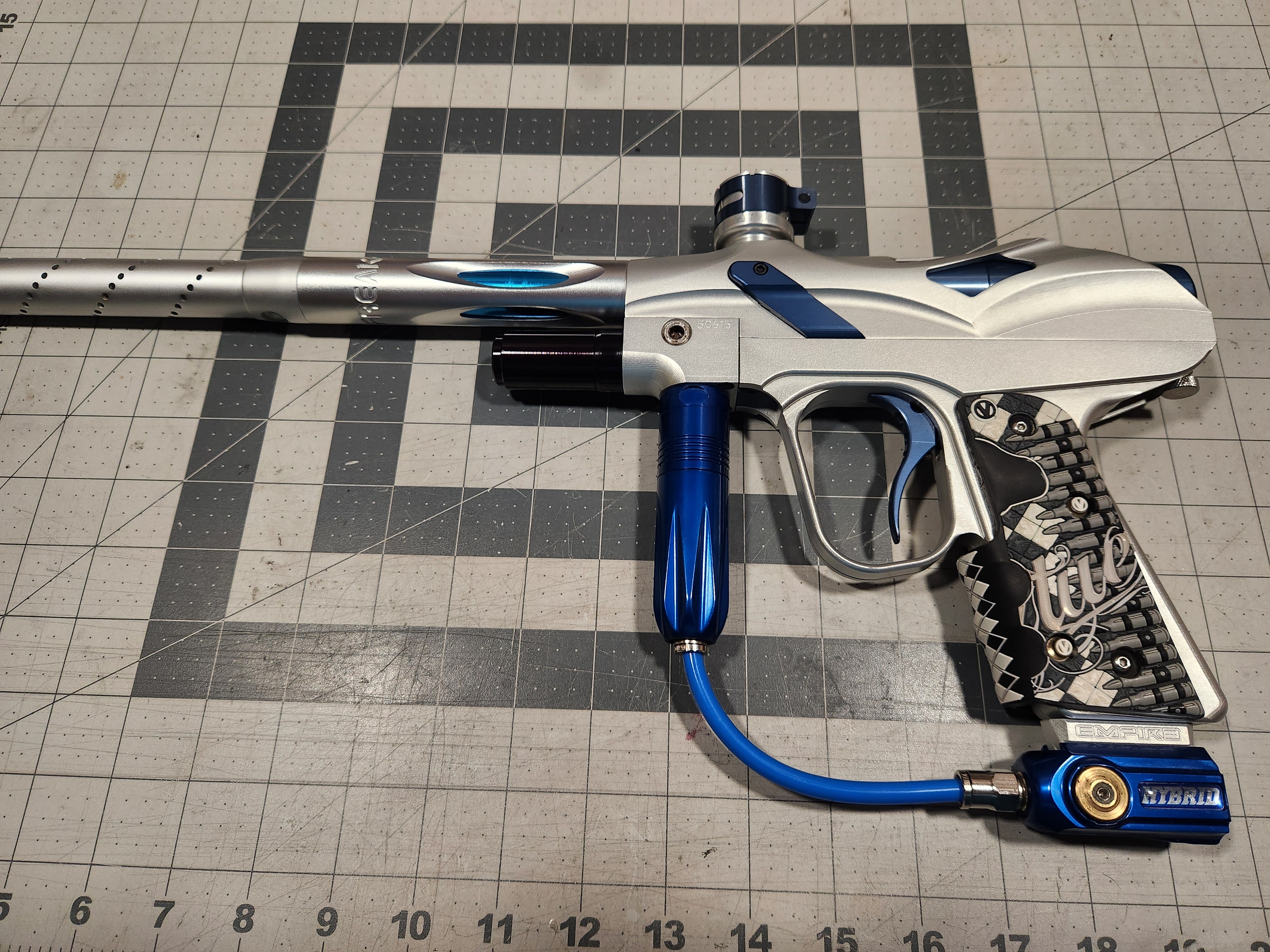

    Generally speaking, ano shouldn't cause clearance issues when done properly. Any of the top ano guys should be able to safely do it. I would message a few and get quotes. A few never messaged me back, red flag. Others took a long time, red flag. I had Ruckus do my Karni and I generally told him what I wanted but ultimately let him decide the details like it being two tone. I would say the ano work is 5/5, setting expectations of timeline and general communication is maybe 2/5. He would respond when I message him but it was on me basically every time to ask for updates and it definitely took a long while longer than the original expectation. None of these are deal breakers, the result matters more than the communication but just my honest experience.
