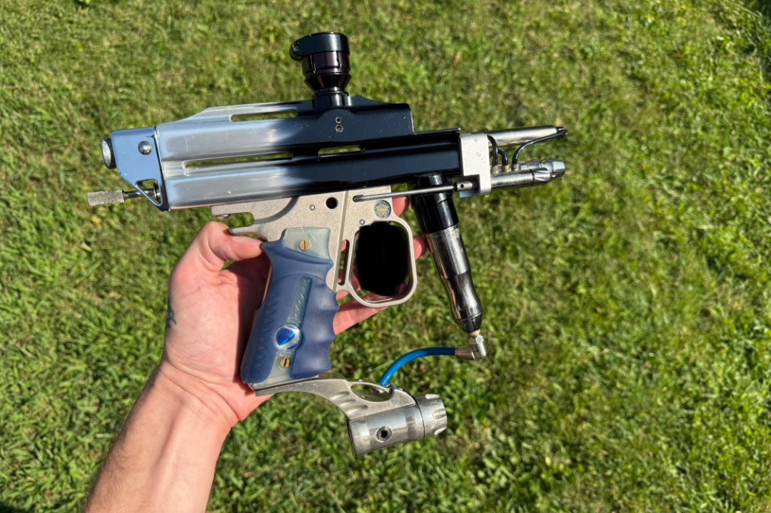

    Hello everyone, this unicorn popped up for sell locally for $35 and really grabbed my attention. What exactly am I looking at here, does it take cocker internals and pump kits? Box says Rex paintball M1

    I believe that’s a Dragunfly, Dragun cocker knockoff

      Thanks Jonny, I did read that but the only member who seemed more knowledgeable didn't specify my question. He only mentioned it had some issues but who knows, more feedback would be appreciated.

        Zero regular cocker compatibility. More Spyder based
          • 2838
          Wouldn't call it a unicorn, but it is definitely worth $35 max

                Thank you for the video, I got in contact with the guy and depends on what he says about the pump kit, I'll give it a shot. Seems like a decent shooter and the guy stocks parts for those, God knows which Spyder guts would take

                  You can't use a standard Cocker pump kit on it because of the metric threads, I want to say if I remember right it was either Trinity that made one that would fit it or one from a Trilogy will fit.

                    Good observation, thanks! I'm trying to gather as much info as needed to see what's possible to make it a pump. Gun looks pretty neat to my eyes, just can't justify not buying it for $35 😁

                  i made a pump kit back in the day for these.
                  ah, the good ol days of having access to a college machine shop and thinking my time was worth building things like pump kits for these lol

                  Since these don't even have a banjo bolt not sure how pump kits would work on them

                    I've messed with converting one back in the day.... You need a spyder front block.
                    Might be easier than years ago because Spyder low pressure chamber threads are the same as trilogy lprs

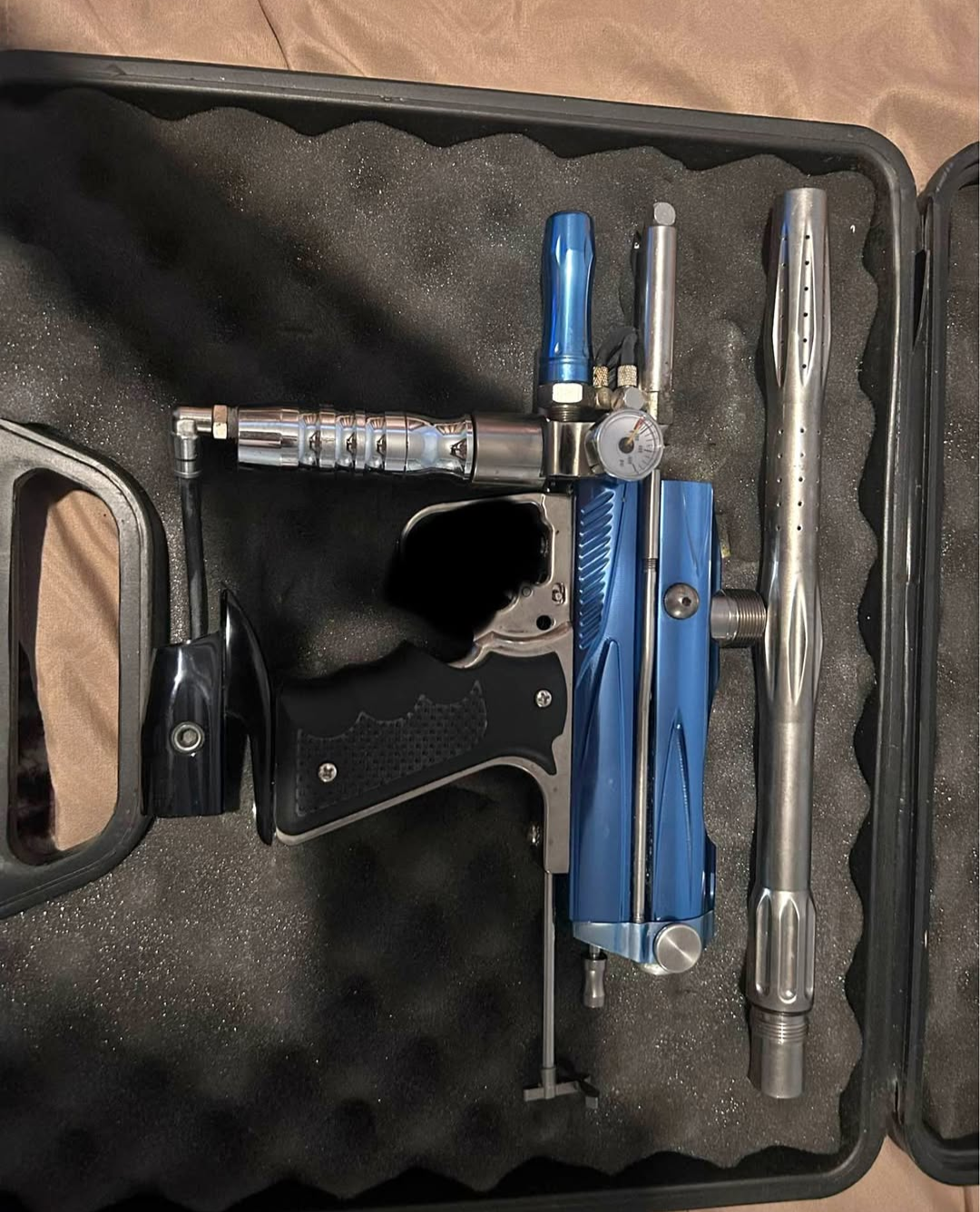

                      And because I don't want to make a new thread.. here's another one that popped up in the woods. Seller wants $200 untested as is, he might include a barrel. This would be for a pump project. Which model is it exactly?

                        Since no one else has responded, that's an AIM body. I forget what they called the base model, I think I have it on my computer back home. Also has a WGP v2 hinge, WGP HPR from a 2k4 prostock. The ram and LPR appear to be from a Dragun Drallion, with a WGP CT/Orracle 3-way. Also has a system x drop forward and on/off. Looks like a KAPP 2k+ back block, can't see enough of the bolt to ID.
                        AIM is one of the better autococker clones out there, it would be a good base for a pump.

                          Such a knowledgeable input there, and yes my main reason it's to build a pump out of it. It might get a little out of budget since he's asking $200 plus shipping. Is it worth the $$ and takes Autococker guts?

                          Back block is Pre2k size and profile for 2k bolts. I think kapp and shoctech both made versions of this. It will never look right on a 2k body. I had one of the ST versions that was pre2k size, profiled for 2k and took pre2k bolts.
