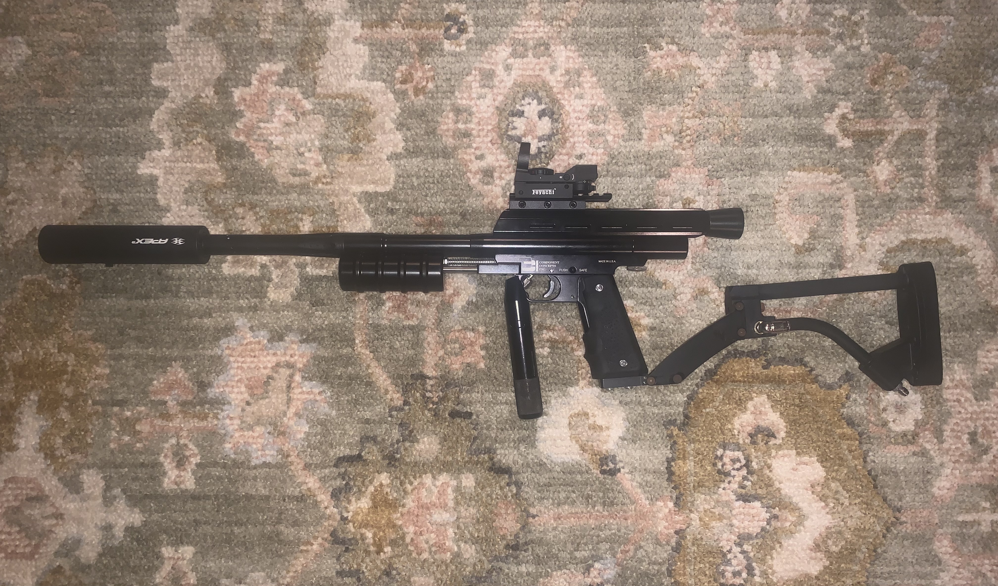

    Looking for an adapter thst makes my 45 frame “flat” or even with the barrel and stock class feed. Wondering if the product exists or if someone can make or print one for me. You can see how my stock is angled a bit annoyingly.

    On the same exact plain ————— like inline stock and barrel or just use a proper tstock no angles

      Not sure I understand. Looking for the top bar of the stock to be horizontal as the barrel is in the photo. I need some kind of adapter or spacer for the ASA.
      This stock is important to me for using the sight prone.

    Hard solution, there have been wedges that go between the bottom line and grip to fix the angle issue. All CCI branded .45 grips blocks have the bottom angled up a bit, so a few people over the years have made wedges. Hard to find. Good luck.
    Slightly less hard, but potentially expensive, find a different .45 grip block. An ICD one for example has the bottom of the grip level with the rest of the gun.
    Cheap and easy. A thin washer or two over the rear most bottom line screw, between the stock and grip can adjust the angle. You'll need to do a little experimenting, but shouldn't take too long to figure out the right combination of washer to get things leveled out.

      Thanks for the comment man, I was thinking about washers myself. Resident fabricator of Phantom parts flyweightnate just reached out and said he should be able to make one!

    Yeah there were products and now kinda hard to find. Lost in peoples parts bins.
    It would be a nice thing to sell as a lot of people want to use a phantom for things other than factory bottom line adapters and stocks.

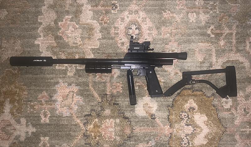

    Popping my head in to say the batch is done.
    5 degree T-rails, either to line up your tank parallel with your Phantom barrel, or if you're old school, stick it on an autococker to tilt the tank down and keep the liquid away from your ASA.
