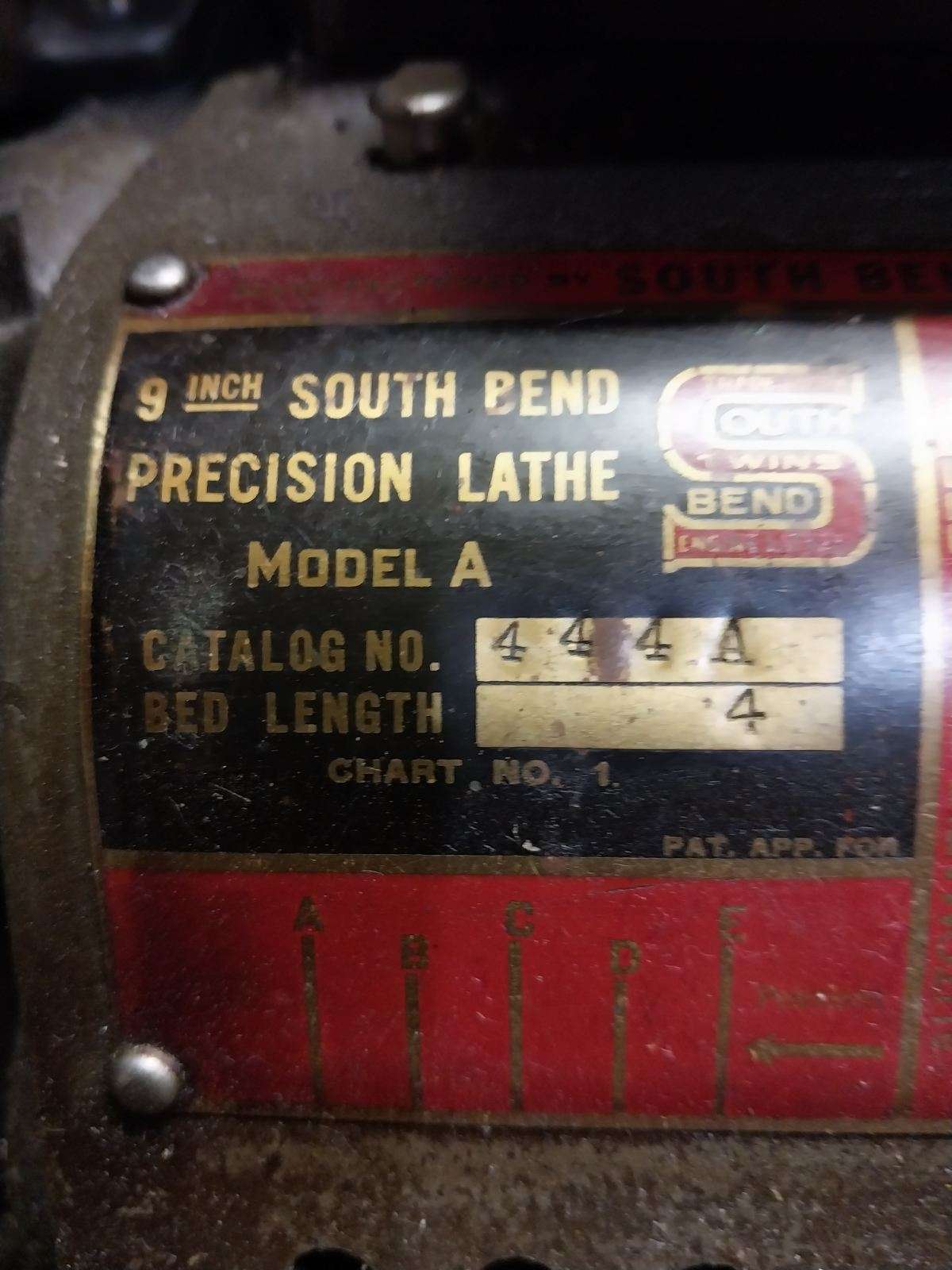

    We have a friend of the family who went into the nursing home a few years backZ. He has a some machining equipment. Ed’s wife has been slowly cleaning the house for the past 2 or 3 years now (Ed was a bit of a hoarder) with the help of my in-laws.
    There is a lathe and drillpress in the basement that is next on the chopping block.
    Looking to see what they are worth. There are boxes upon boxes on tools/accessories for both of these (literally almost 60 pics worth of boxes, a lot of which is brand new stuff still in the oil soaked cloth and with the wax? on the ends for protection.
    Everything is in perfect working order. Ed was a bit of a collector, but was meticulous about his equipment (just unorganized).
    Don’t know if these should go for $200 or $10,000
    after some google searches, it looks like the Lathe is $2200-$4000 and the press is ~ $250?

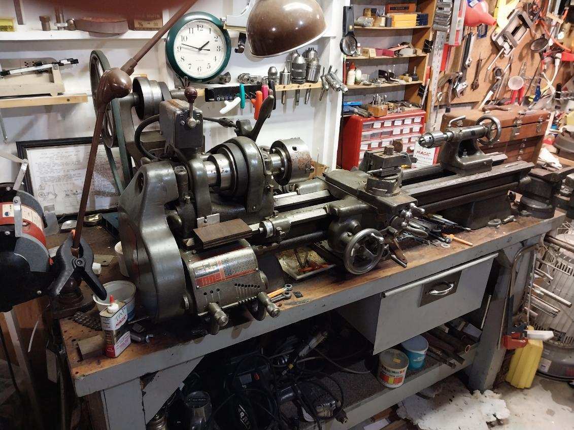

    Im no expert, but i have a similar model lathe (9C] so ill tell you what i paid for mine: $1000. Plus $1000 worth of tooling. Plus having to make a table/stand
    However, what you have there is the 9A which is the deluxe version with the quick change gearbox and i think it also has a clutch. I would value this around $1500 to $2000.
    like i said, i spent an extra $1000 on tooling. Post up a picture of the accessories. You could double the value of the lathe.
    i love my south bend 9a. South bend is no longer in business, but their machines were so popular that you can still buy new replacement parts from ebay. If you can fit it in your house, you might consider taking it home with you

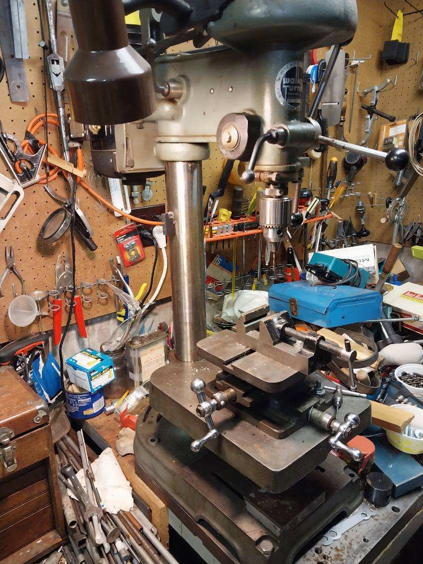

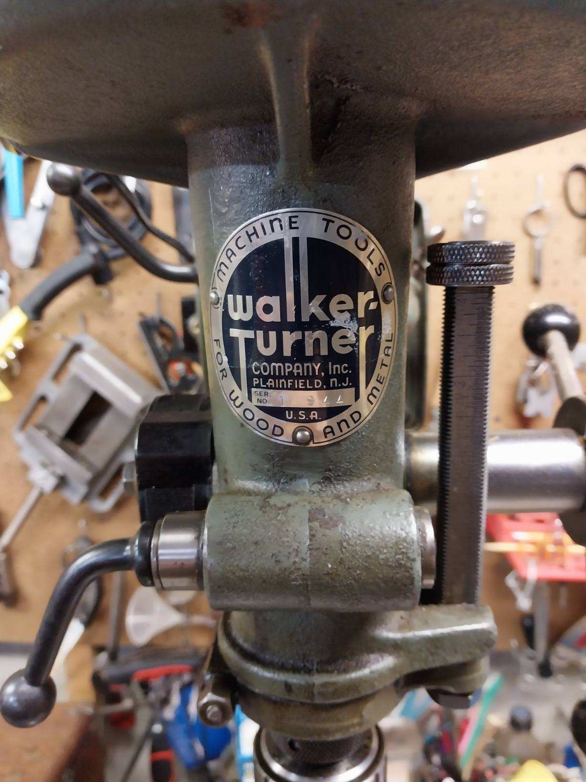

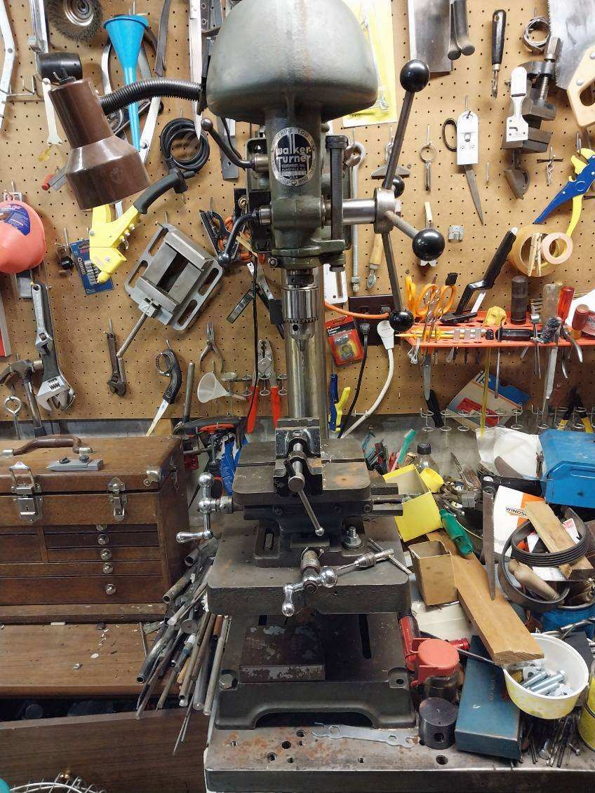

    I dont know anything about the drill press but it has a nice cross-slide on it which is probably worth a couple hundred

      I really want the press an slide though…I KNOW I’d use it

    that cross slide probably worth 300 or so at least. that thing is beefy.
    south bend pricing can be all over the place, condition is key. if the gears and bed are in great shape you easily have 1500 there.
    tooling ...condition and wear will dictate price.

      Markdem has a pretty fair estimate, I'd say. Part of it is the location- if that same setup where on the west coast, it'd be worth 20-25% more, and up here in Alaska, more like 50% more.

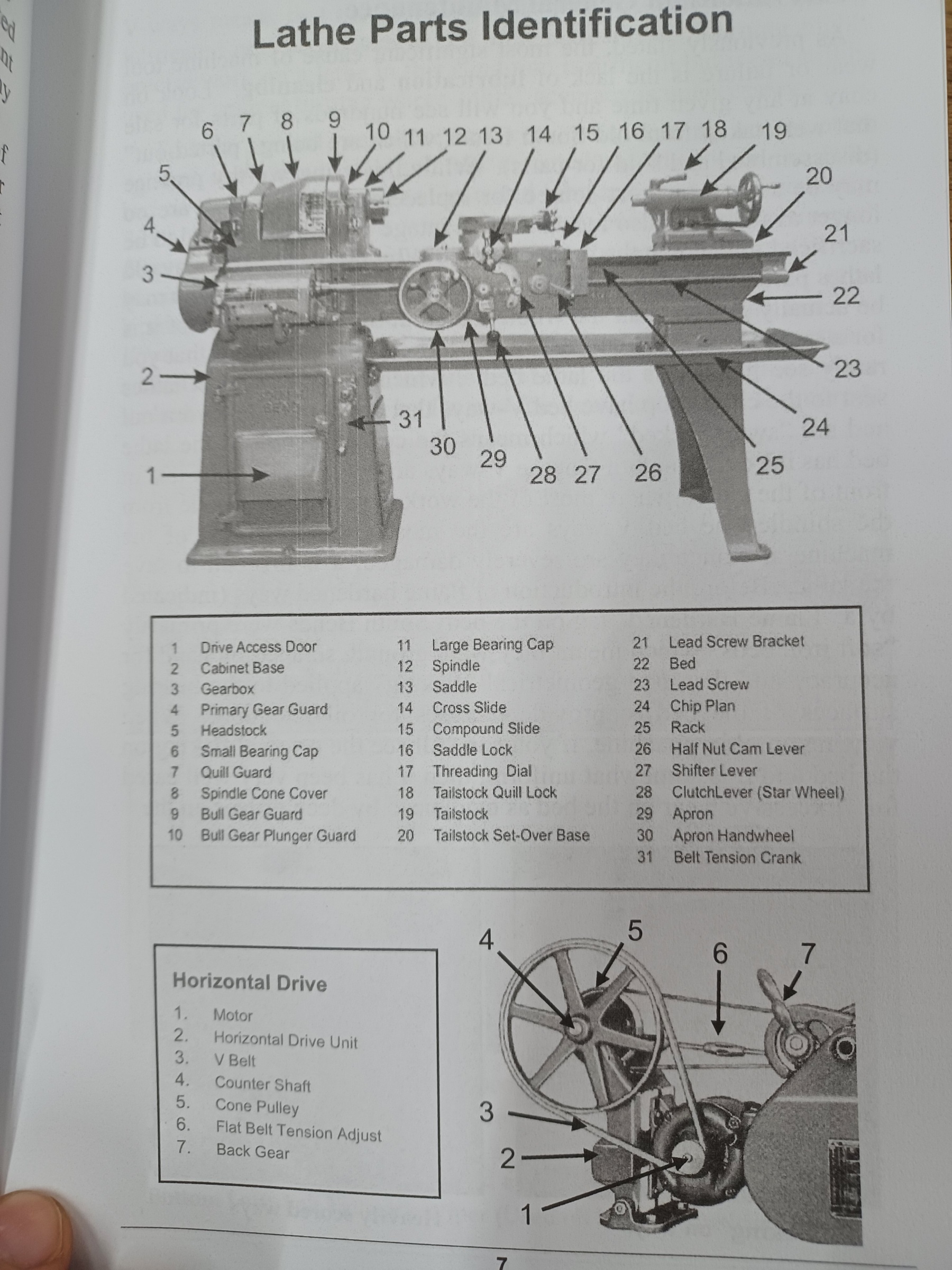

      (That's not a proper "clutch", by the way, it's a belt-tension lever.)
      If you want a small home-shop lathe, you might have trouble finding a better example. BUT... if you do, try and find all the major tooling for it. Chucks, chuck keys, toolposts, cutters, wrenches, etc. I can see a rack of tailstock centers and chucks on the rack on the wall, there's toolpost wrenches on the table under the carriage, I'd wager that red chest of drawers and the wooden machinists' chest, have more tooling (micrometers and the like) and if the lady is amenable, see if you can get some of the loose bar stock and raw materials.
      Ditto the drill press. If there's a supply of drill bits, see if you can get those, make sure you get the chuck key, there's two other drill press vises hanging on the wall behind it, etc.

          #28: clutch
          • DocsMachine
            • 2786
            Oh that clutch. Sorry, the phrasing threw me- "even has a clutch", on a lathe with power feed, is like saying your car "even has a steering wheel".
            Basically every lathe with a power traverse- and almost everything has it these days- has a clutch mechanism to engage the feed. When you phrased it as "even has a..." as if it were somewhat rare, made me think you meant a headstock or spindle clutch. The kind of thing you'd see on larger industrial lathes.
