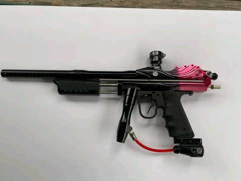

    Thanks in advance for fielding my dumb questions:
    1. What kind of cocker is this?
    2. What parts do you recognize on this? (e.g. pump kit, reg, trigger frame etc etc)
    3. What's it worth?
    4. (bonus question) Anything about this gun concern you? (e.g. custom mod makes it difficult to upgrade something, etc.)
    Considering buying this from someone I don't know on fb and I have some "too good to be true" concerns...
    Thanks!​

    AIM eagle body
      • 2815
      Vendetta pump kit. Dye knock off frame. Azodin reg I think, which aren't great. Personally not a fan of double triggers on pumps and if it is an Azodin reg, they're known for being not so great

      Almost certain this is on ebay right now as well

        • 6249
        Aim eagle body I'm sure of
        Everything else I could be wrong about
        Looks like a ID drift pump kit
        ID regulator?
        Frame looks to be a psychobalistics
        Ccm feedneck obviously
        DP? ASA
        It's a decent build. Honestly the biggest thing I would look at replacing is the frame
        Edit. I started this post then put my phone down for 5 minutes and you lot jumped all over it line a party trampoline

          Vendetta pump kits are nice but personally not a fan of everything else. They did provide a photo that's not on the eBay listing, maybe they found another older pic of same marker.
          Send message to the eBay seller asking if they're the same person you're talking to on Facebook.

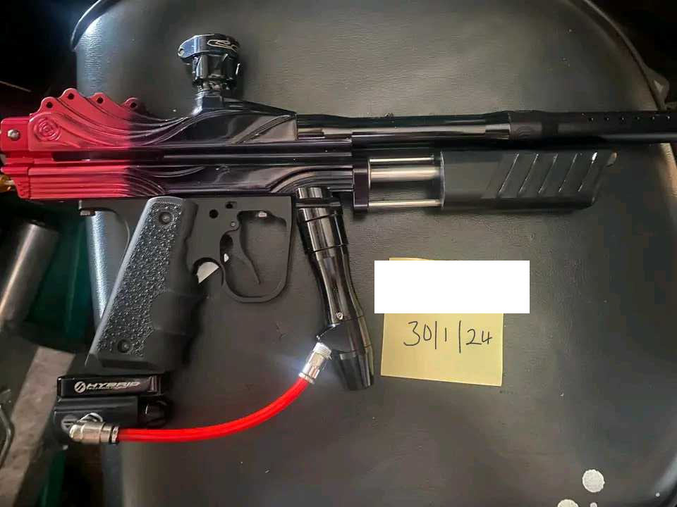

            I'm not too suspect about it all. The first photo is the uncropped version of the ebay photo (notice wooden flooring above paper). For the second photo, I asked for a photo of the other side of the gun with today's date. They sent it to me with today's date (dd/mm/yy) and their fb name (which I blacked out). My best guess is that a buddy was trying to help the ebay seller.
            They asked for a price that was quite a bit less than the ebay price, but I'm likely gonna pass. I know of a pro shop near the fb seller, so I would've met at that shop to have a third party air up the gun and check it out before buying. Appreciate all of your sleuthing though!

          Azodin regs are decent once you swap the piston seat for a DYE one.
          $1.50 part from ANS.
          https://ansgear.com/dye-lpr-hpr-repl...ats-r38720000/
          • tyronejk
            tyronejk commented
            That's good to know. Azodin regs are cheap new and I have a handful of Dye reg seats bouncing around in my tool kit.
