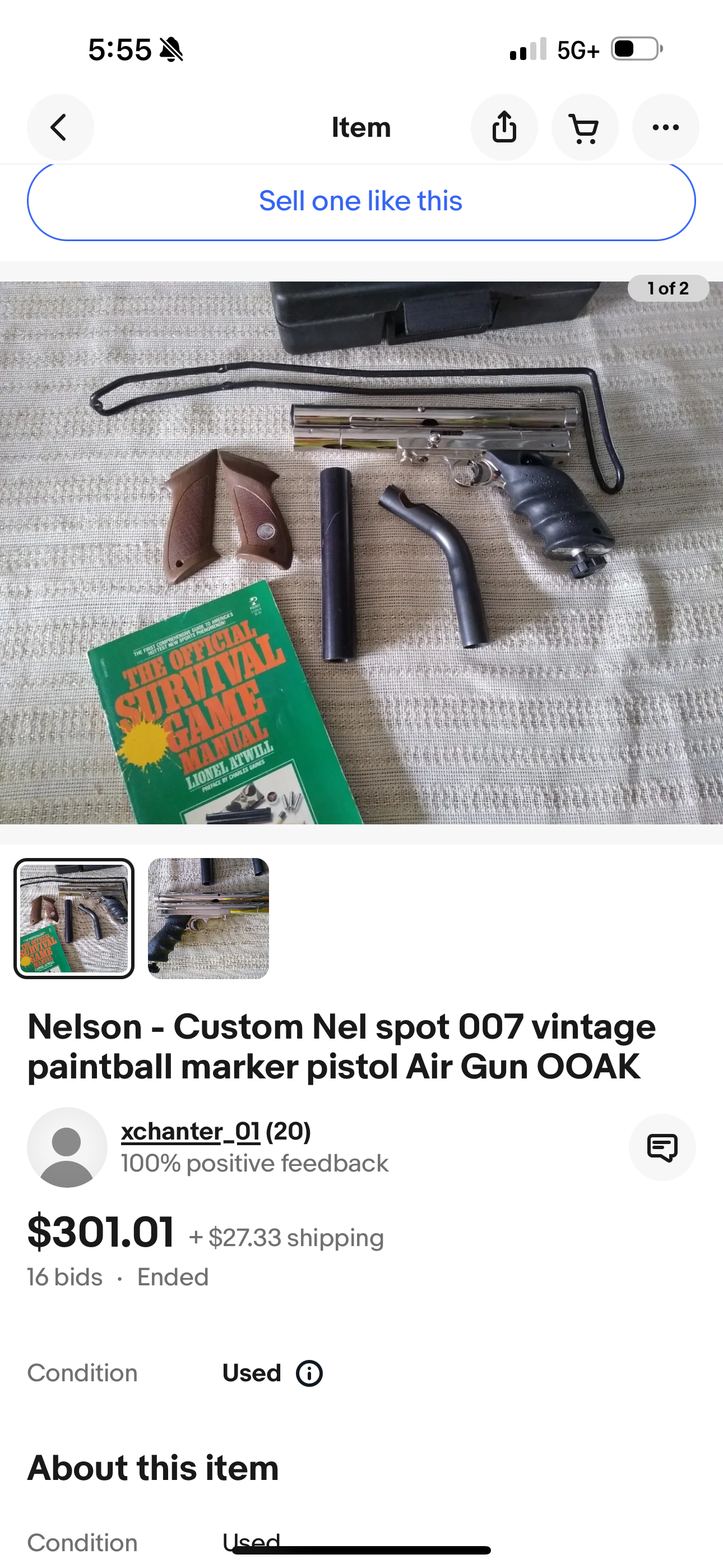

      A similar one that also had the wirestock sold on eBay for $300 + shipping (BIN price was originaly like $220).

        This just sold on eBay line a week ago. Maybe a good starting place…
