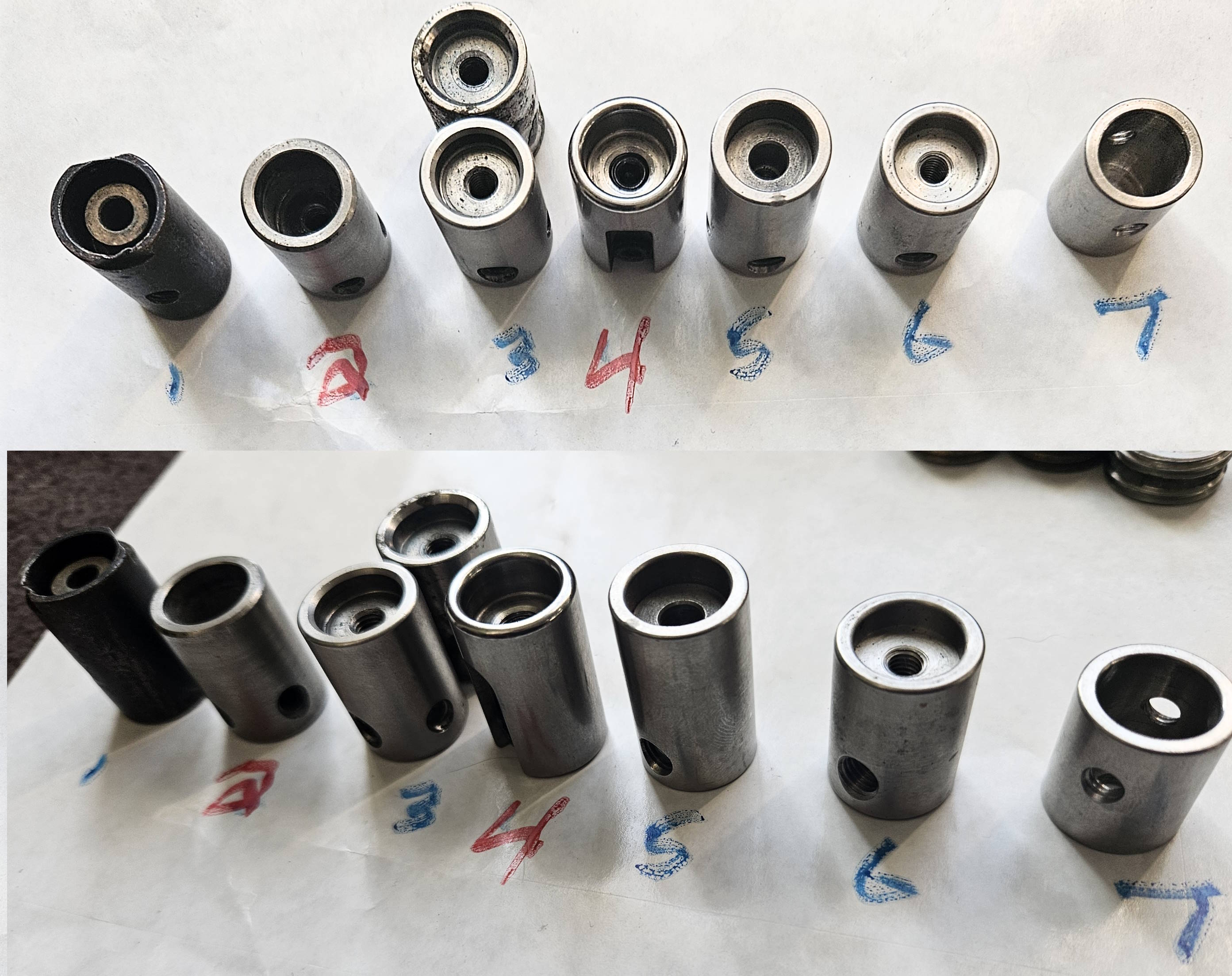

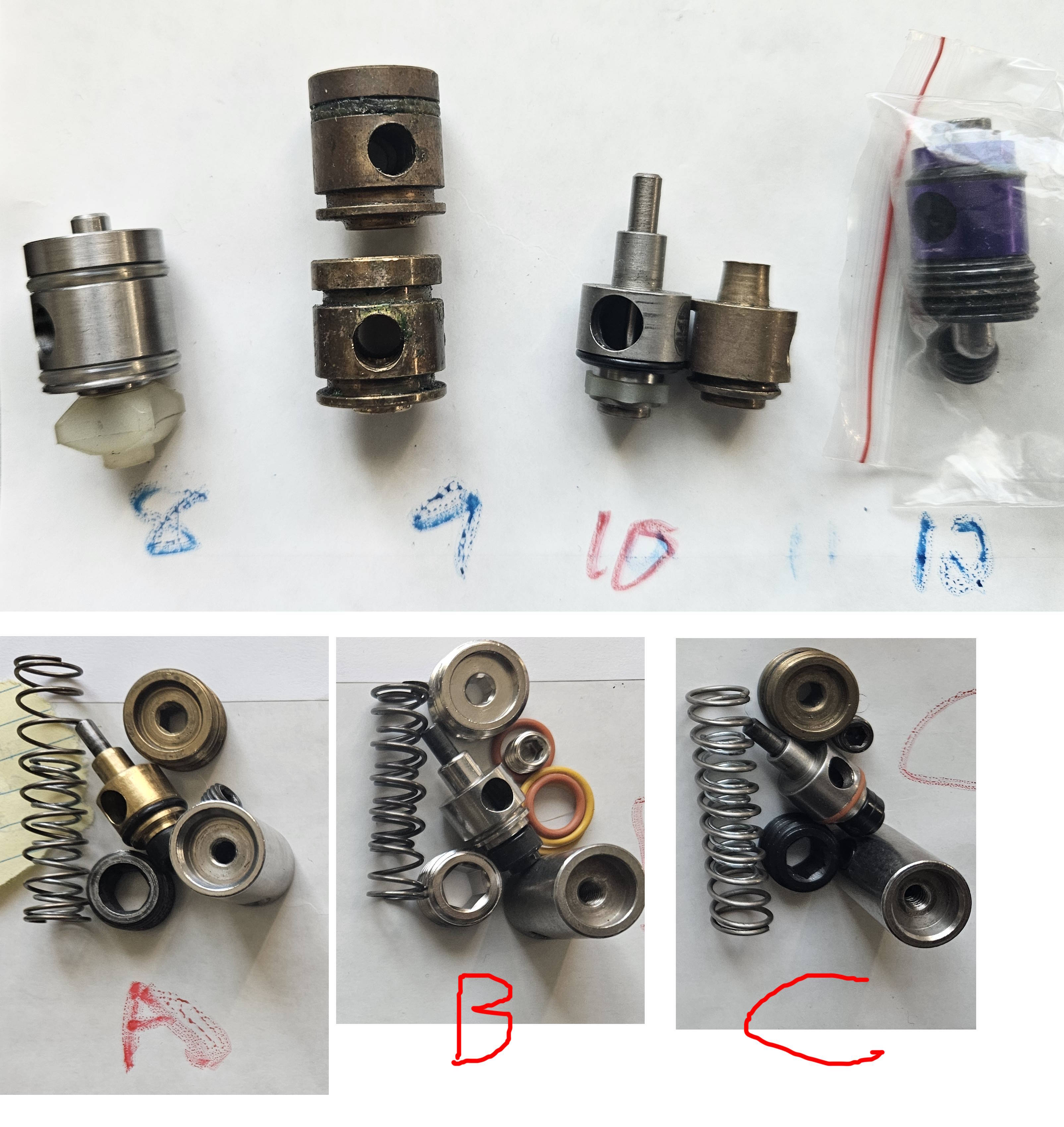

    Part2 of autococker ID and purge. Various hammers valves and such from the piles. I have relatively no idea what's what....
    Anything worth commenting on here?
    Guts Name Comment
    1 Hammer Black, inner parts/allan on other side, looks old, tall
    2 Hammer deep / hogged out?
    3 Hammer normal hammers I think. 3 hole
    4 Hammer Inception universal?
    5 Hammer taller/heavy
    6 Hammer normal hammers I think. 2 hole
    7 Hammer ANS
    8 big valve 11/16, looks newer
    9 big valve ick!
    10 small valve AKA tornado I think
    11 small valve brass lil fella
    12 small valve ST rat?
    A KIT looks stock WGP
    B KIT stainless, looks new, looks stocky
    C KIT looks stock WGP

    1 and 2 go together....1 is the season pro shot ivg and pretty sure 2 is the hammer for it. They were off sizes

      8 looks like it's from an Empire Sniper. 9 are probably trilogy valves. You correctly ID the stainless vale in #10 as a Tornado valve. the brass one is most likely a 2k+ WGP valve. A, B, and C are stock WGP valves as well. The stainless ones are some of my favorite valves. They're great.
