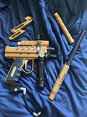

    Hello. I have a python impulse. Haven’t touched it in years. To put it into perspective I retested my tank in 2012 but never attempted to check my imp. What’s the value of one of these, how would I go about making sure it’s in 100% working condition. Not necessarily looking to sell. Just curious at the moment.
    I have this imp a 4500 psi crossfire tank. Dunno if they make them anymore. And I believe it’s an empire reloader B hopper or something like that.
    might start playing again if I can figure it out. Thanks.

    You'll get more in enjoyment if you get it running and play again. Could be a lot or next to nothing to get it running. Gonna get low balled on here if you want a number to sell it all. .

      I have always had a softspot for Pythons... Tank is basically worthless because it is beyond the retest limit. Loader isn't worth much with modern affordable stuff that's out there (although it will work just fine If you want to use it). As far as the marker itself its a little tough because Imps don't seem to have much of a following left but a few of the private label stuff will move.... I would say 300 on the low end and 400 on the high. I vote you keep it, won't take much to get it running smooth and will perform perfectly on the field and nobody else will be sporting one.... its just heavy....

        Honestly Imps are REALLY easy to rebuild and tune. I don't expect it will need much beyond "o" rings, a new LPR tube, and a battery. These use the old skinner/parker solenoids that last for absolutely ever. ZDSPB should have all the information you need for a full rebuild. If your eye isn't working, double check the solders on it, I have been able to repair a few just by touching up the solders on the ribbon.
        https://www.zdspb.com/tech/imp/technical.html

          Honestly pythons are really uncommon/sought after. Normally probably 450 +- now with the market maybe 350 ish.
