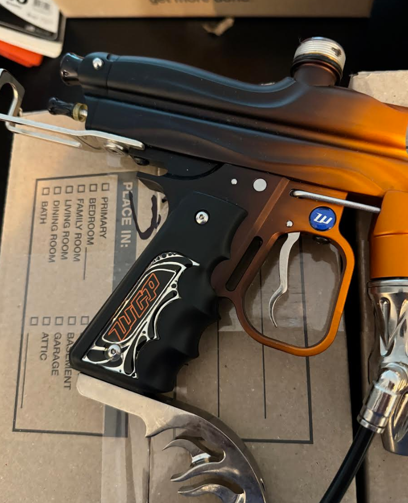

    This was a recent FB marketplace pickup, If im not mistaken, its a WGP Oracle. I am unaware if it works but the condition is super pristine so i am assuming though. I am fairly new to paintball, can someone help me figure out the following:
    1. How to go about testing it safely
    2. valuing this thing because the market seems to be from 500 upwards of 1000+

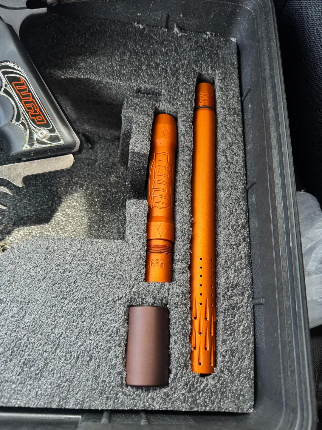

    3. is this the complete set? Assuming those are the original barrels
    Thanks for everyones time and help
    image.png​​image.png​​​

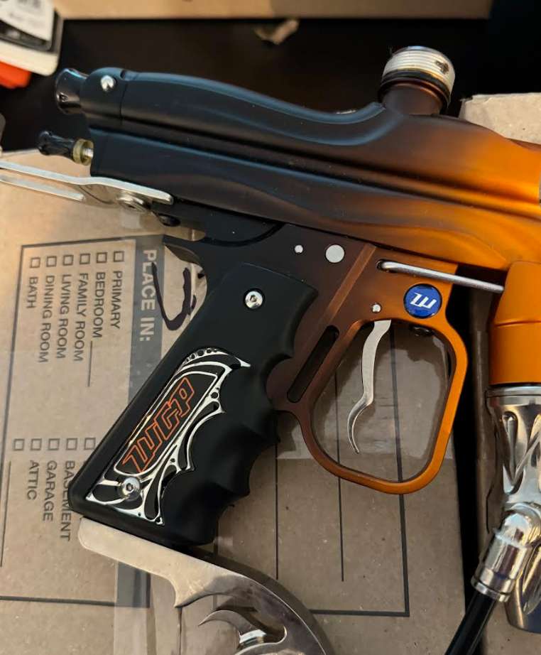

    Beautiful pumpkin fade orracle. I doubt it is but is the other side of the body drilled for eyes? That would affect value a lot.
    • podsbeslipping
      podsbeslipping commented
      Haha honestly i dont know what that means XD but i added some photos of the back, I dont see any drill points.

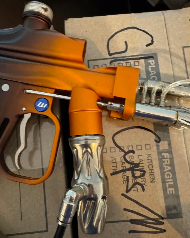

    Need to see pictures of the ram to see if it’s rebuildable???

        Orracle, that looks to be in pretty nice shape. Cocker market is down, so expect on the lower end if you are trying to sell it. You may be able to sell it for $500, but it could also sit for a while, stuff isn't moving like it used to. In terms of testing it, the biggest safety question is the tank. Make sure you use an unexpired tank, in good condition. Inspect the macro and microline hoses for any sort of obvious issues, then try airing it up. Just cock the gun, then slowly twist the ASA knob in. You will know right away if you have an sort of issue and where it is coming from. If it has been sitting a while you can expect leaking, which will indicate that it needs rebuilt.

            I wouldn't say $500 is out of line considering the condition and original parts. I paid $650 at the height of post-covid insanity for one in very similar condition. $450 would get it moved fast even in the current market.
