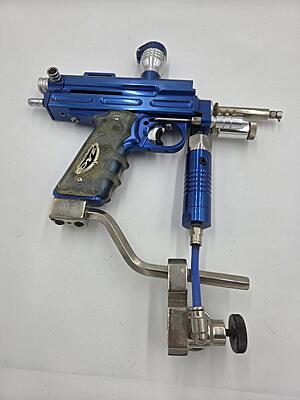

    Trying to figure out what i have here. I know this group will get it right. Any help is appreciated.

    That’s a Works
    • Hellion360
      Power Lurker
      • 2516
      https://www.mcarterbrown.com/forum/p...re-the-keepers
      That is a Works Gen 1.
      Milled from an AKA merlin blank by CCM for Works
      Looks largely complete. Missing the stock barrel (usually a polish clear DYE Excel)
      Missing the beavertail and Works trigger plate as well, but it could be early enough that the plates weren't in production.

        It is with remarkable consistency that I can find the most niche information here from you legends. Thank you so much.

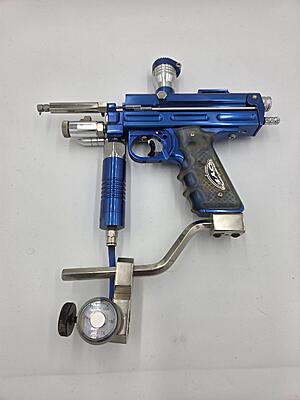

        can you take a picture of the banjo bolt.
        Also was it cut into a mini? take the front block off ever? pills are very close to the front block
        • Hellion360
          Hellion360 commented
          Looks the same as mine. Appears factory.
        I've never messed with it. Was purchased with a large lot so I couldnt truly give you any information on it. If you need more pictures I can definitely take some.
