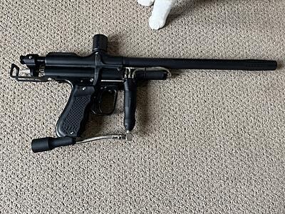

    Stock WGP Trilogy SF. sometimes the pneumatic valve seems to not want to move the 3 way. like it locks up in the little electro valve. and if you air the marker down and air it up, sometimes a couple times, it will cycle again. no leaks, powers up fine and clicks just doesnt seem to want to release the sear/3way all the time... the stock feedneck (removable) has a relief cut to fit hopper in without sanding...
    Whats it worth as is?

    The frame is $50ish alone, more if it's been converted to a pneuframe.
    Trilogy is like what, $150 or so with a different frame? Bit less if the SF frames is sketchy, bit more if it all works.
    I'm not really up on values right now, so I'm probably off by a bit.

      150-175 if in working order

        actually think i've got the issue figured out, crazy tight in the trigger frame, replaced the LP hose to the trigger mech, with slightly longer hose its working atm. seems it may of pinched just enough to not function with grip frame on. gunna do a bunch of test shots this evening and see if any more issues.
