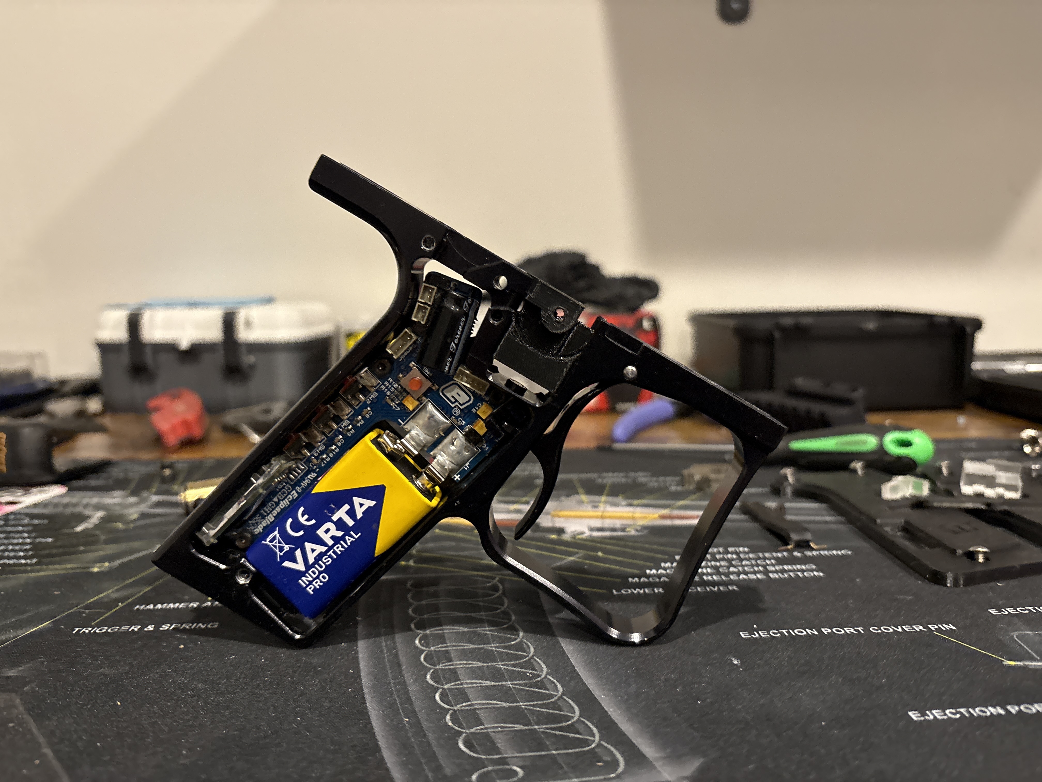

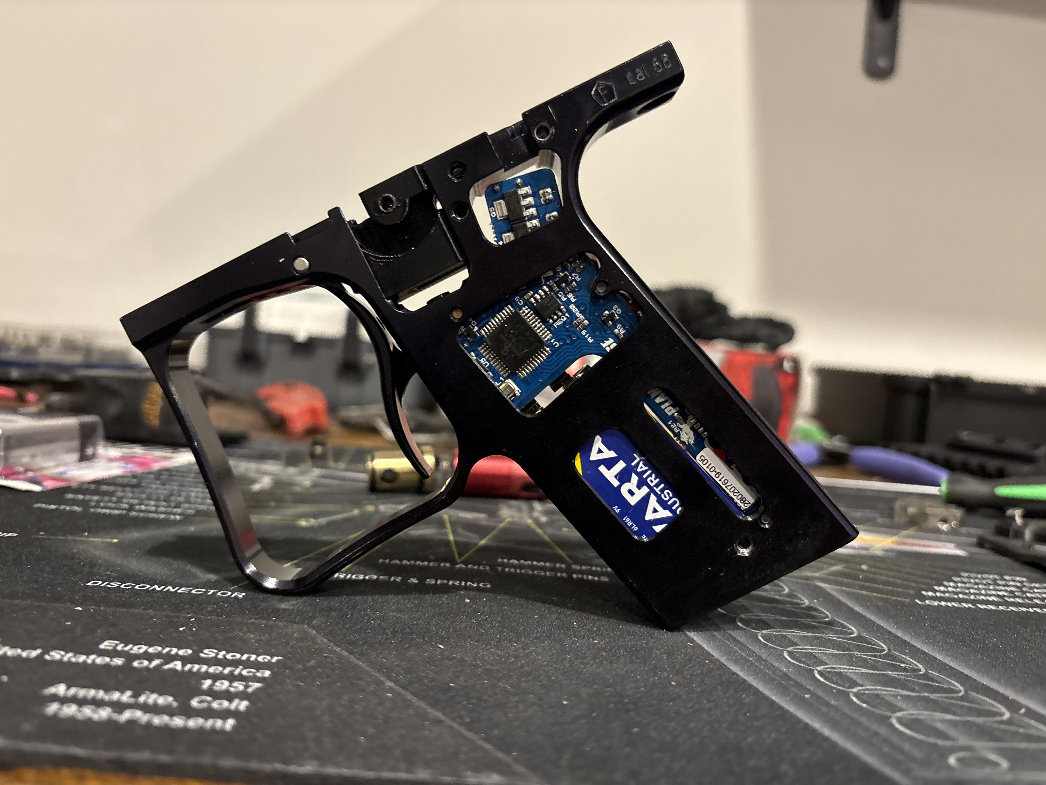

    This all came with a couple project markers I bought. The ndz frame has been t slotted(id asa is not included), has a pant lebal mq2 clapper delete, pant lebal grips and zero b 1.2 board. I have a dust black karni noid/cover I’d include as well. I also have a spare clapper and sear but no sear pin or spring.

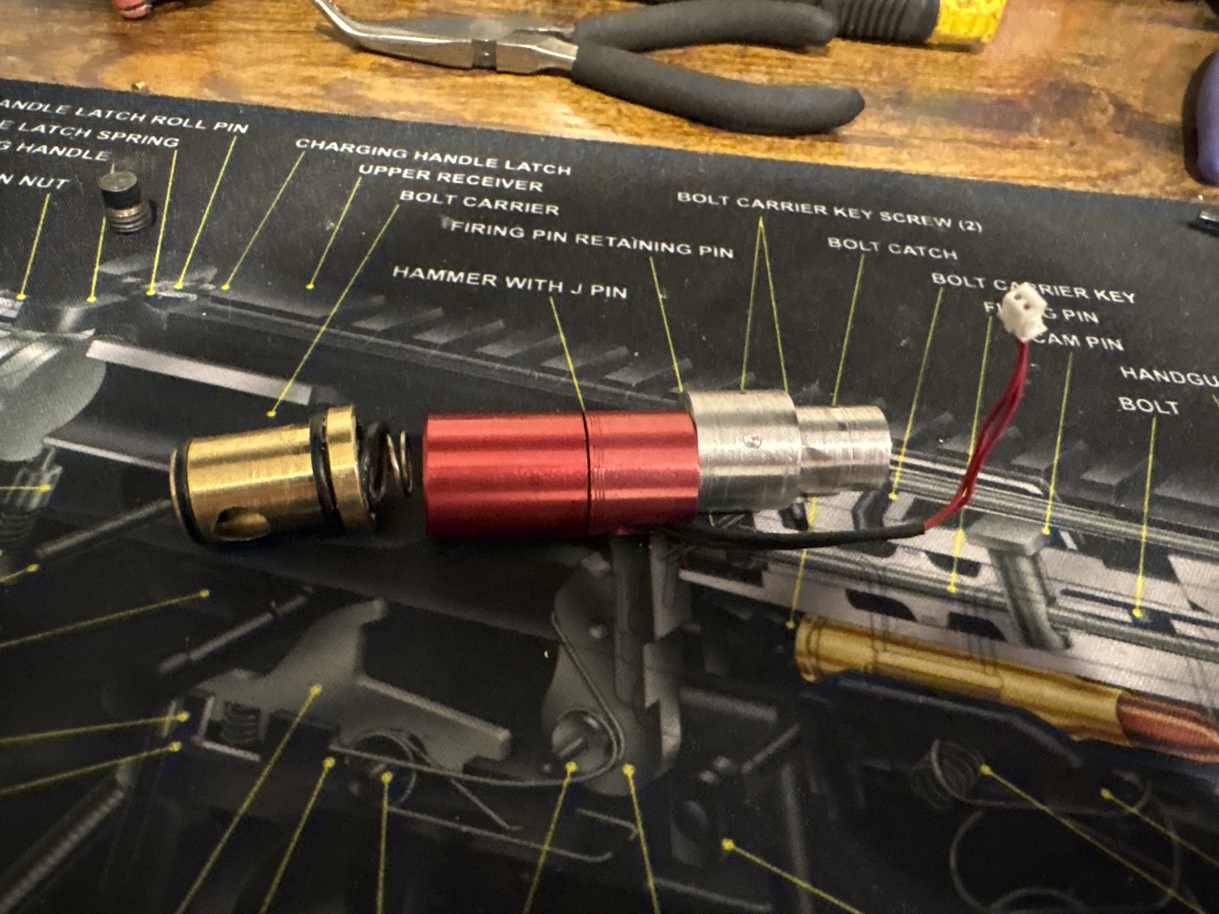

    Mq2 has the karni spacer and wires are completely sheared off. Didn’t happen while loosening IVG, happened while gently pulling the mq2 out of the back of the marker so they were on their last leg anyways. I believe someone industrious can open the mq2 up, unwind it a bit and resolder the wires.

      Update: I was industrious enough to tap the noid out of the housing and solder the wires back on. I hooked it up to my frame and can hear the pilot moving it I put the mq up to my ear.
