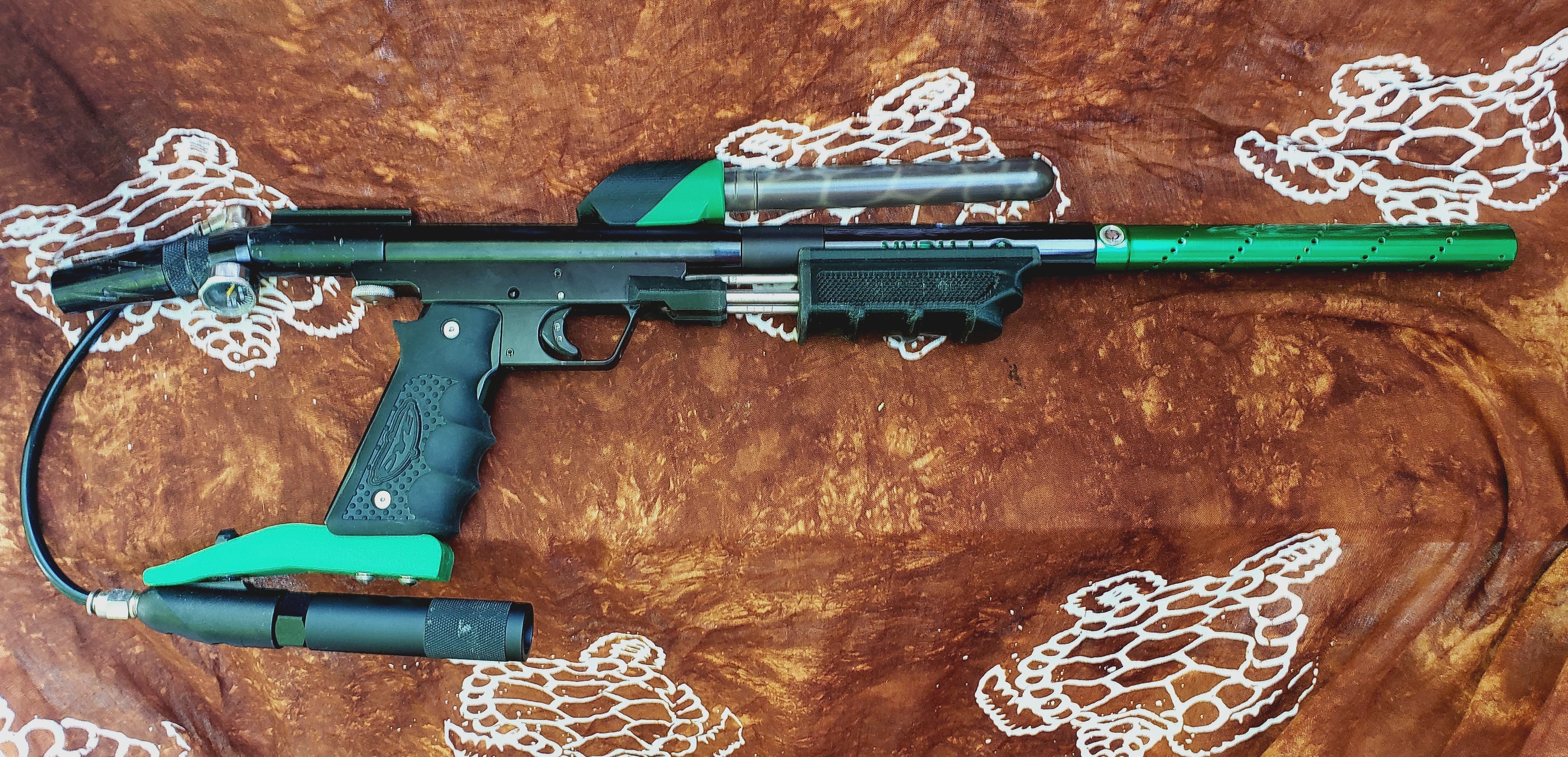

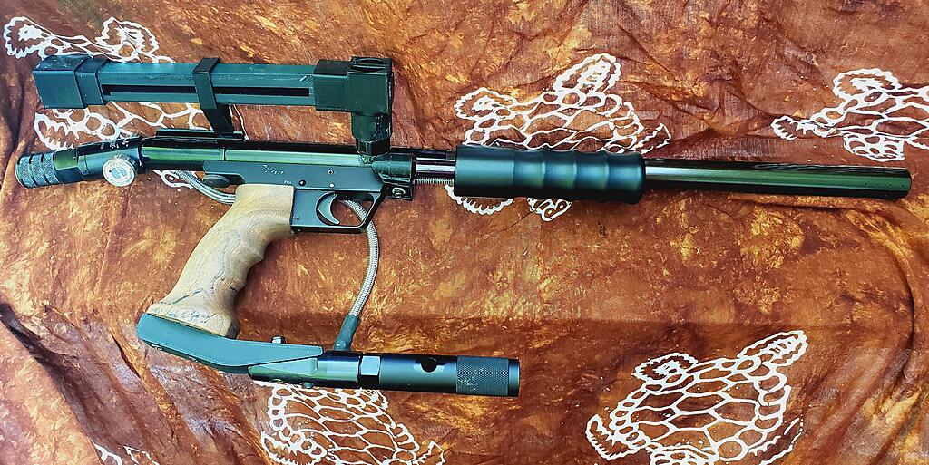

    Unpacking and cleaning up after the awesome event Slim's Spring Stock Classic 2022 at AG Paintball in NH, I figured I'd post the collection that I've been bringing to the big stock games for a while now.

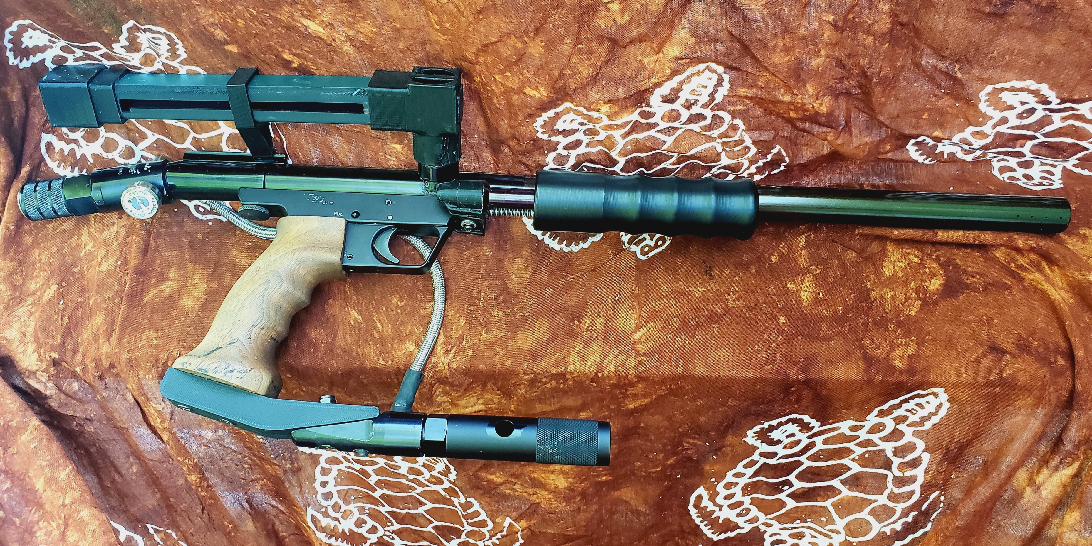

    The "Old Dog" I've had since the mid 90's, traded for a splash Micromag that stupid younger me traded into but never had the loot to get a compressed air system back in the early days.
    • not a uni-body but has old uni-body internals, no anti-kink.
    • right handed wooded marksman's grip, came with the setup, so comfy.
    • custom printed drop for the Island Style 12g changer.

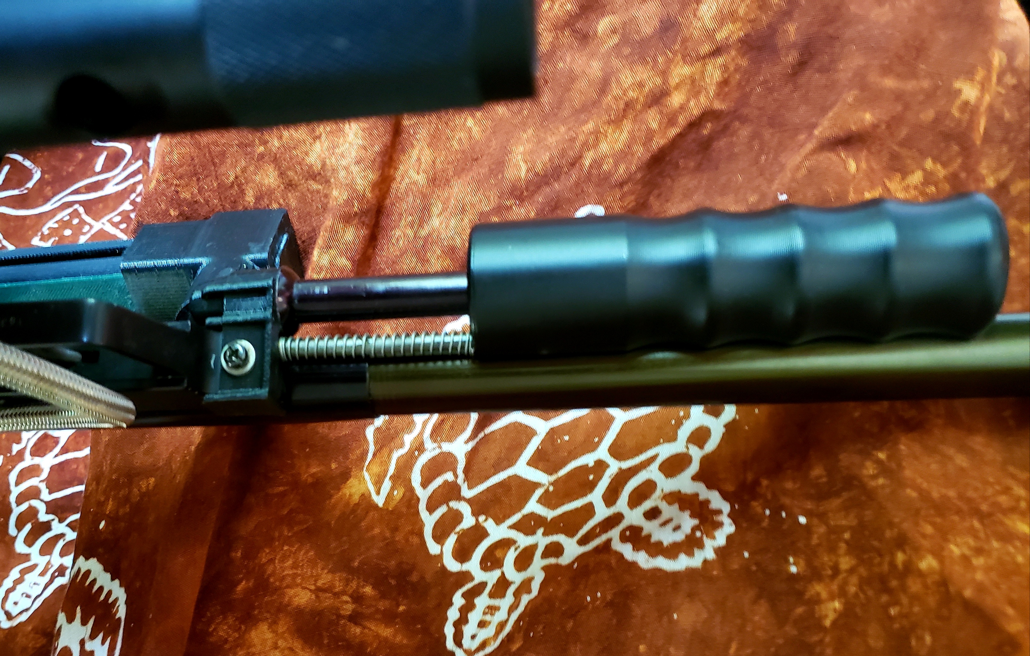

    • box stick feed with dovetail strut, printed in PLA with a TPU flexi speed feed. Source Files
    • side-cocking kit using a Psycho Ballistics pump handle and guide via a printed adapter. MCB thread Link. Source Files
    • Vigilante reg with gauge off the back end. This marker came to me with a stripped bolt/velocity adjuster so I became accustomed to using a reg to adjust FPS at the chrono.
    • 14" freak bored barrel from the new CCI caretakers.

    My MCB avatar, rocking the Old Dog with a Warp Feed on Phantom Village during a Canobie Paintball Big Game. Remember that one year they produced a DVD of the games?

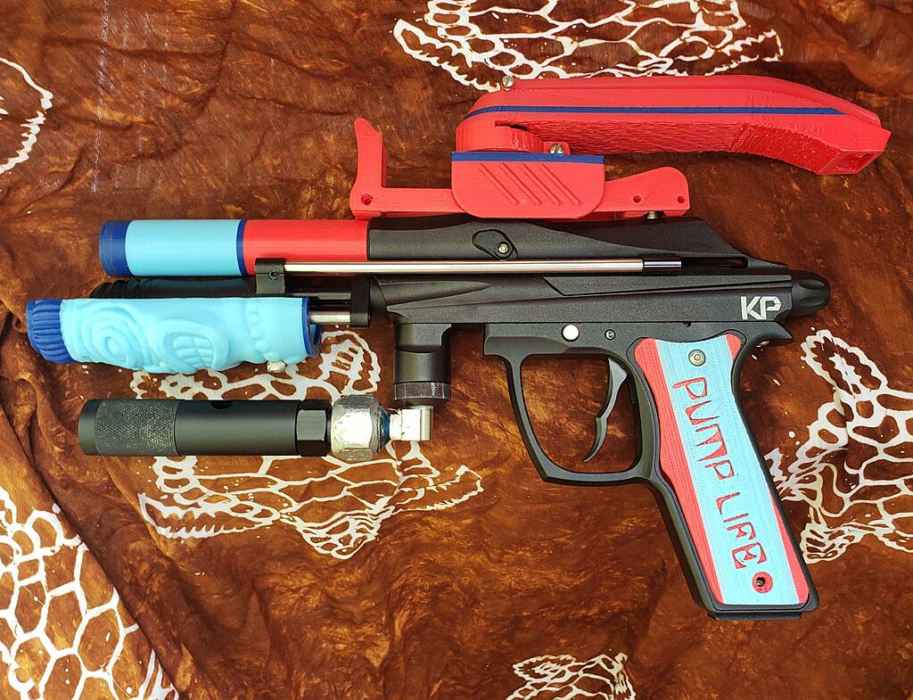

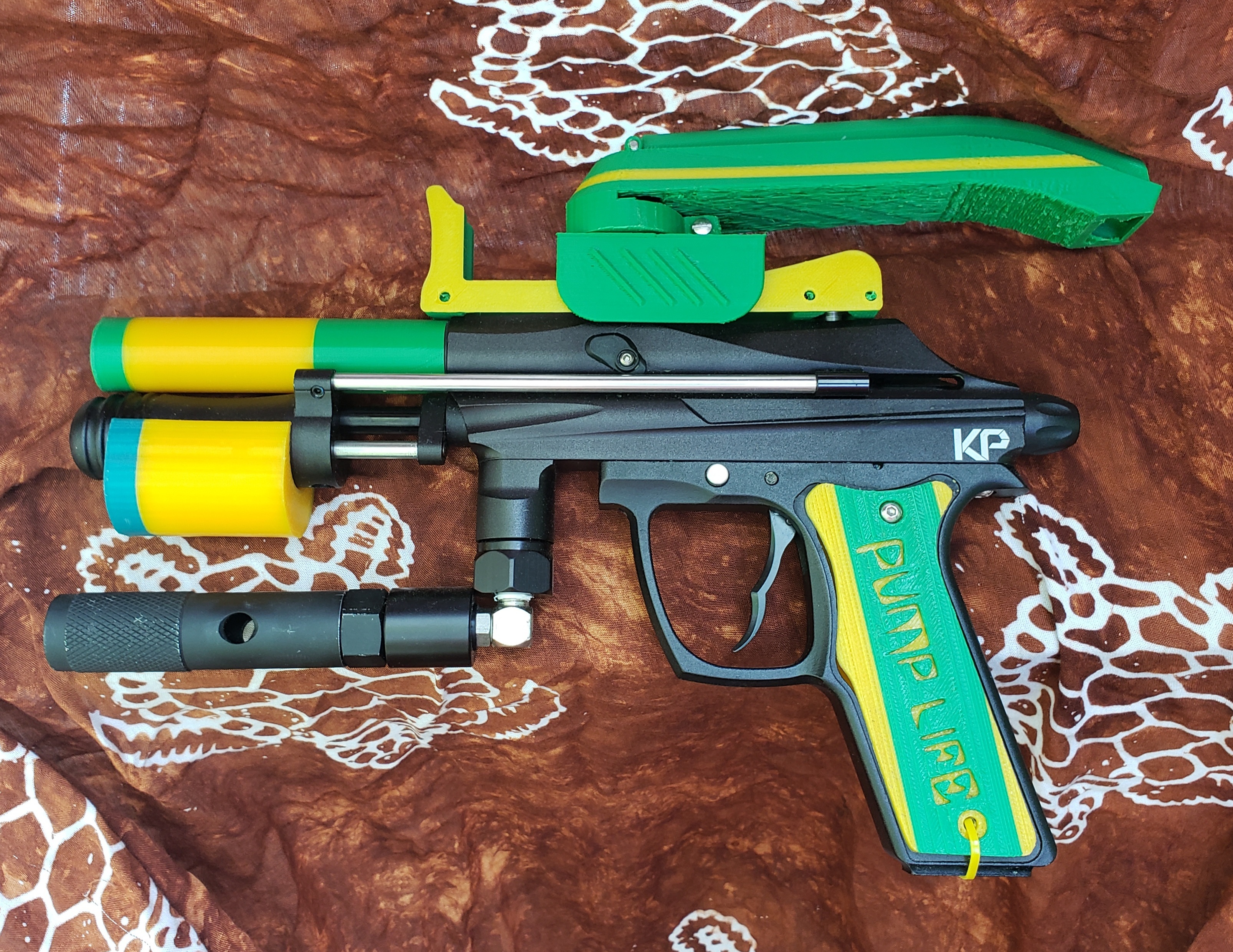

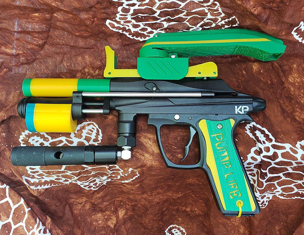

    ​ Duel "Azodin Abomination" KPs, meant to be used together and still qualify for Stock Class 2.0 rules. Started as backups with the boxy stick feeds for Stock Class 2.0 compliance. One in case my printed marker didn't work out and another to get a buddy back into paintball via these awesome Stock Class events.​ Click image for larger version

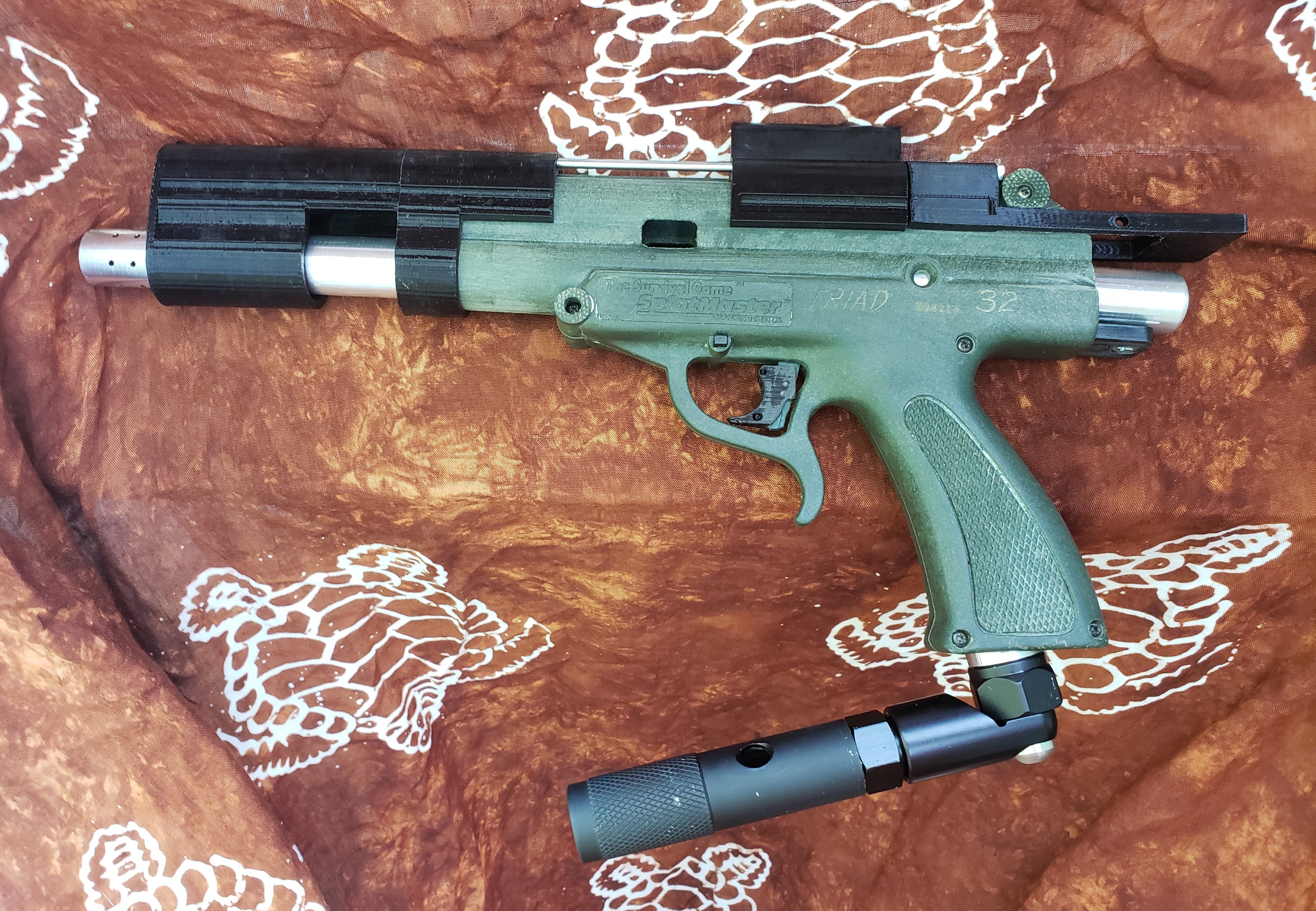

    "Triad 32" Splatmaster with printed augmentations and a Kit's Kit. Found in a local Army Surplus type shop that promptly disappeared like a traveling merchant who just sold you a cursed Monkey paw. It was in rough shape with a busted front end and a barely functional infinity ring doing its best. Chopped off the wounded bit and made a body kit to hold it all together and played with some features. It used to be a rental, No. 32, at Triad Paintball NH which is now Rock "Not-Paintball" Airsoft field.
    • printed modular body kit, better supports a top tube and longer barrel, trigger shoe for comfort and a "Beavertail" for the same reason you'd have one on a cocker.
    • Kit's Kit from MCB, all new internals and freak bored barrel.
    • Palmer's 90deg because Island Style.

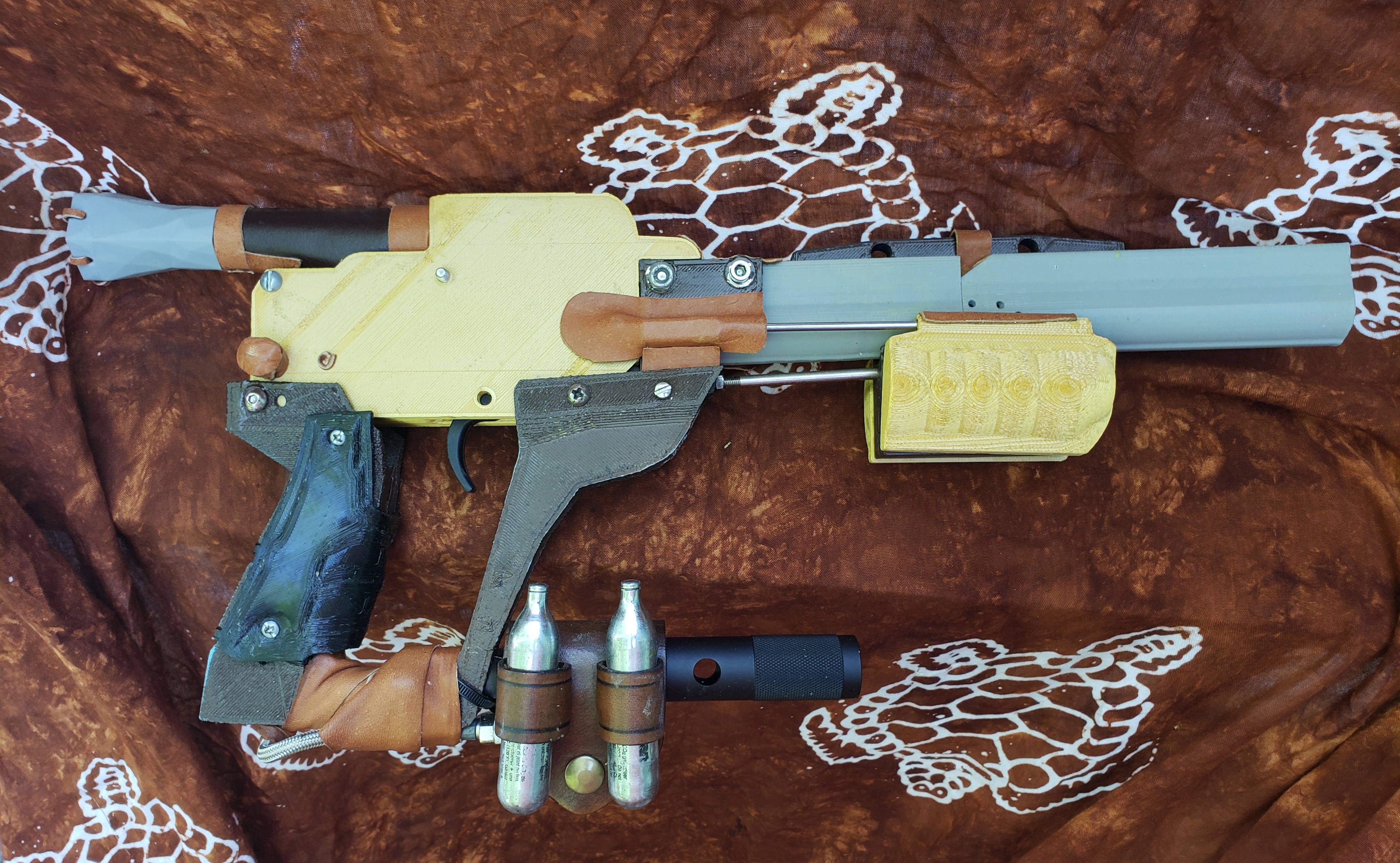

    The "Mako Shark" project "Western Style", a mostly-printed custom marker using JTER2 internals.
    • Everything than can be printed is printed on this marker. ABS Barrel (freak insert press fit atm), PLA body box, PLA grip frame,PLA pump handle, PLA speed feed, TPU grips and detents. MCB thread Link.
    • Leather scraps and accessories.
    • Island Style.
    • current aesthetic is for the Western Scenario Saturdays during the Slim weekend events.
    ​​ Click image for larger version

              I love your "Mako Shark" project "Western Style". It reminds me of Woody from Toy Story!

                That's a new idea for the azodins. Have you tried it in a game?
                • AtomJaay
                  AtomJaay commented
                  Yeah I've brought them out to a few games and they worked out like I expected. Cocking mechanism using the opposite wrist has some bonuses like keeping a bead on a spot while cocking the other pistol. Downside in one airball field game was someone took both barrels to their shoulder in an unexpected and accidental bunkering.
