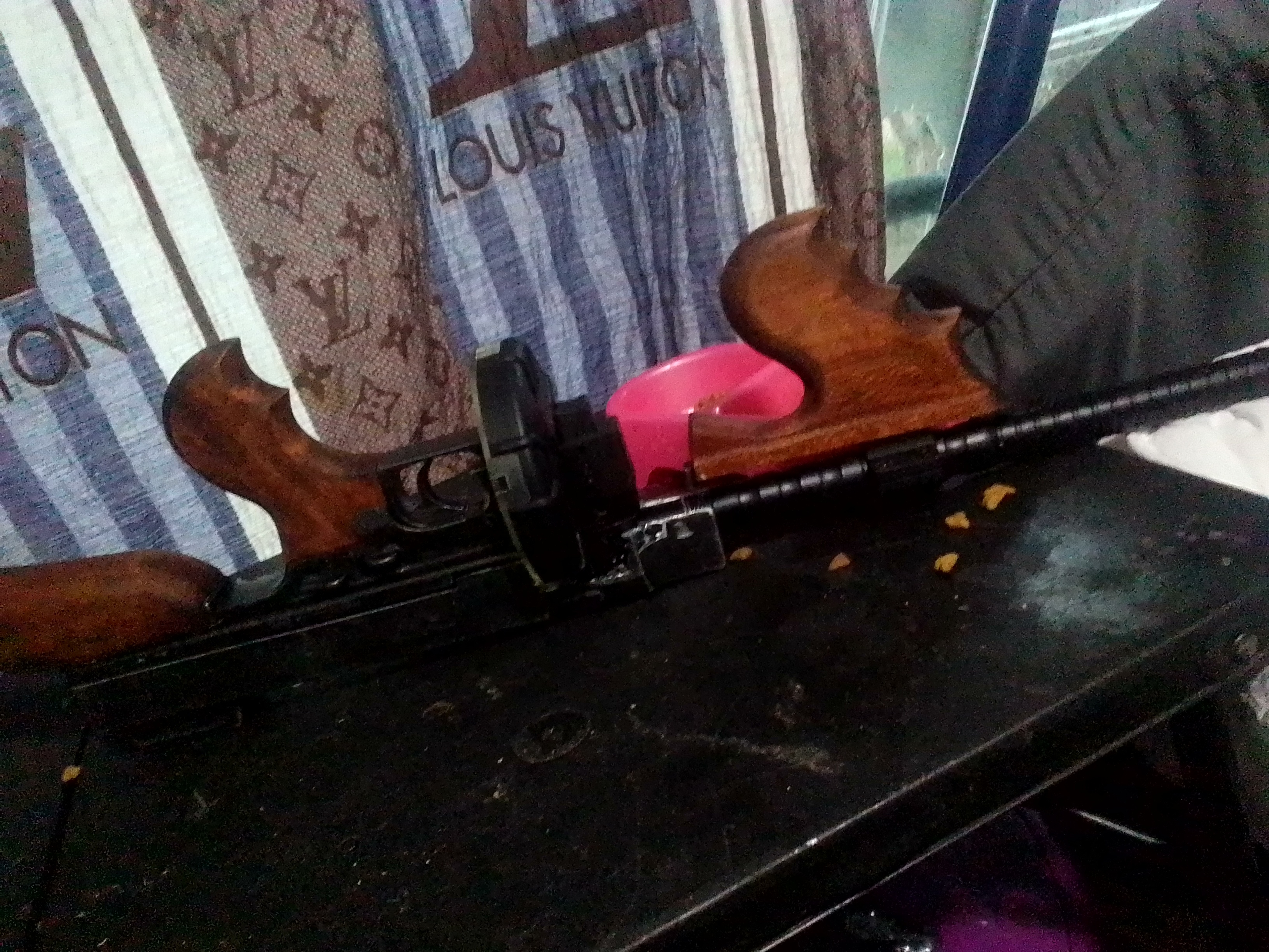

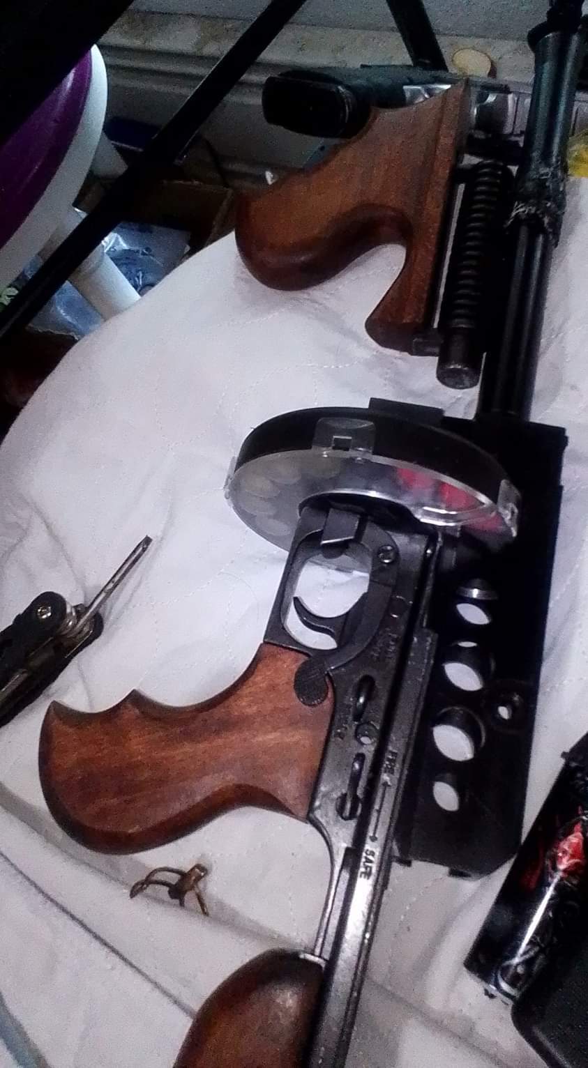

    This is my FN 3O3 TommyKaye Gun I took and removed the box core of a fn303 drum fed less lethal launcher this included valve, sear drum well and barrel and after much grinding I was able to make fit inside of the receiver of all metal and wood replica denix tommy gun they are made to look and feel a close as possible to real thing but do nothing else aside from drive fire bolt inside. Fn303 guts fit very well inside off tommy gun everything linedup perfect I used tommy gun trigger and Linkage to trip 303 sear, it was very easy to rig.
    I had to replace barrel so I used a armson stealth rifled barrel that fits the look.
    as of now I could run remote line but I intend to putt 2 90 gram CO2 cartridges permanently mounted in stock and just refill CO2 with external tank as needed like hidden in violin case. The goal is to keep look as authentic as possible the 303 drum mag is only real give away.
    Id like to make bigger one that fits inside of the fake drum that came with replica like a ADN size drum.

      I would highly recommend against this, the 90g carts are not meant for refilling. They are meant to be a one time thing. You can get small co2 tanks though. 9oz and even 5oz that should work
      Have you thought about painting the 303mag? It's not like people really know the difference between a 303 drum and a Tommy gun drum so I don't think it's that big of a deal. If the colors matched I bet that's all you would need

        Outstanding work! Could you attach the foregrip to the front side of the mag retention block? It would be a little bit more true to the gun design rather than the barrel clamp.
