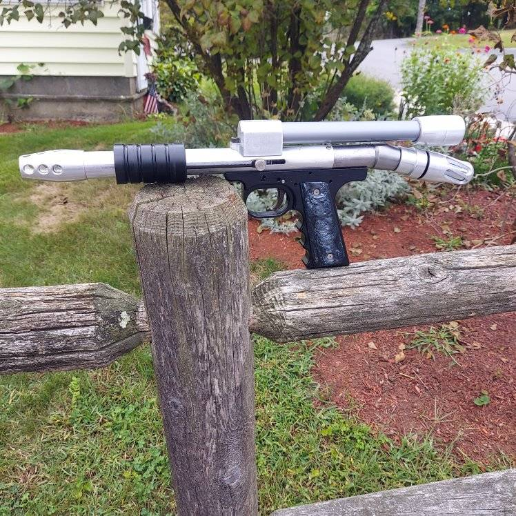

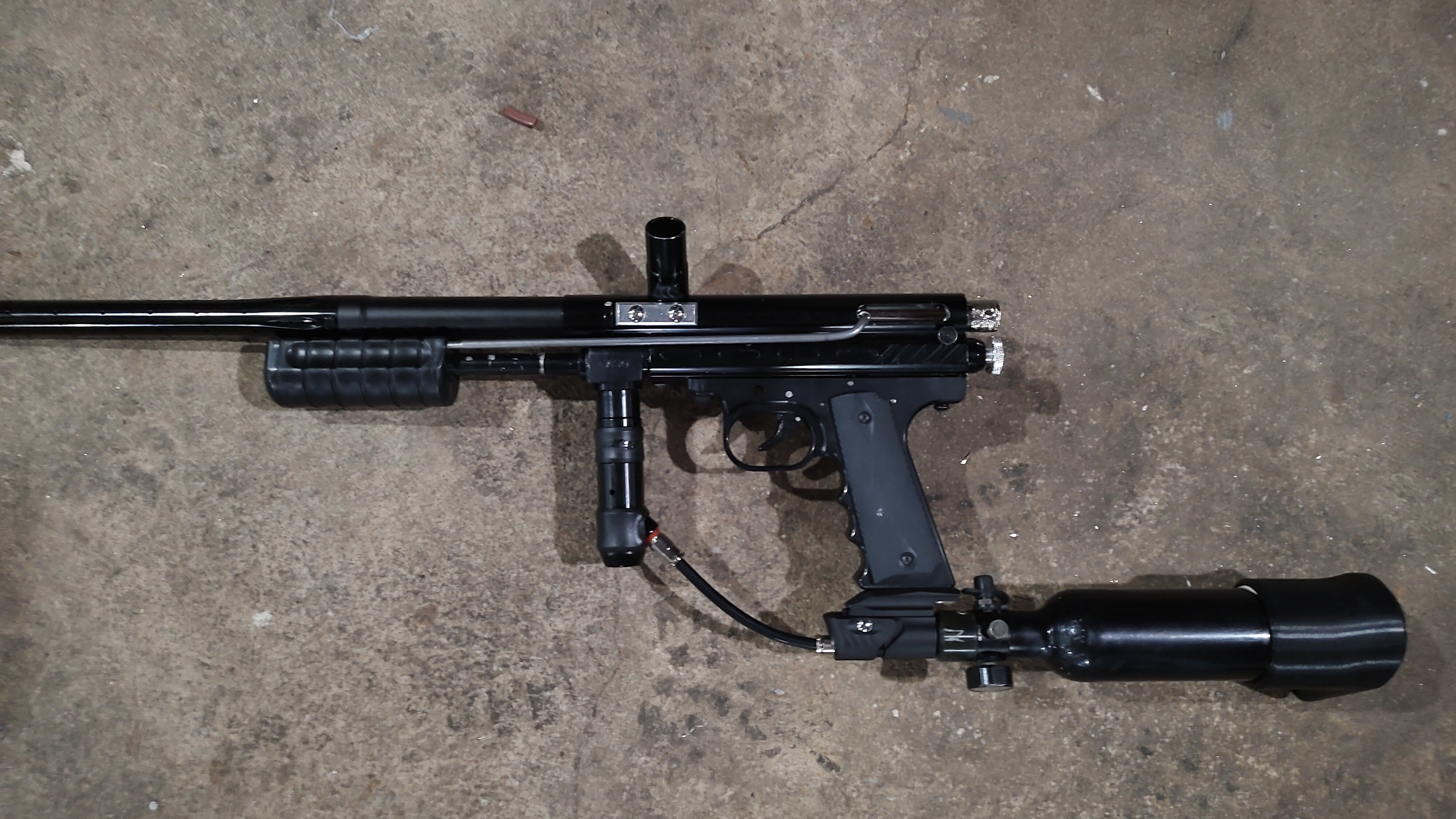

    My current configuration for the "Sni-con" Spyder pump build. Running about 375psi, I think I just need to lighten the hammer to get the rest of the bounce out. There's so many different parts on this build from many different markers, but this thing is as smooth as my WGP cocker.

      I was just about to ask about yours, I thought I remembered you making it stock class, I like that setup
    • JeeperCreeper
      JeeperCreeper commented
      I've been tuning it recently. I think I need to de-volumize it to run 12 grams, but it's a great Mod-stock pump. I have a feedneck for it as well, but I always take it right back off.

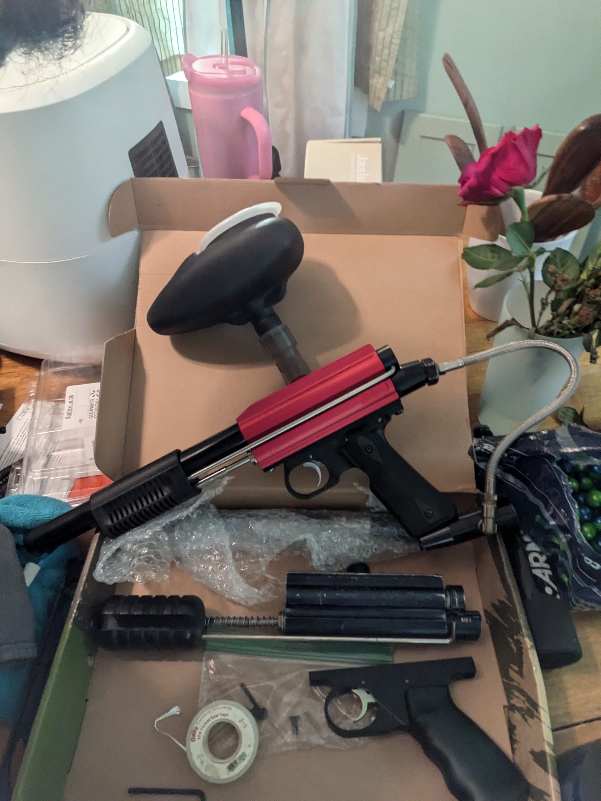

      Well the Spyder finally holds air! Just need to sand down some tool marks on the pump guide, and figure out the pump rod to bolt connection and she's ready to rock!
      In my search for parts I also found this zapco(?) marker with a ca adapter. She's got a nice leak currently but I'm planning on getting it up and running as well. Edit: I think this was a secret Santa gift, so I've got no real idea what's going on with it
      I'm really looking forward to this event and really appreciate the motivation it gave me to get these projects finished up (I think I've been "working" on the spump for 2-3 years now)

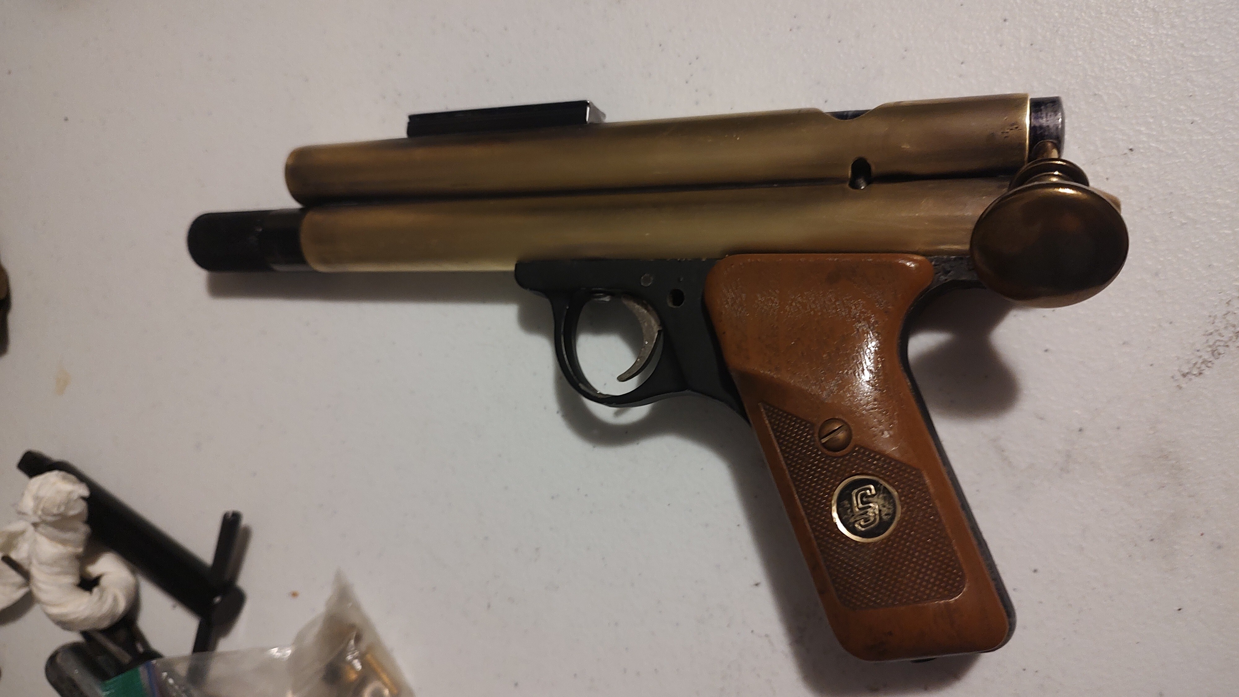

      Finally fixed this old girl and stole the bottom line for my new Sterling for an upcoming 5 man pump tournament
      • JeeperCreeper
        I'll bring my brass version of this, too.

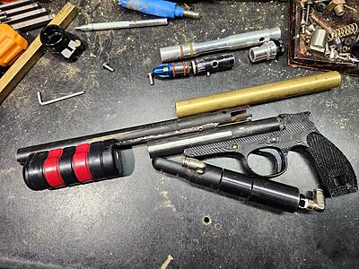

      I have plans...
      I have a bolt from a Trilogy, a bolt from a PGP that will be modified as the hammer, an RVA from a Delta 68, some random Empire feedneck, an Ion reg, a Slice kit, all going into a body made from 2 PGP 2k barrels. The Lazarus valve was given to me. The K-frame was also a freebie. If this works out, I'll have to get a real one for this.

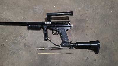

        Well it's not the prettiest, and definitely needs a new pump handle as I'd forgotten I'd cracked the threaded area on the one I planned to use, but she's functional and ready to go if need be!

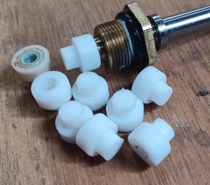

        #23
        FREE
        tigershark cup seals. ill be passing them on toJonnydread so y'all can bug him for them

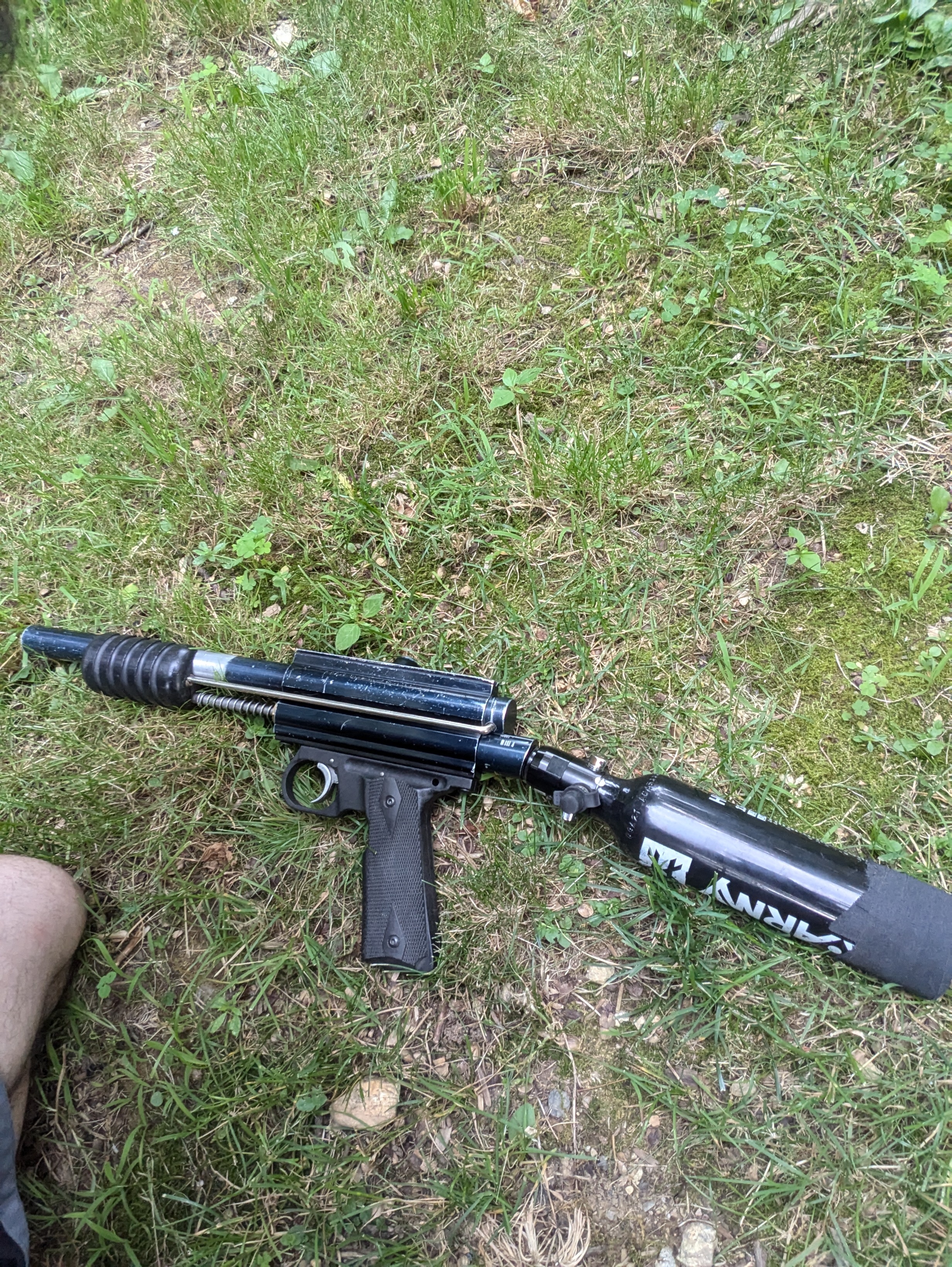

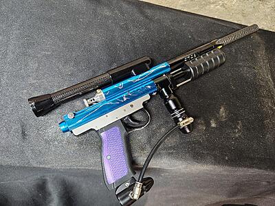

                The spump should be ready to go, as should the tiger shark, here's to hoping some parts arrive in time to fix the leak on this single shot I snagged off Craigslist on Monday.
                Collection
                GITM based out of Warzone RI
                • cheapguitarscheapthrills
                  cheapguitarscheapthrills commented
                  Excellent 👍👍
                • markdem
                  markdem commented
                  Is that bolt handle from a cupboard?
                • Impactfour
                  Impactfour commented
                  It is mark! I drilled and tapped it and threw a brass rod I threaded for 10-32 in it. It's mostly just what I had within arms reach, I'ts likely I'll drill and tap the back of the bolt for handle instead
