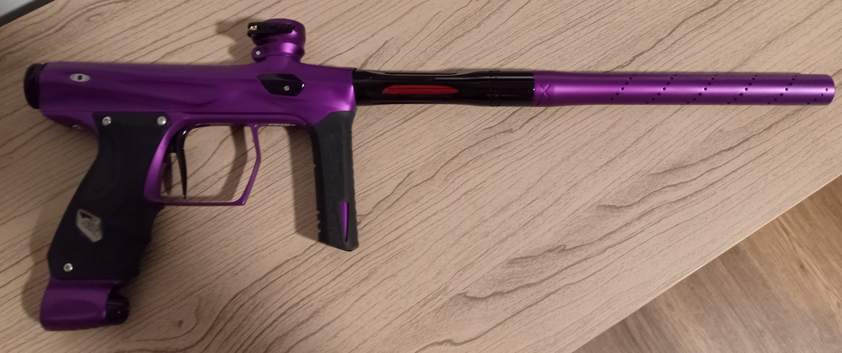

    Nice job on the review. Toss a couple pictures up when you get a chance! Would like to see the purple.

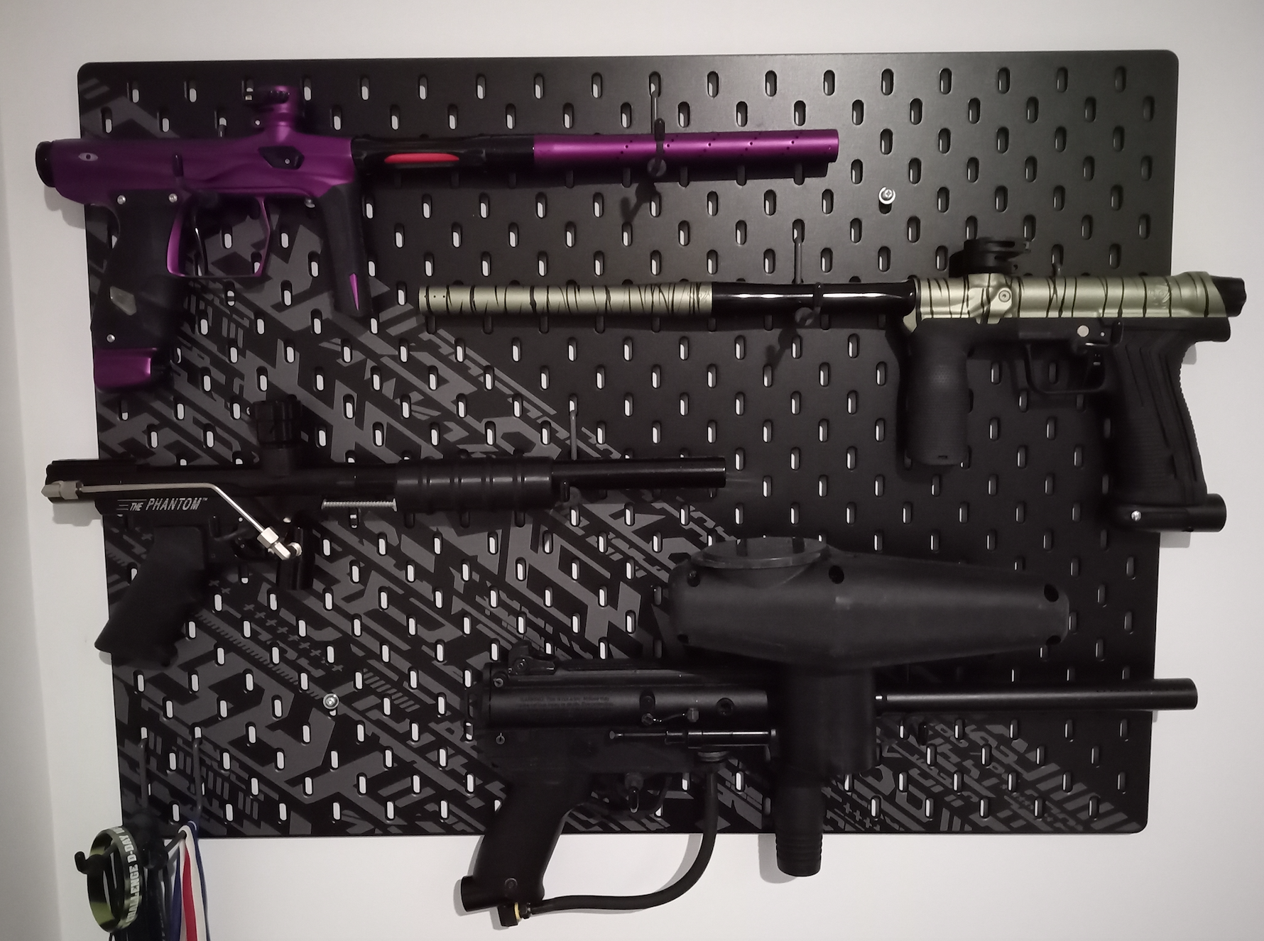

      Well, here's my current gun wall as well as a close-up pic of the Shocker:
