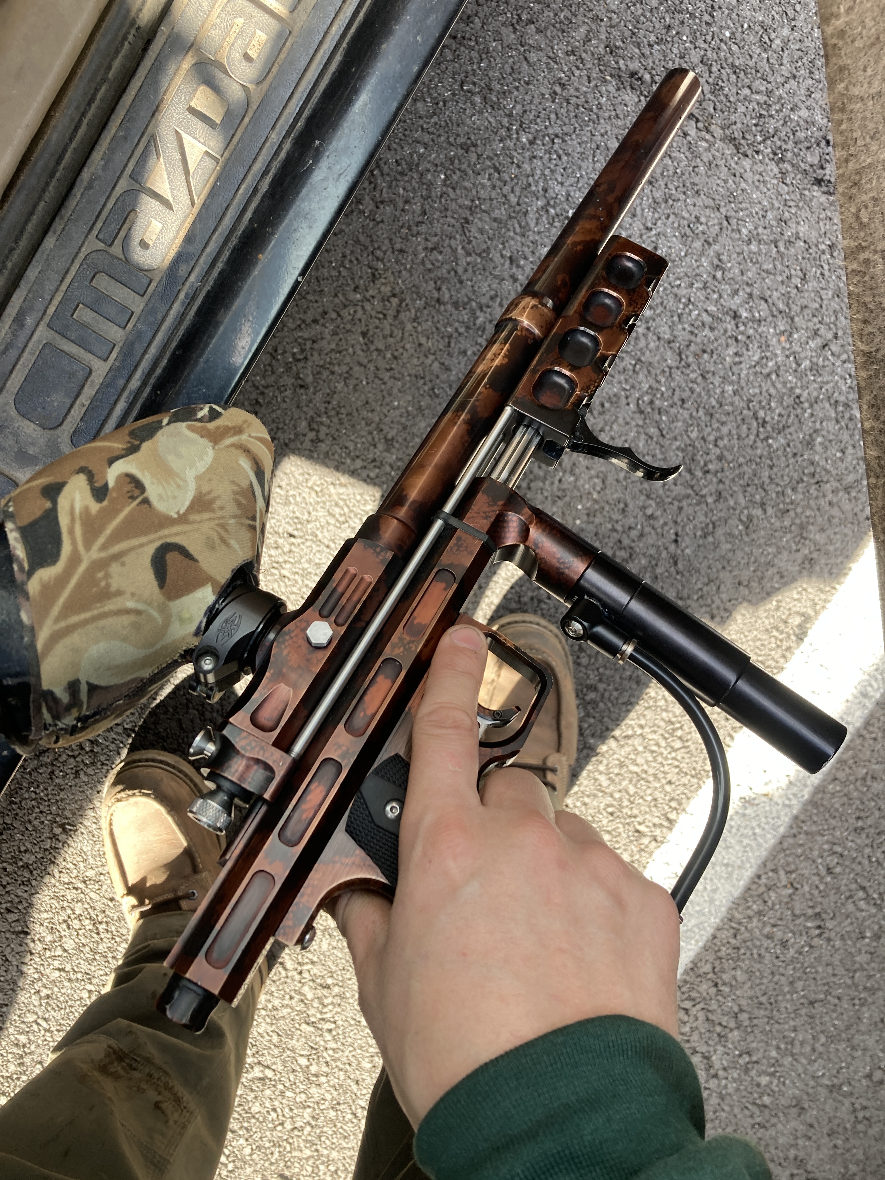

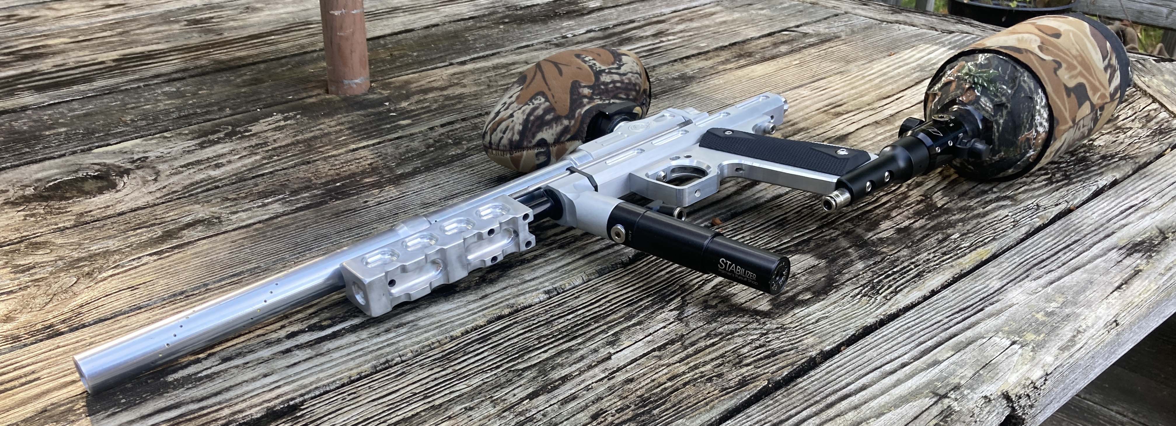

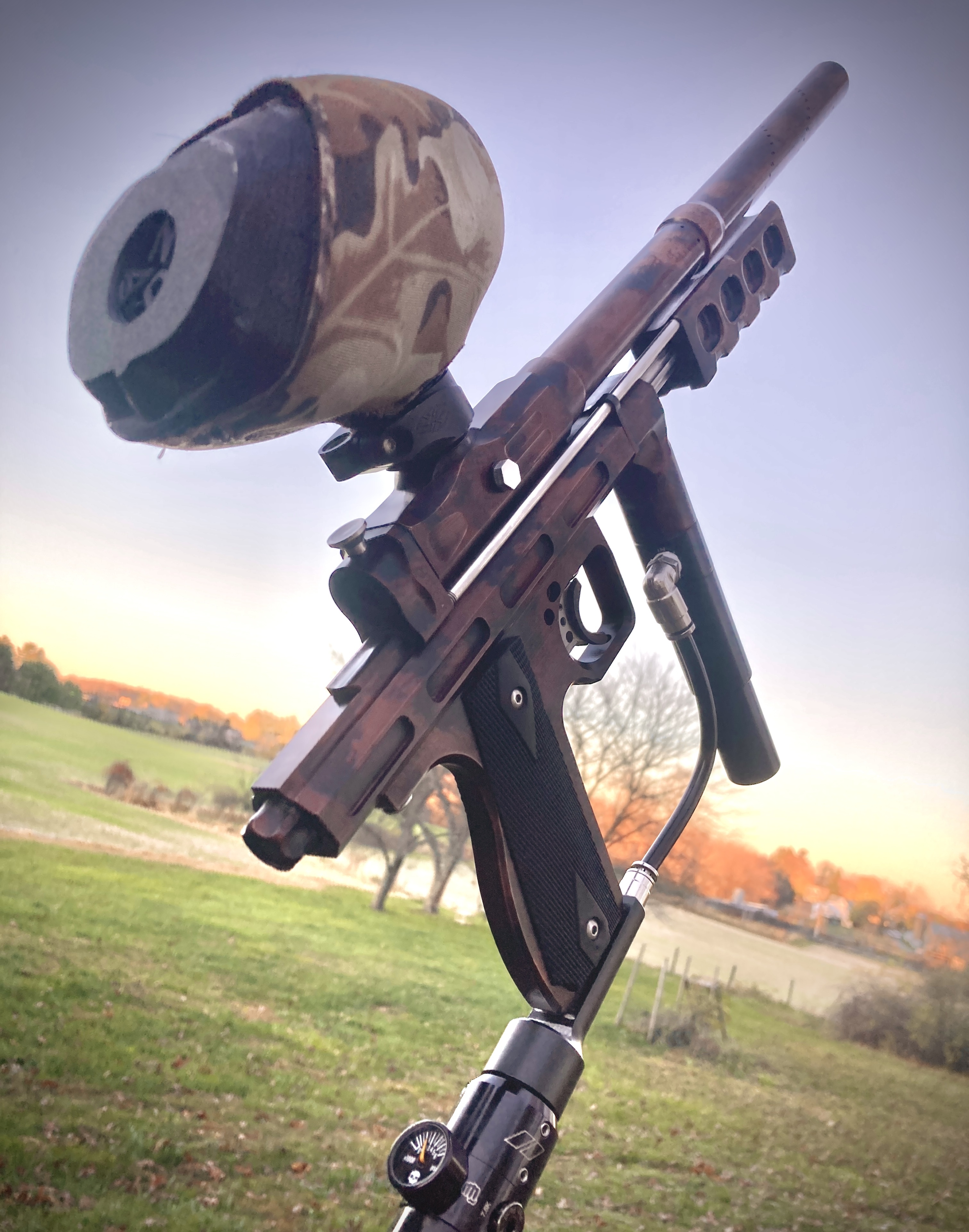

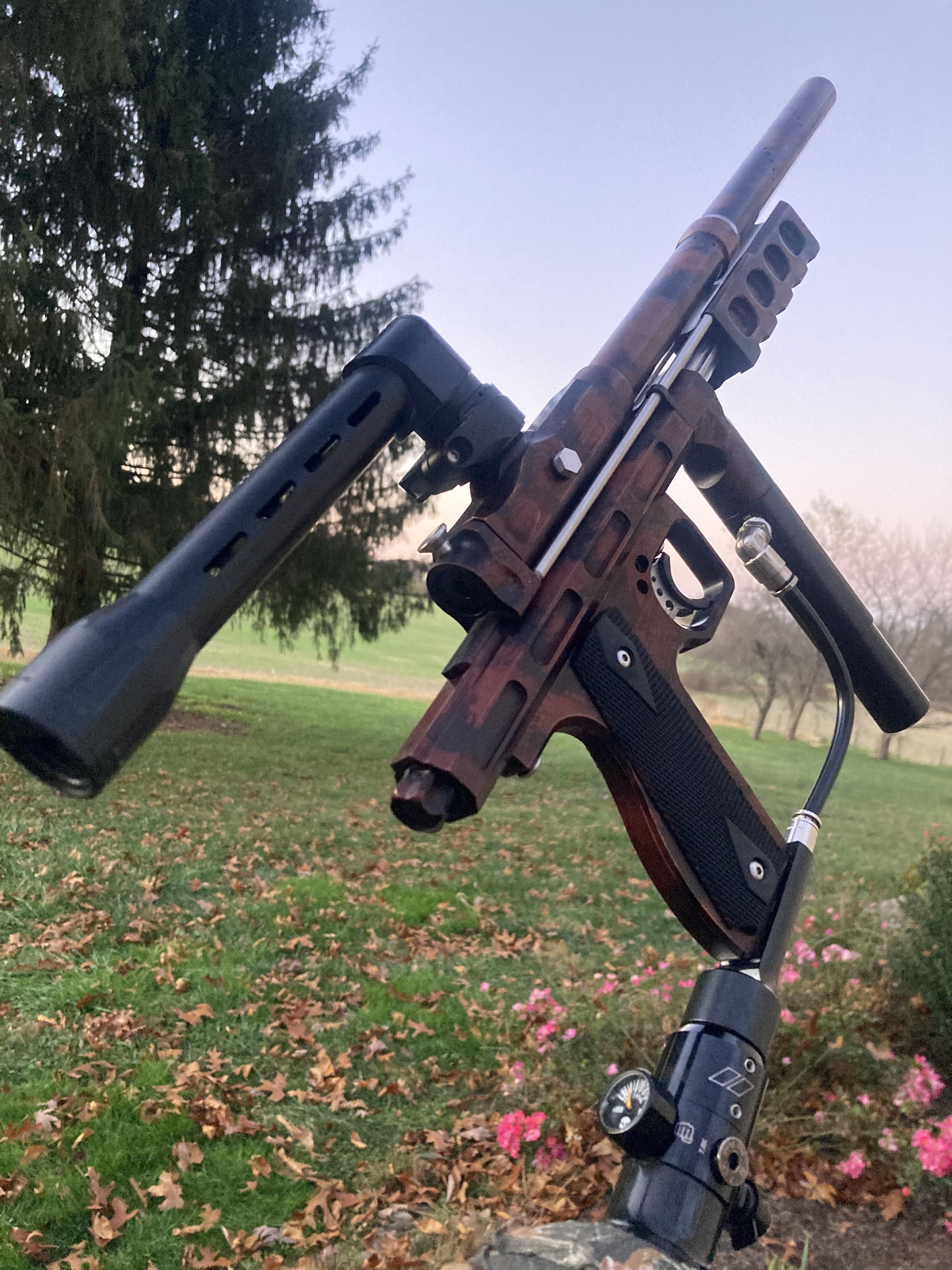

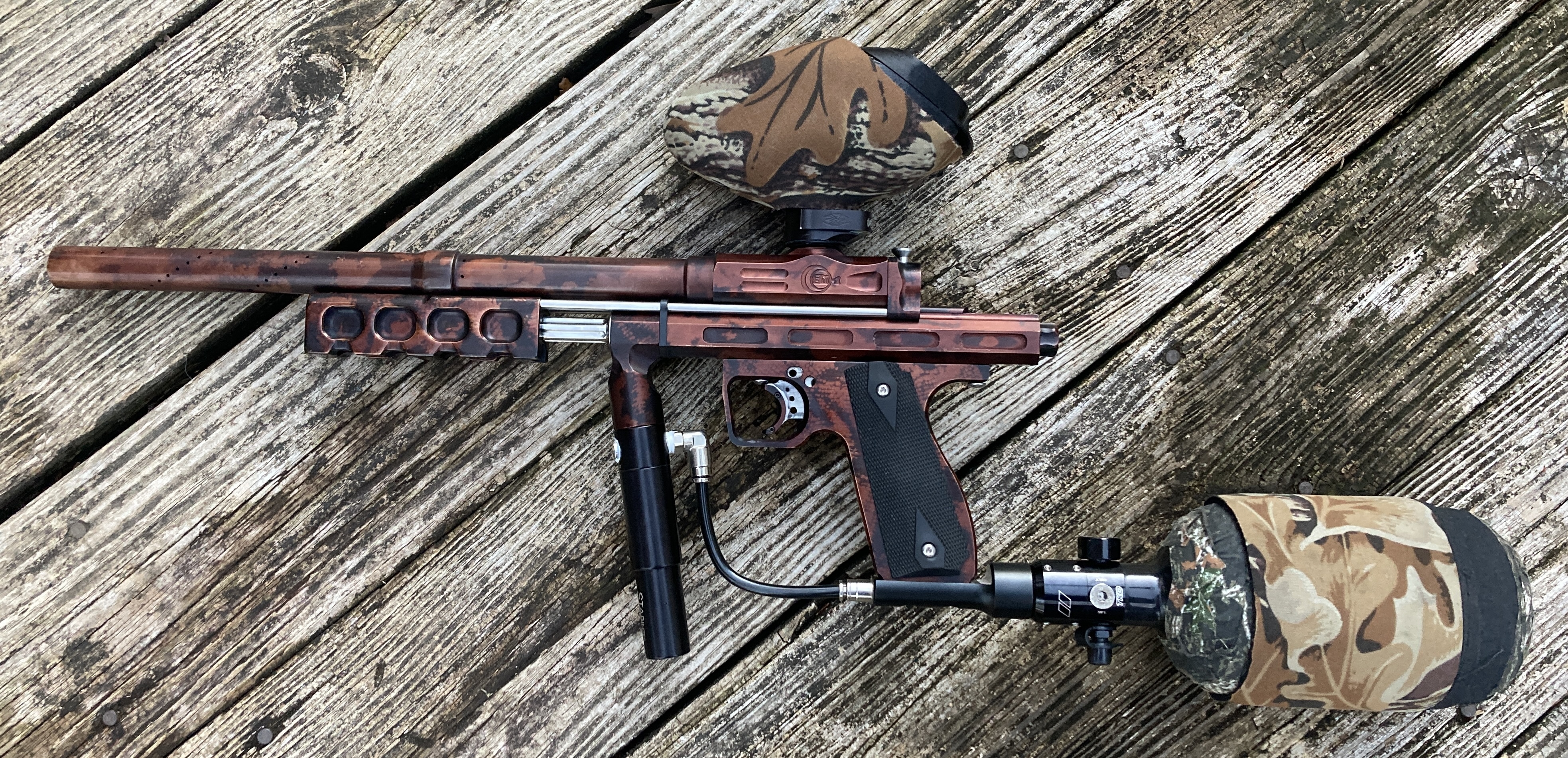

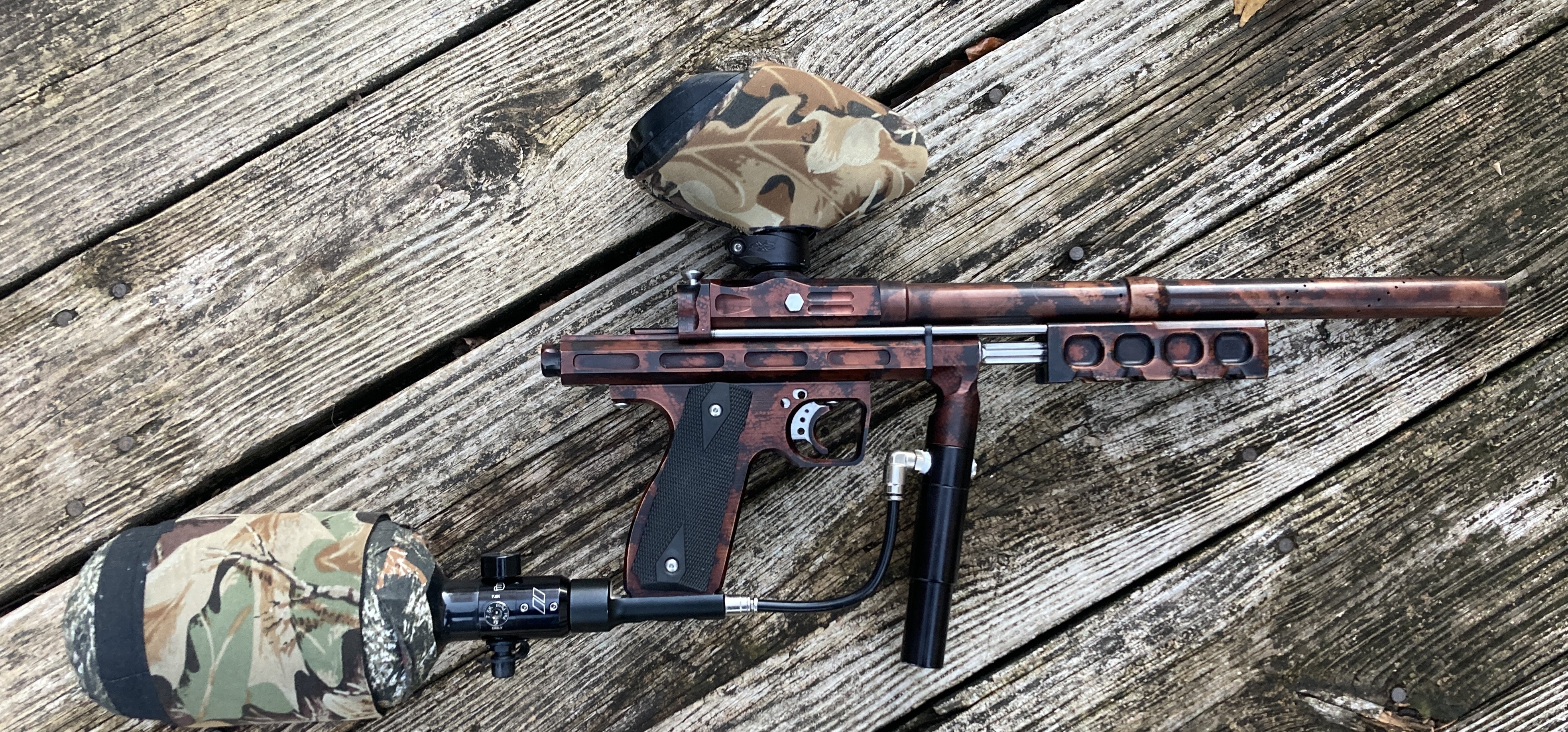

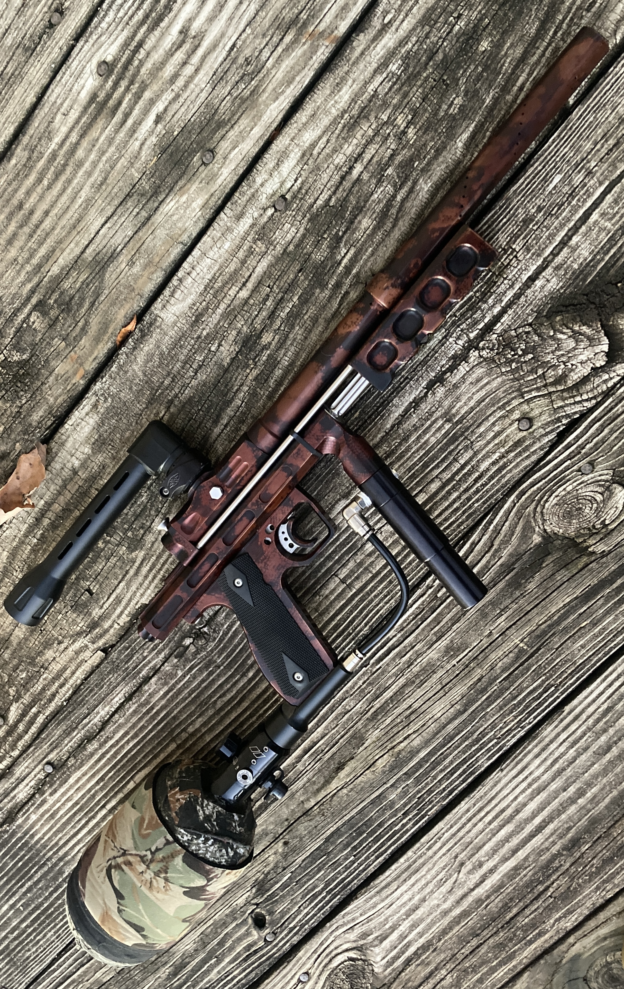

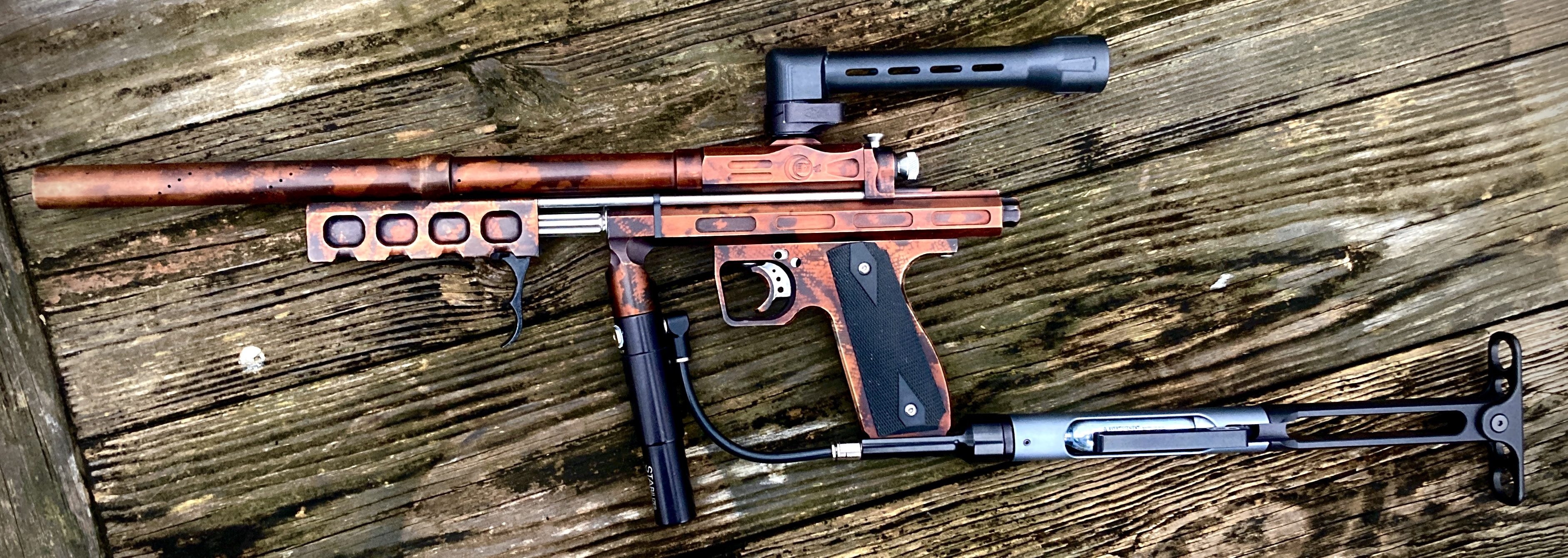

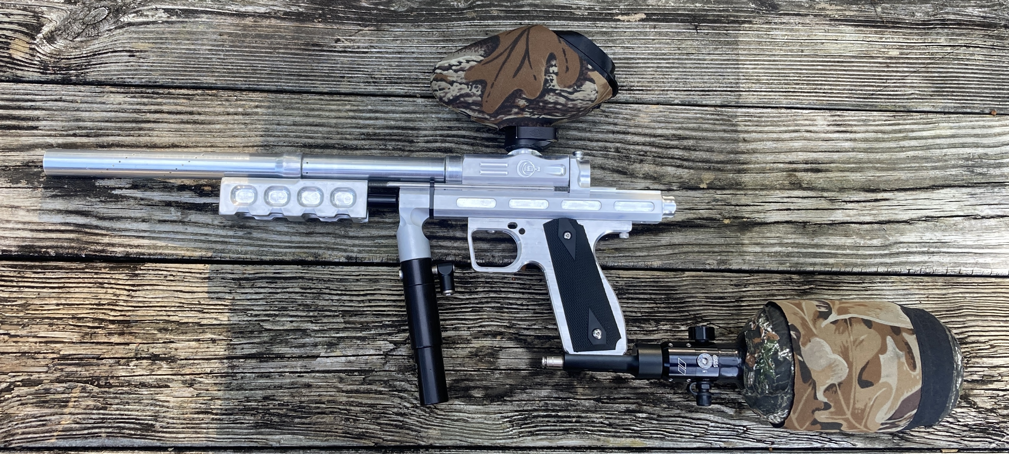

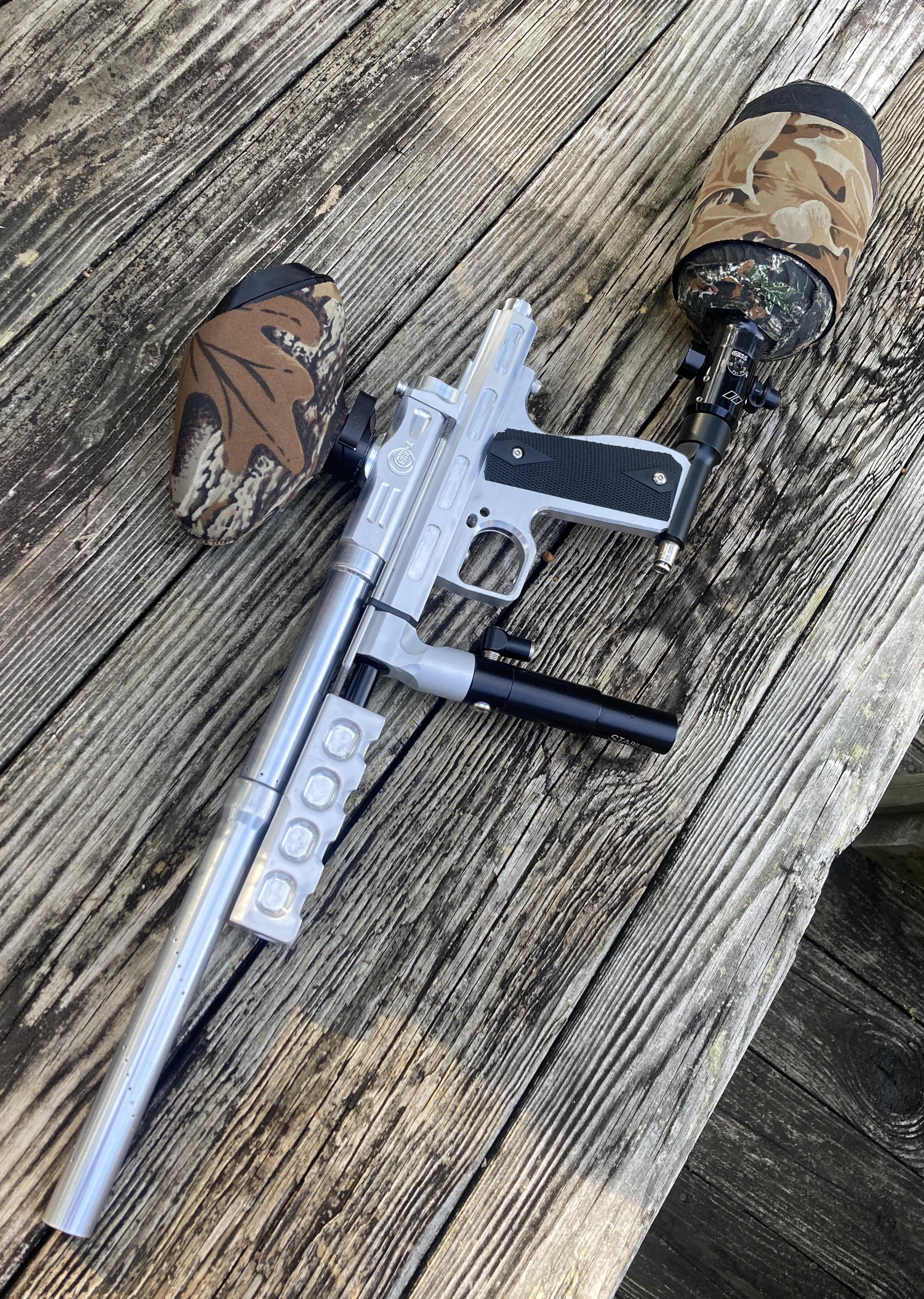

    KMDPB was able to anno my raw parts but before sending them to him, i mocked things up for a few photos.

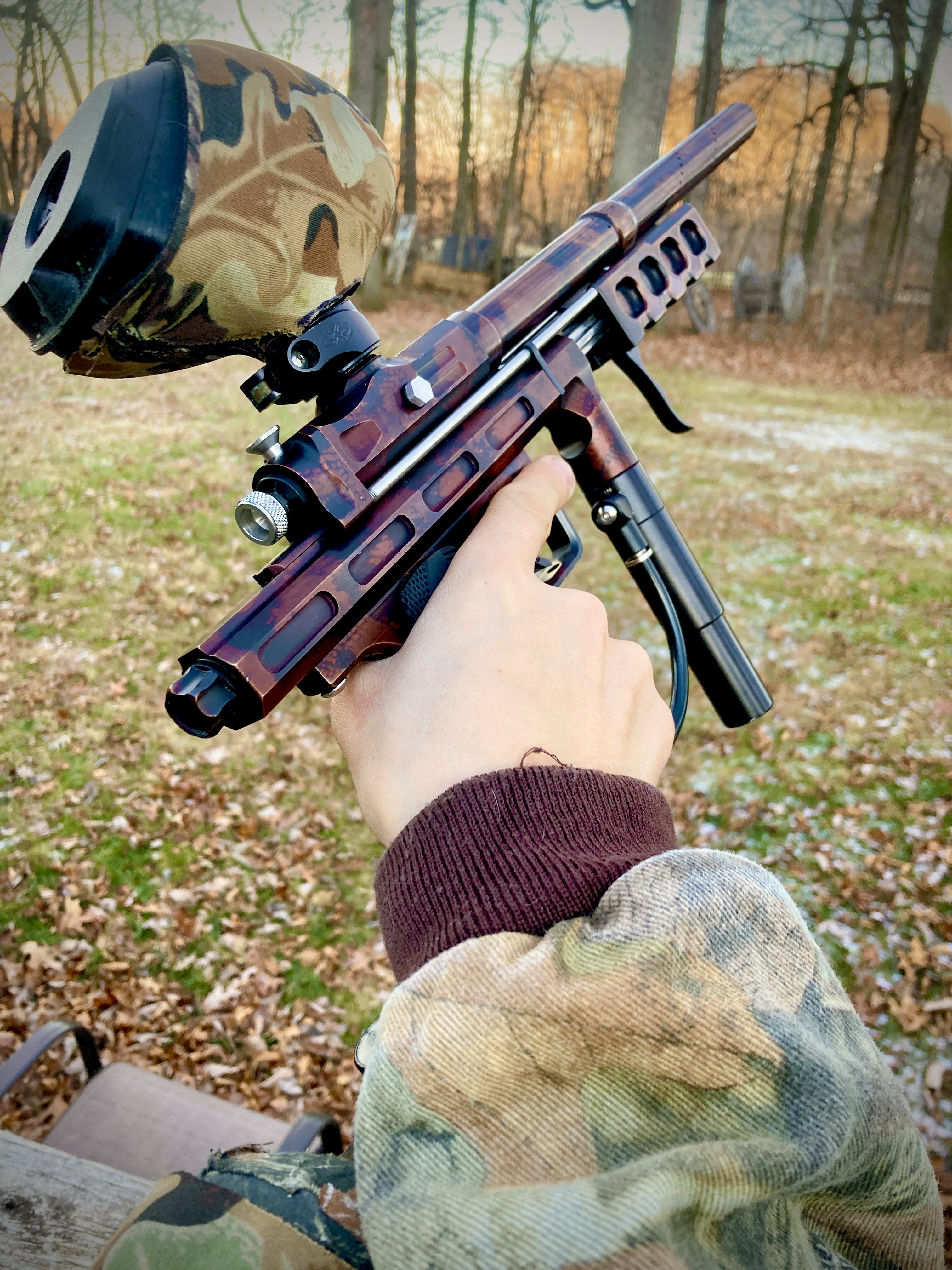

    I went with a brown/black acid wash anno to fit the theme for my build : The Dirty Sanchez!
    Dave brought my parts to our mod stock game this past weekend and I could not be happier with his work! Super affordable and fast!
    Saturday night i slapped things together and Sunday morning, I was able to play with the gun for a few great games ...... until tragedy struck.

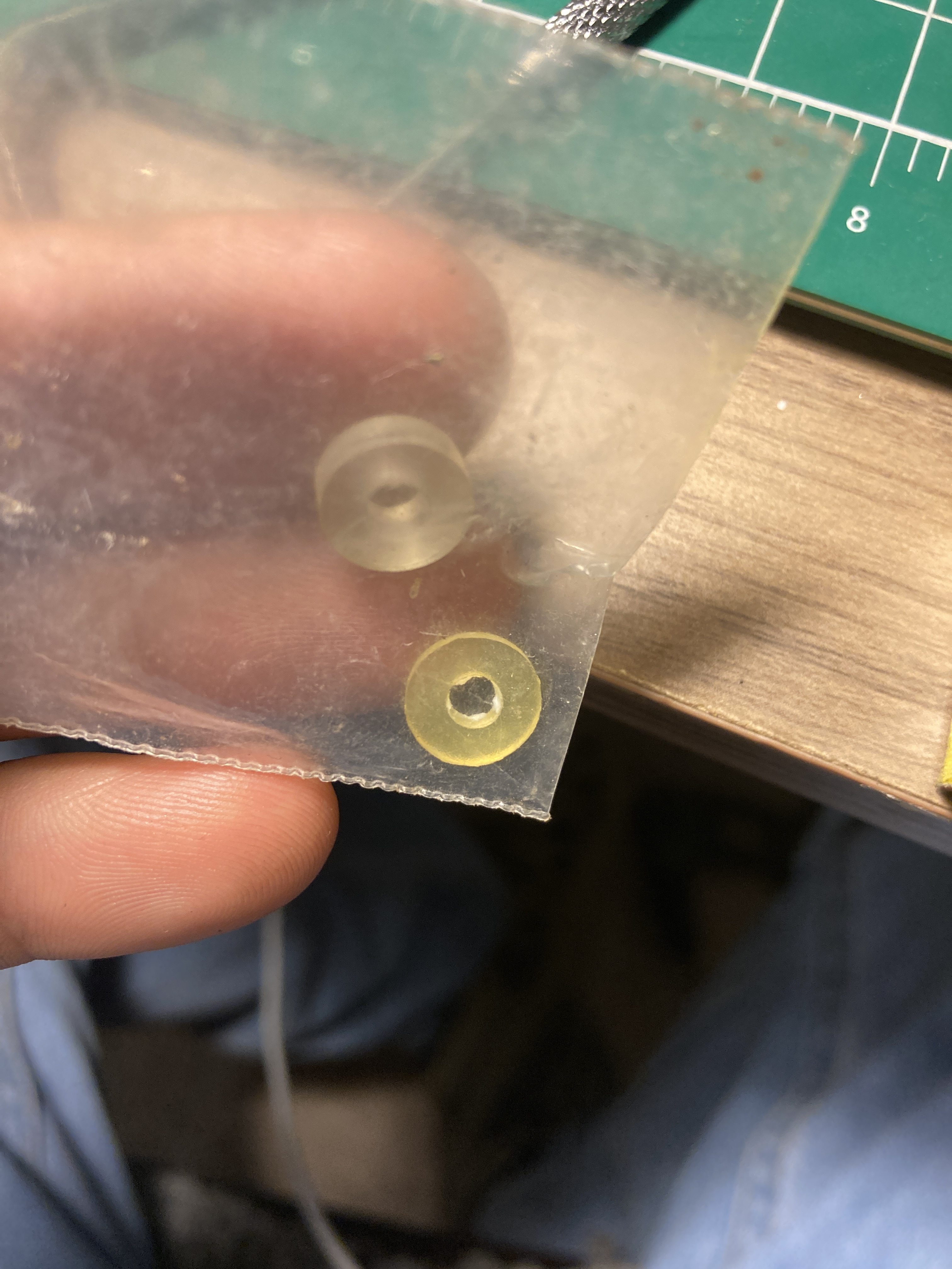

    The grub screws that attach the handle to the pump arms had loosened and fallen out! It seems the holes have a relatively short section of threading and the grub screws that came with my kit were not able bite into the stainless arms. Blue loctite was not enough and, so, The Dirty Sanchez was put away and I finished out the event with the various other pump guns at my disposal.
    The next day, I visited the hardware store and loaded up on a few different options.
    Because the handle is aluminum i did not want to over torque the screws and risk stripping out the threads.
    I ended up drilling the rods out, in line with the bolt holes and threading in nylon flat head screws, effectively pinning the handle and rods together into one, solid piece. while i dont plan on having to remove the screws anytime soon, if they shear off or the flat head strips out, they can easily be drilled or even melted out and replaced. For now, they are working perfectly!

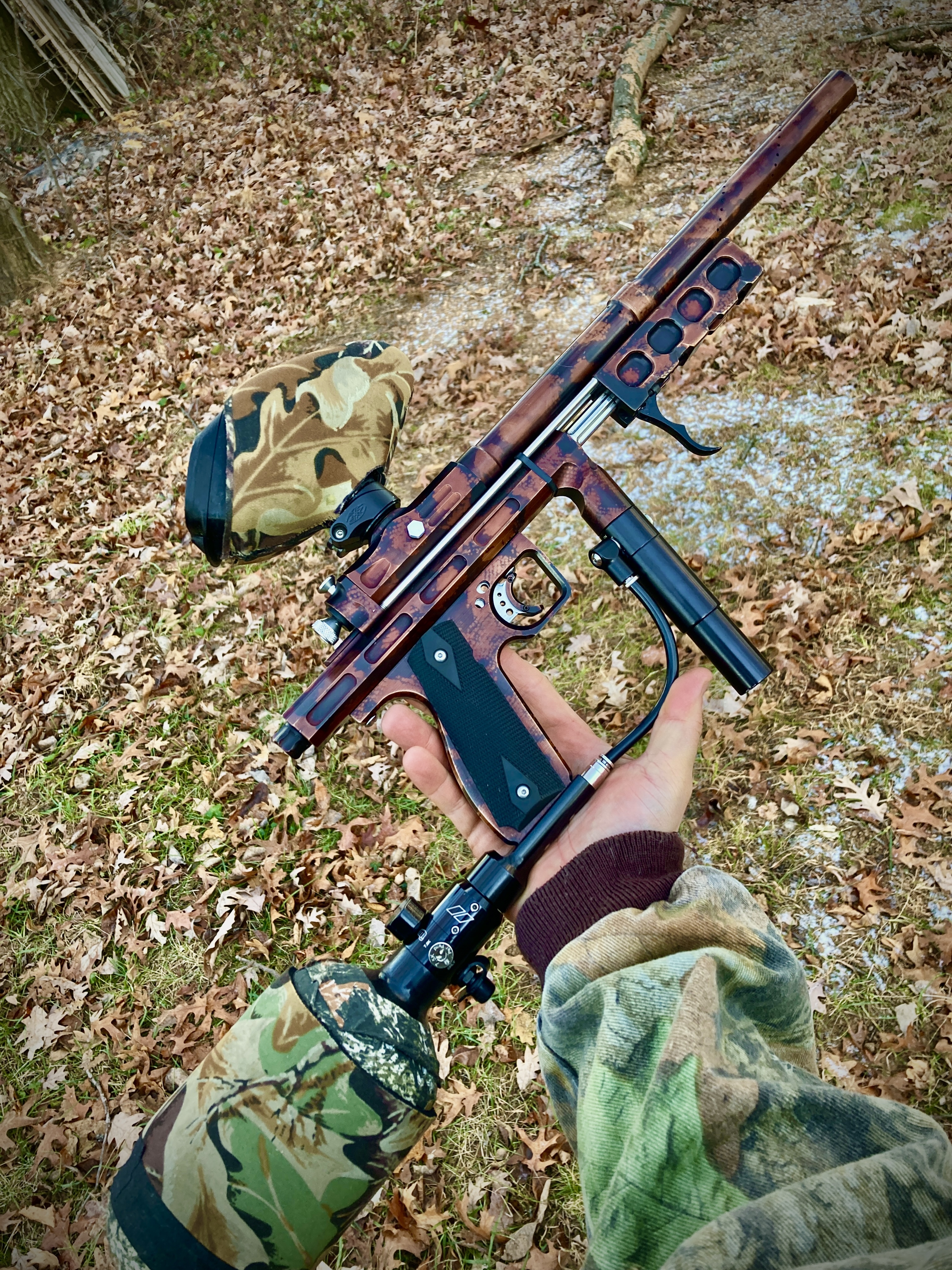

    This is my first 'extended reach' bodied marker. I usually like my cockers and snipers mini'd and tight as possible. I can say the added length and adjustable pump handle balance the gun very well and I appreciate this layout. Feels great, points great!
    Parts list:
    SM1.5 kit
    Empire Sniper Halfblock Bolt with orings removed
    AutocockerParts.Com Gold Kit 9/16ths Internals
    Inception Designs universal Hammer
    Mozak Ver.1 Thin Humpback .45
    Shocktech Plate and Shoe
    FreeFlow Roller sear
    Random Springs
    Pearce "Hourglass" Grips
    Freak Bored 14" Bob Long Longshot Barrel
    Inception Designs Fluted Banjo Bolt/Main Pump Guide
    I spent a few minutes polishing this piece as there is metal on metal contact with the handle.
    9" Inception designs Stainless pump arms (had to be cut down ~5/8" to function at my length preference)
    Palmers Stabilizer Inline Reg
    Sconi Duckbill asa
    cheapo air fittings and black macro for now, but ill find some braided stainless at some point.
    Empire Mini Nano clamping threaded feedneck

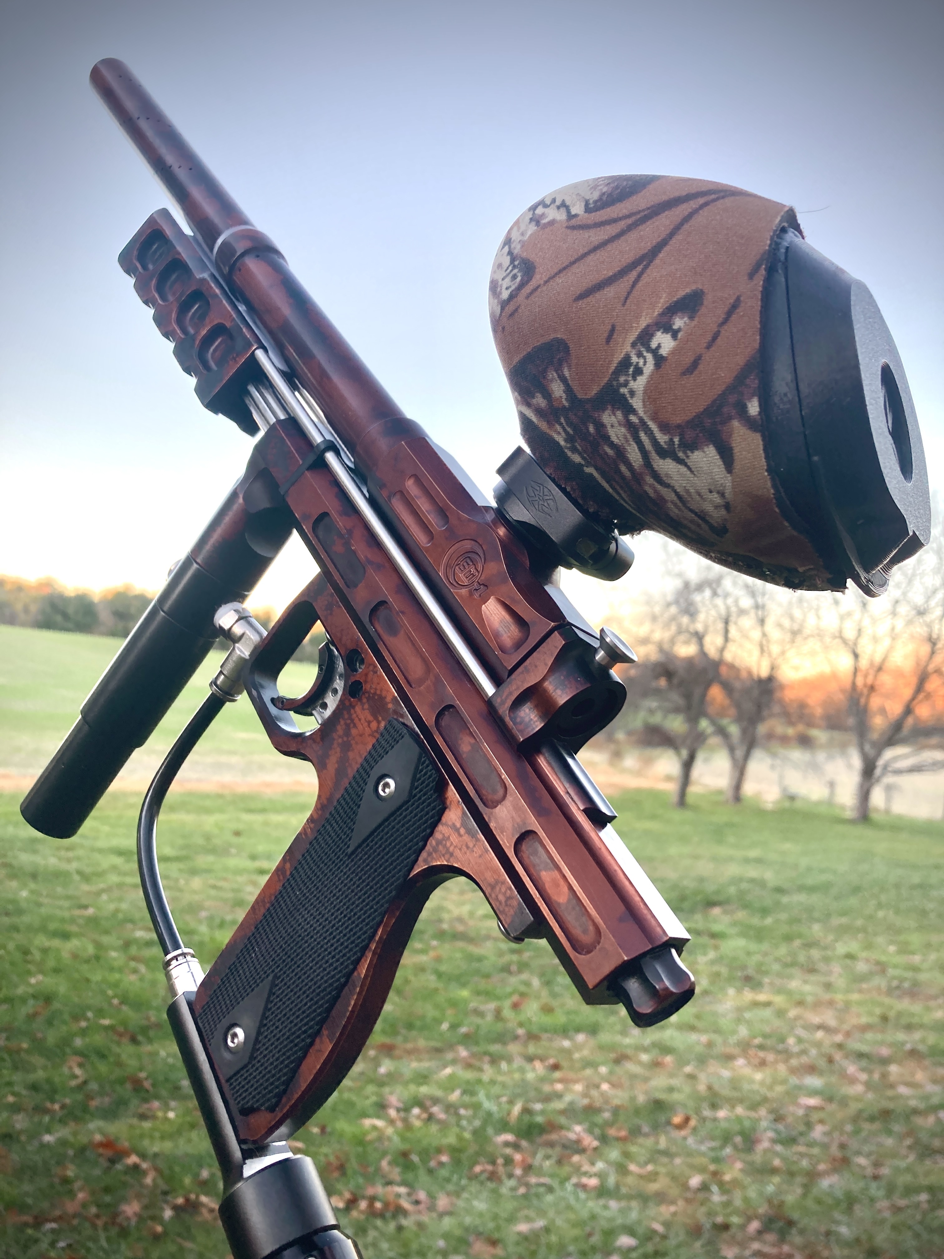

    My dedicated air source for this marker is the 36ci/4500 HK tank paired with a Powerhouse TKO reg, outputting 400psi. A very tight, very lightweight setup. Perfect for my intended use, Mod Stock and Limited paint games.
    Ive got a Jolo with the feedneck cut down that works with this build flawlessly and a delrin stick feed for modstock shenanigans.
    Shoots great and straight with consistent chrono numbers and very good efficiency. Shot feel and sound signature is about the same as a standard wgp pump.
    So far, after the bit of extra work getting the pump handle to attach correctly and the usual tuning, Im loving this kit! Is it a bit of a pain to find all the other parts and get them modified to work together? yes, but custom builds are always that way. Is the kit more expensive than the original kits that were available on ebay? Yes, but they are still in the average range of what is currently being offered. SM1s pop up every now and then but its great the company is still active and providing new, available options. Is this basically just a Empire Ressy Sniper with way more extra steps and the added hassle of getting it annoed? Kinda, but you get to use any internals, reg, barrel and frame you want from the beginning. Personally, I had to have a slide trigger and wanted a match anno shoe.
    AND YOURE SUPPORTING THE LITTLE GUYS!
    If youre willing to spend a few extra dollars and time putting them together, I highly recommend the 1.5 kits! And if you ever catch me in person at the field, as with all my gear, please borrow the SM1.5 for a game or two and see what you think!

      My buddy Aaron normally shoots a TM40, he wanted to try out the Sanchez so we swapped for a round today. I got shot by a teammate early on but he had some great kills and loved the gat. Hoping he joins the Dark Side soon!
      https://youtu.be/T2wob1qMY30?si=-gjqtyRy_JUC9O97
      These pics do a great job of showing just how tight this setup is. The tank is soooo light n teenie. The cut down jolo doesnt even stick out past your mask. after using that setup all day, shooting his luxe with a "normal" sized tank, full hopper and pack with 4 pods felt like i was wearing a weighted bag and swinging a barbell!

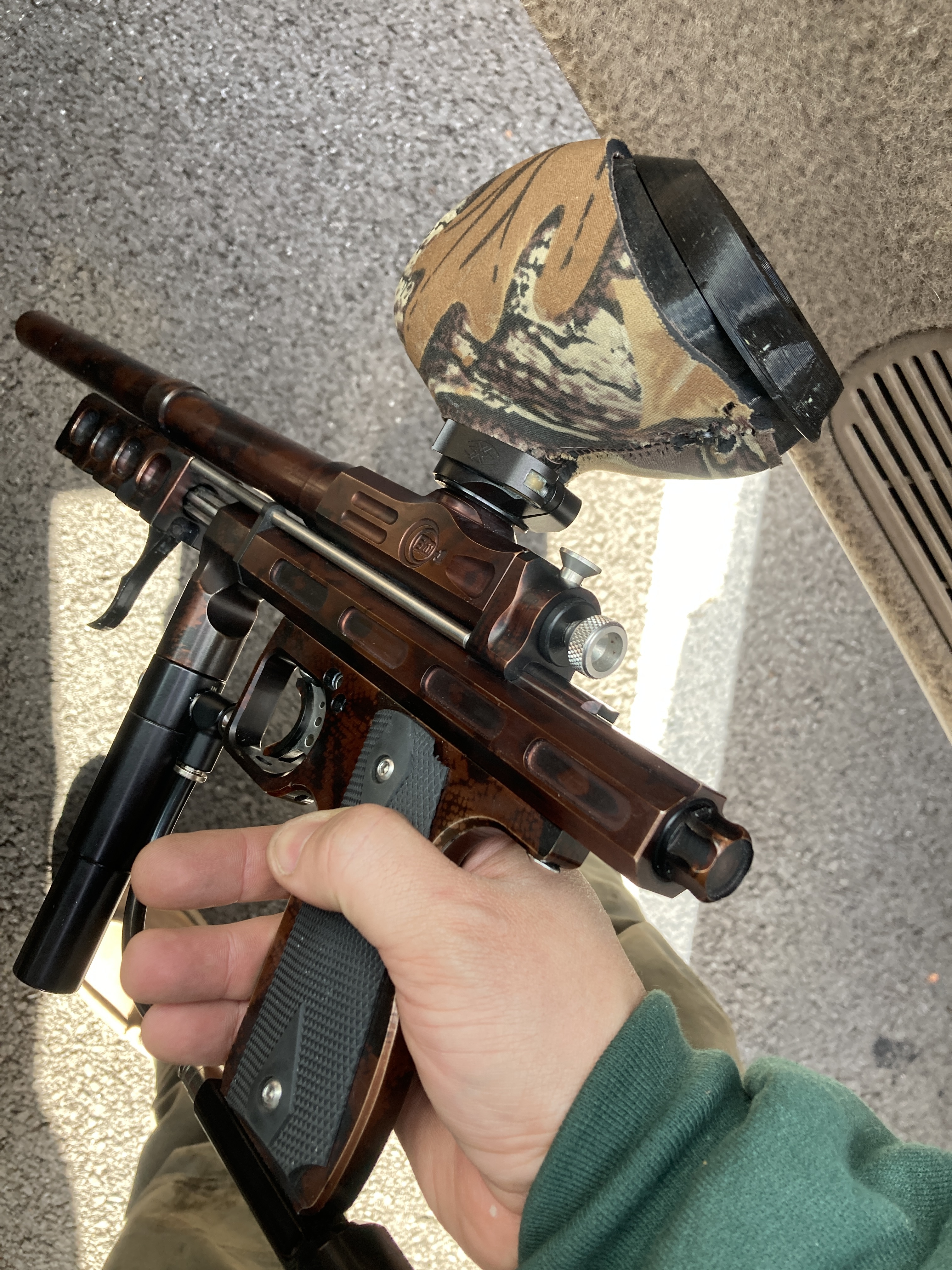

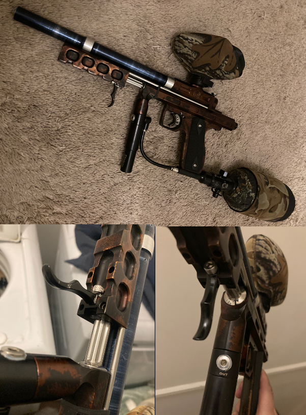

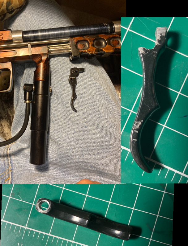

        I made my own Hitman plate from an old Spyder trigger.
        Going with the "Dirty Sanchez" theme, I had to christen it the "Sh_tman Mod" .
        Another small change was the stab getting a CCM fitting. This particular reg has given me trouble since it showed up. All the threads are very tight no matter what gun i screw it into. Initially I had a ccm fitting on there but was plagued by leaks. since it lined up almost perfectly with the Sanchez vasa, I was determined to make it work. After dropping an ICD lever changer piercer seal into the reg before screwing the fitting in, everythings finally tight and quiet!

          Another update!

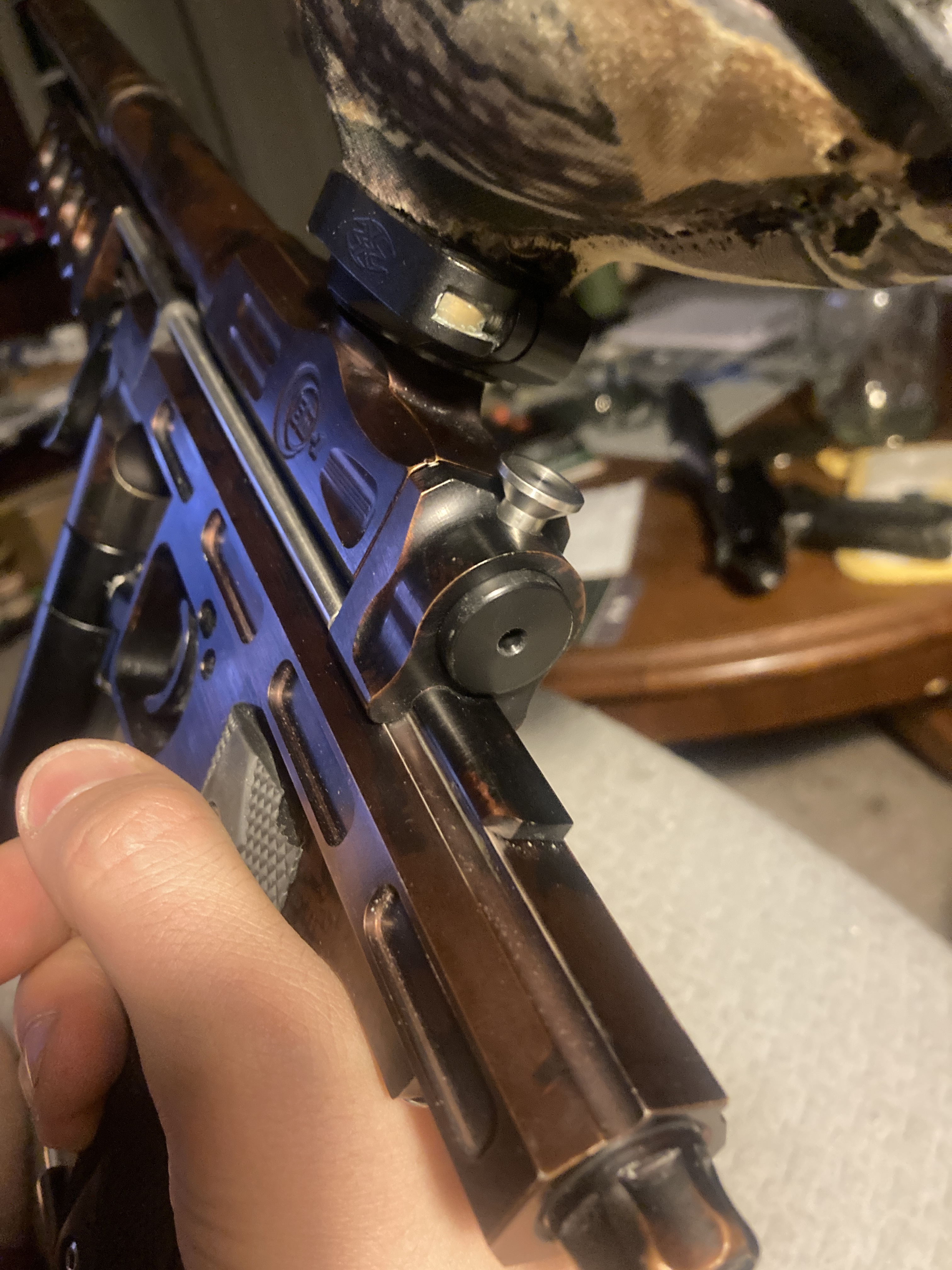

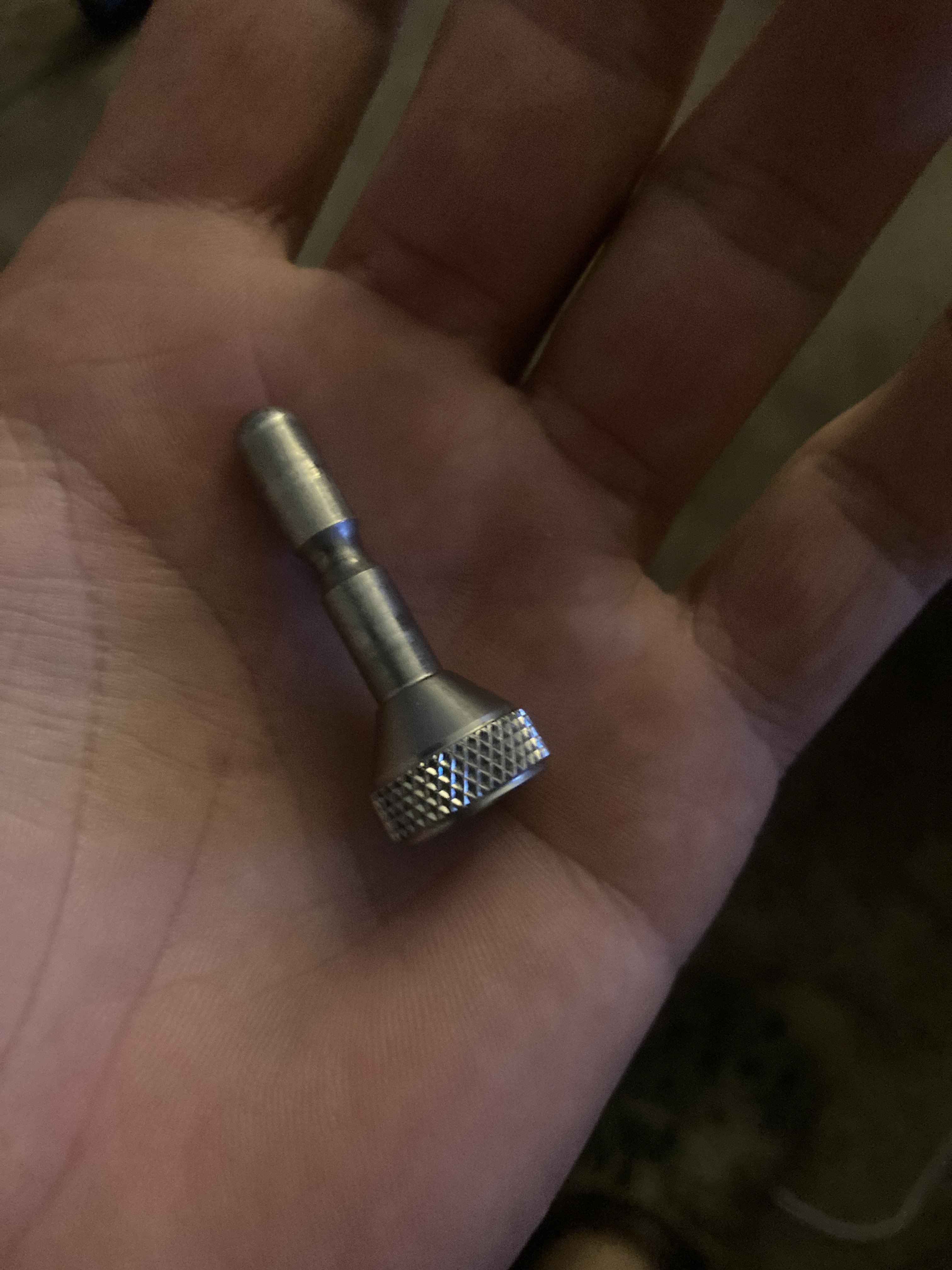

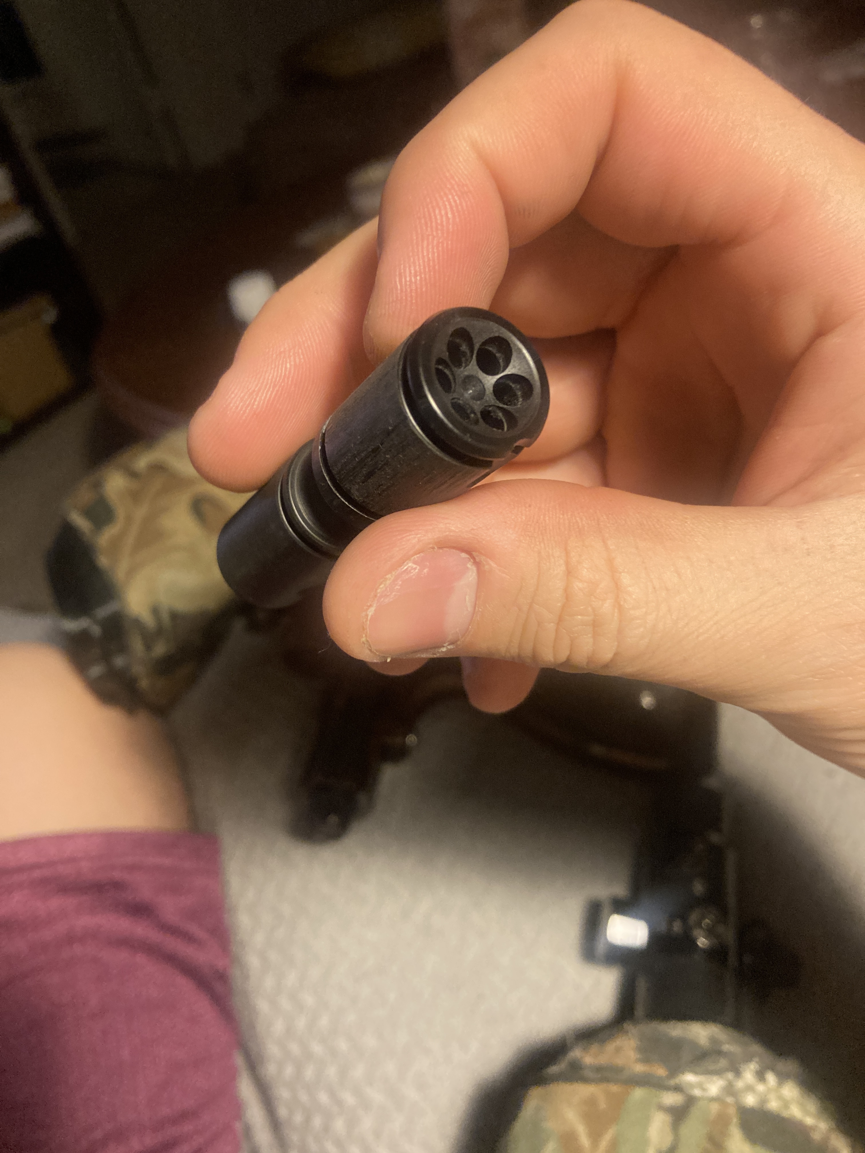

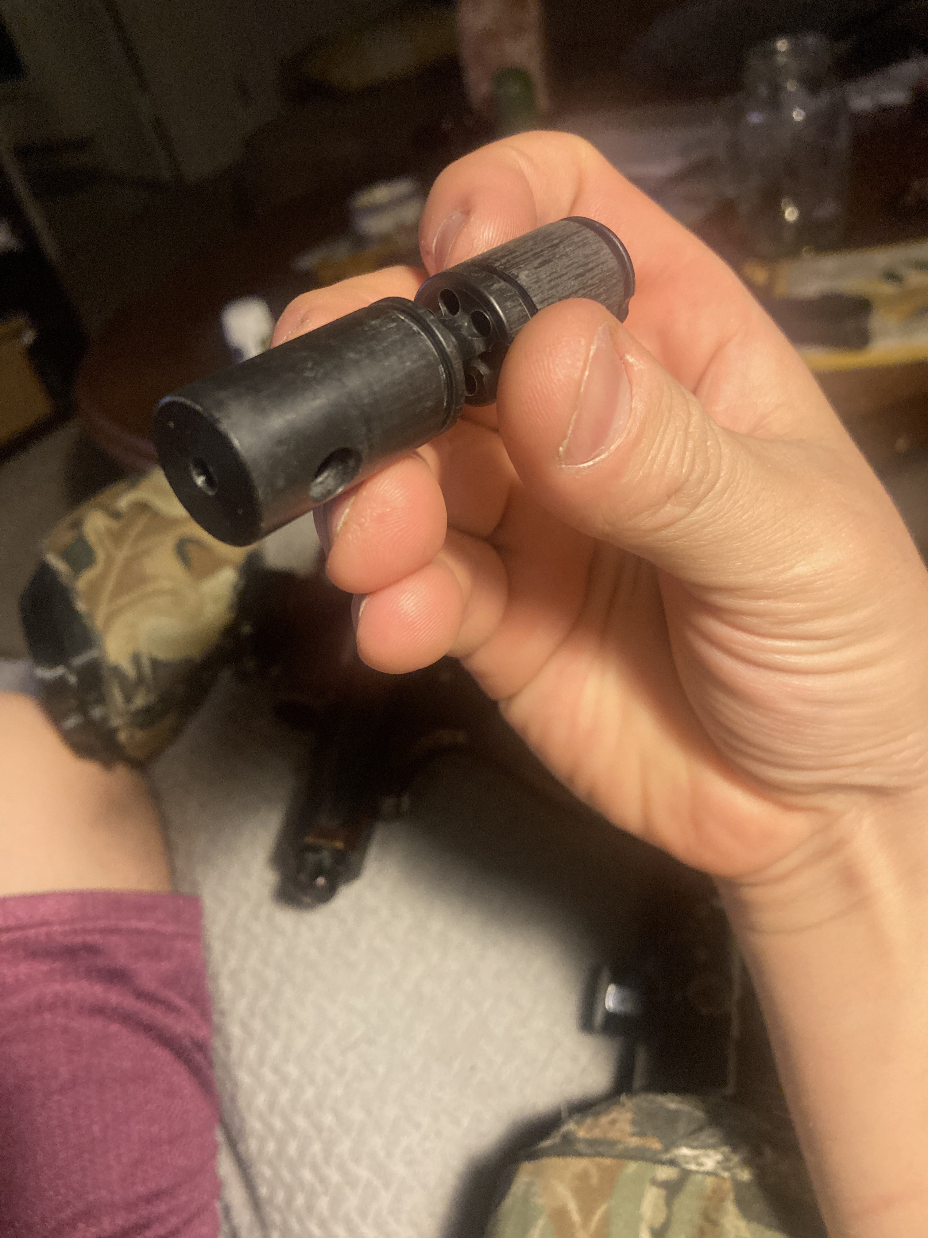

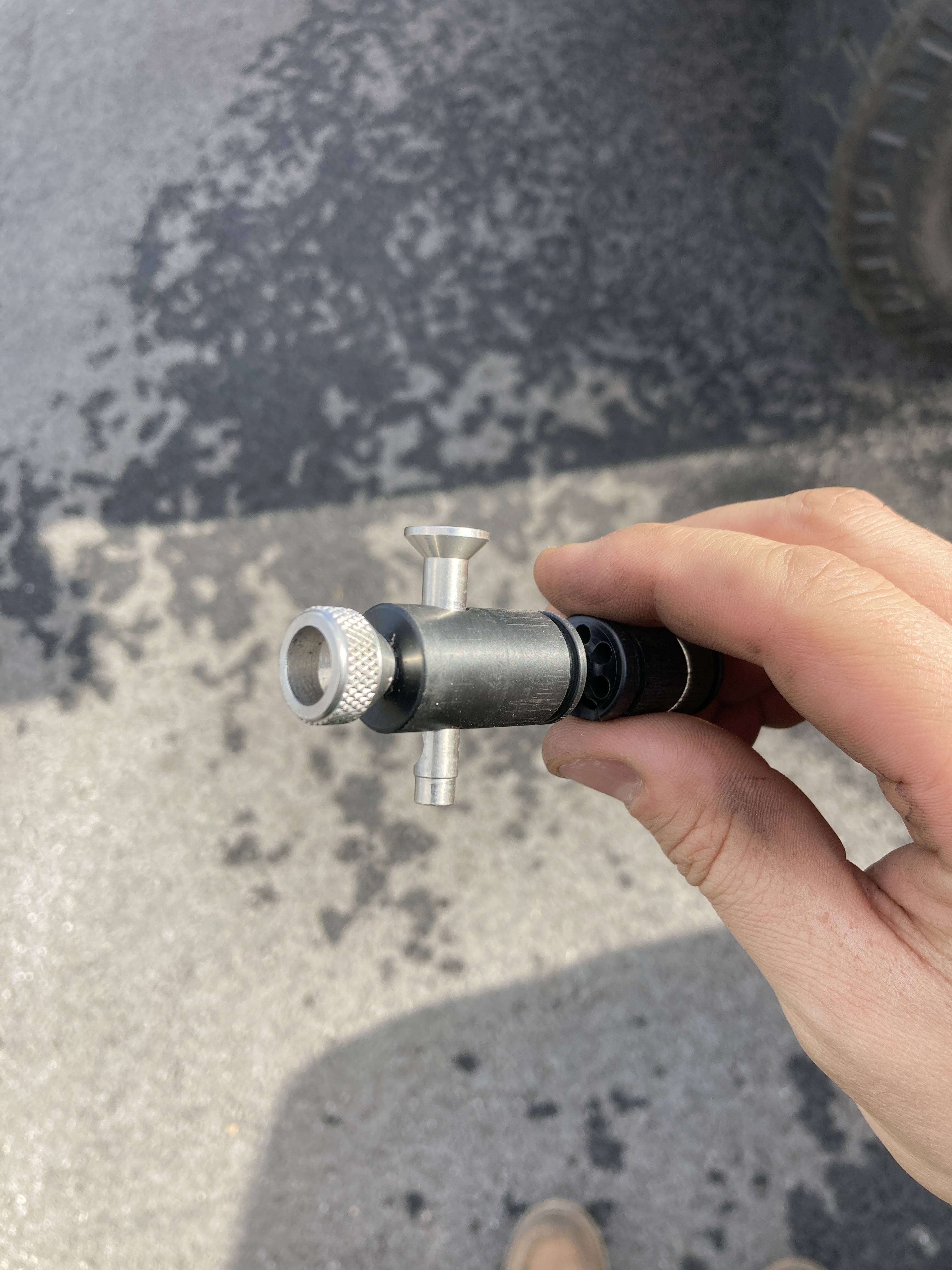

          Ive been using an empire sniper/resurrection bolt for this gun. it works fine, correct length but the sanchez sled is not slotted for the "captive" pin style bolts like these ones. to remove the bolt, i have to pull the pin completely out and try not to let the spring and bearing go shooting out. putting the pin back in is an even bigger pain, having to juggle keeping the ball bearing and spring pushed in far enough with a tiny allen key to get the pin started then slip the allen key out while keeping everything lined up to pop back into place.
          not at all a feasible process if i need to pull the bolt mid-game.
          A CCM T2 techT bolt popped up on Ebay so i nabbed it for testing. CCM bolt pins are held in by an oring inside the bolt and I figured id try it out.
          The TechT bolts have nice, cupped and rounded 6 hole faces with the middle of the bolt cut into an hourglass profile. Havent seen this before, but the T2 bolt has an angled groove for the middle oring, supposedly to minimize friction and the Orings rolling around. Mine was still too tight for smooth operation so I removed the 3 bolt orings like i did with my empire bolt.
          The CCM style pin retention system works perfectly and as an added bonus, the TechT bolt gave me a few more FPS and a significantly quieter shot!
          My final bolt related hurdle was removing the bolt once the pin is pulled. The empire style bolts actually sit in past the end of the sled and the TechT only hangs out the back about a 1/8".
          I dug around in my parts bin and found an old Trilogy pin to cut down and thread into the back of the bolt.
          While im not a big fan of bolt pins that stick out much from the side of marker, i love the way this one looks coming out of the back of it! No more pinching and slipping trying to pull the bolt out and now The Dirty Sanchez has 2 pump rods, 2 triggers AND 2 bolt pins! (insert "dropping a deuce" joke here)
